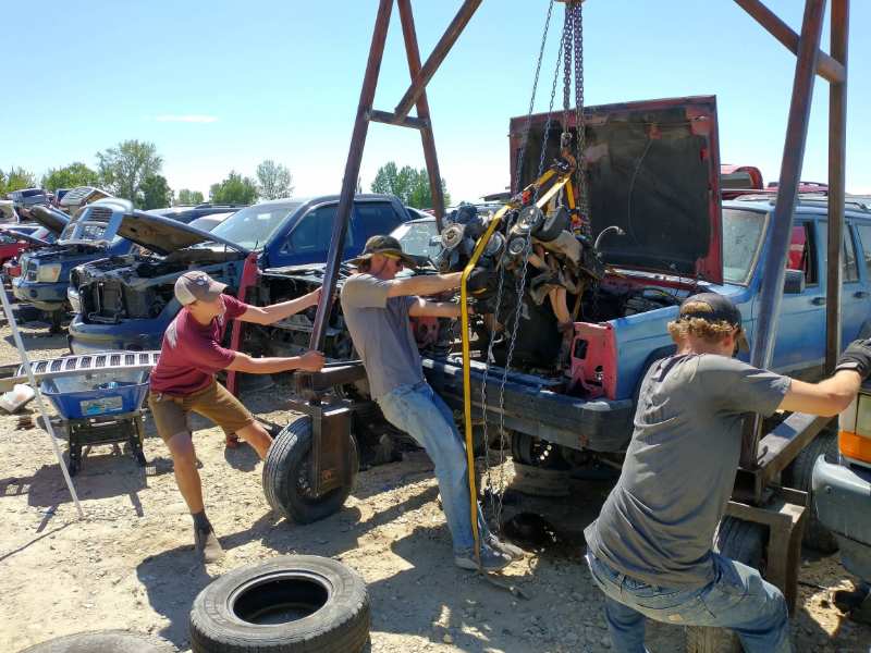

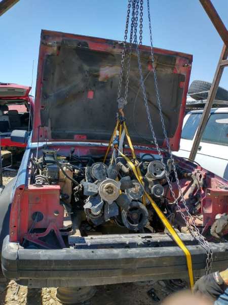

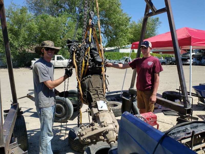

JZLAJeep Posted July 28, 2025 Posted July 28, 2025 Only done this once in a junk yard back in 2022. We pulled the engine with the transmission attached to get the AX-15 transmission out. At the time it made sense to use for some reason to pull the whole drive train rather than lay in the dirt trying to get the transmission out. We left nearly everything attached, but I do see that the front clip, radiator, etc. was removed already. I've attached a few pictures from that day.
