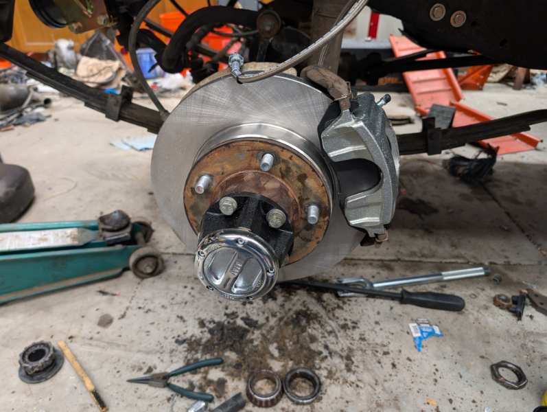

derf Posted April 19 Author Posted April 19 The upper was definitely loose. Torque spec on it is 100 ft-lbs. But the driver side is back together. I'm going to hook up the new brake line after I flush the old system.

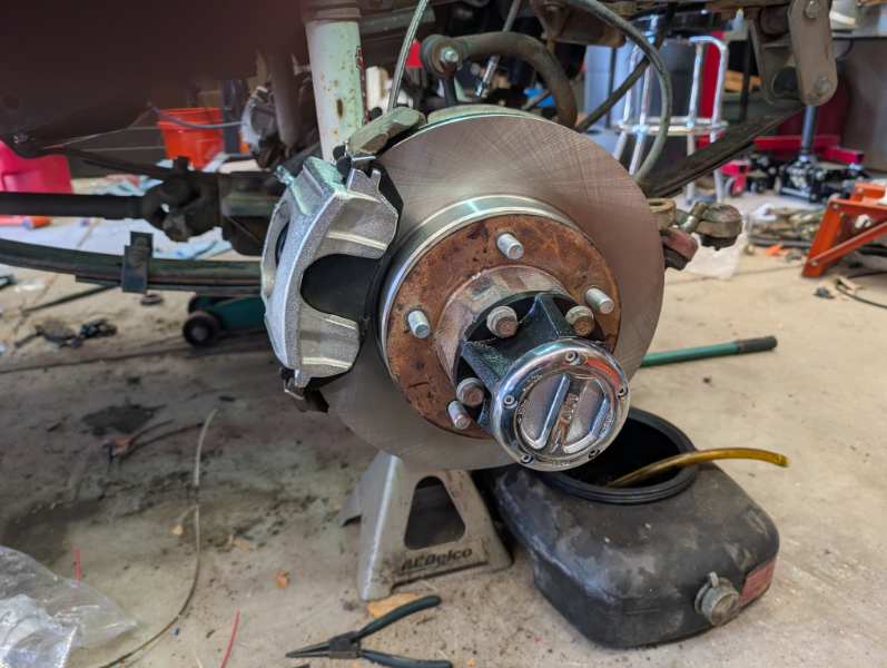

derf Posted April 19 Author Posted April 19 Passenger side done. Hubs are a greasy mess but at least they're back together.
