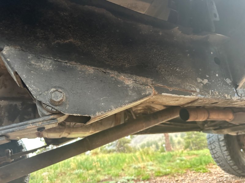

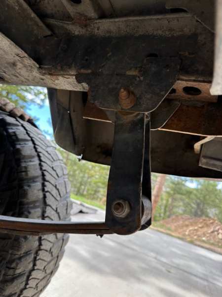

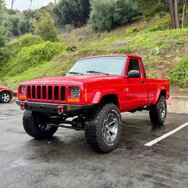

Ricky8227 Posted May 3, 2025 Share Posted May 3, 2025 Alright decided to just cut off the factory leaf hangers that the previous owner cut and moved back, and I’m going to just weld them back in the original position. I am ordering general springs stock Comanche leafs and will be running those. And I will be ordering a new custom length driveshaft as well. What shackles should I run? Link to comment Share on other sites More sharing options...

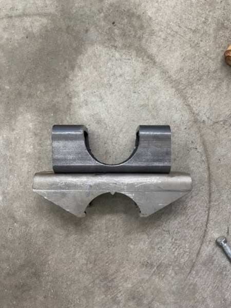

boxyjeep Posted May 4, 2025 Share Posted May 4, 2025 I'm running 4WD leafs in a “low” SOA setup. I’m using XJ shackles, removed the overload leaf, and made my own low -profile spring perches. Sits around 6.5” lift. Link to comment Share on other sites More sharing options...
Ricky8227 Posted May 5, 2025 Author Share Posted May 5, 2025 4 hours ago, boxyjeep said: I'm running 4WD leafs in a “low” SOA setup. I’m using XJ shackles, removed the overload leaf, and made my own low -profile spring perches. Sits around 6.5” lift. Looks great! When you say 4wd leafs, are you saying the factory mj 4wd drive leafs? Not GS springs? Link to comment Share on other sites More sharing options...
