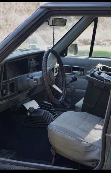

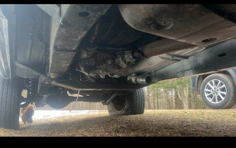

87MJTIM Posted May 1, 2025 Share Posted May 1, 2025 Is that a YJ tcase shifter? Does the tcase appear to be clocked up high? The exhaust pipe seems to end at the tcase, then the tail pipe hangs over the rear axle. Kinda strange. Link to comment Share on other sites More sharing options...

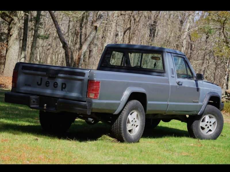

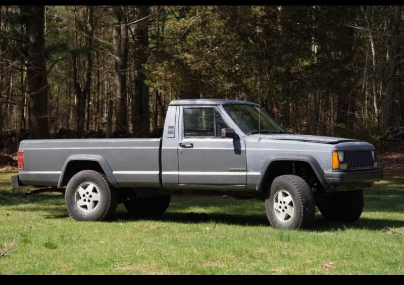

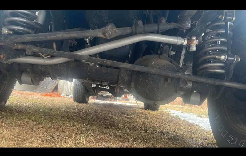

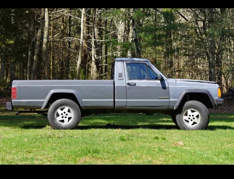

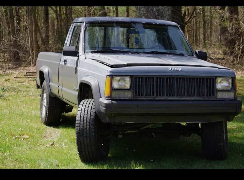

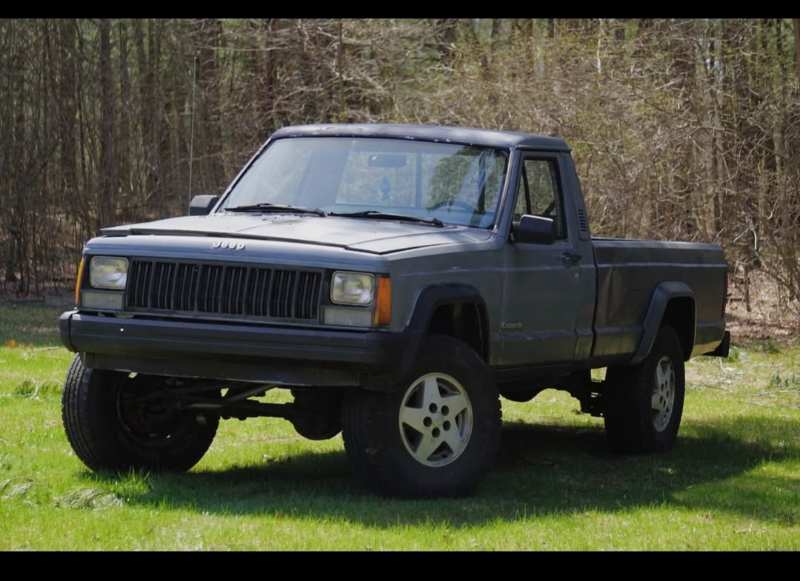

89 MJ Posted May 1, 2025 Share Posted May 1, 2025 I'll start by saying that the the body looks pretty decent. I'm not sure what's up with the primer though. You should try to get an answer on that. That MJ most definitely has a YJ AX-15, like Tim said. The transfer case is clocked differently and the shifters are not MJ/XJ units. Looks like you might have some front end work to do if you get it. Looks like the tires are cupping pretty bad on the inside edges. I'm also seeing front lift springs and an add a leaf in the rear with a new track bar and sway bar end links, so maybe the suspension issues are already fixed. I'm also very curious as to what is up with the spots I have arrows pointed to. The one pointed to the floor looks like a poor repair, but its hard to say. Those plates on both sides should not be there. Definitely check to see if rust is under there. I'm also seeing another spot right at the top of the picture along the "frame". I'm also curious as to why the passenger side floor is silver when nothing else is. With all of that said, if it is a running and driving rig without rust or very minimal rust, I would say its a fair deal. Not a great deal, but a fair one. Link to comment Share on other sites More sharing options...

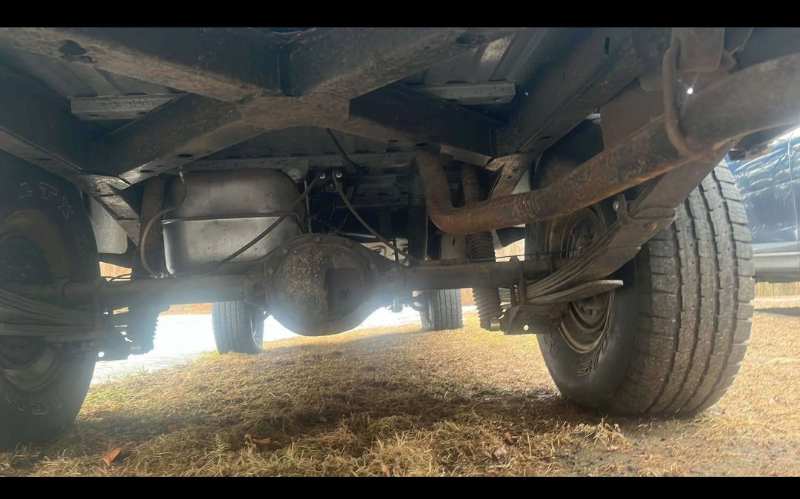

pizzaman09 Posted May 1, 2025 Share Posted May 1, 2025 The rear axle appears to be mounted farther forward in the wheel well than it should be. As stated, if it runs well and drives fine, it's a decent deal. I'd say it's a 4x4 conversion from 2x4 because there are no factory 4x4 badges and the front suspension has quite a few new looking parts. Nothing wrong with that, a 4x4 conversion is simple on these trucks as there are no chassis differences between a 4x4 and a 2x4. Link to comment Share on other sites More sharing options...
87MJTIM Posted May 1, 2025 Share Posted May 1, 2025 48 minutes ago, pizzaman09 said: I'd say it's a 4x4 conversion from 2x4.... pizzaman09 is correct; most likely a 4x4 conversion with parts from a YJ. I looked at the transmission shifter again. It is a YJ gear selector - longer and more vertical (either that,or it's happy to see you). Link to comment Share on other sites More sharing options...
