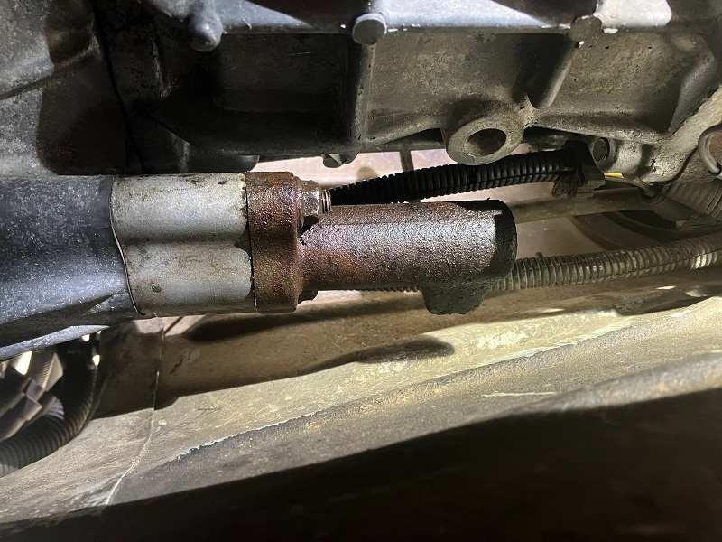

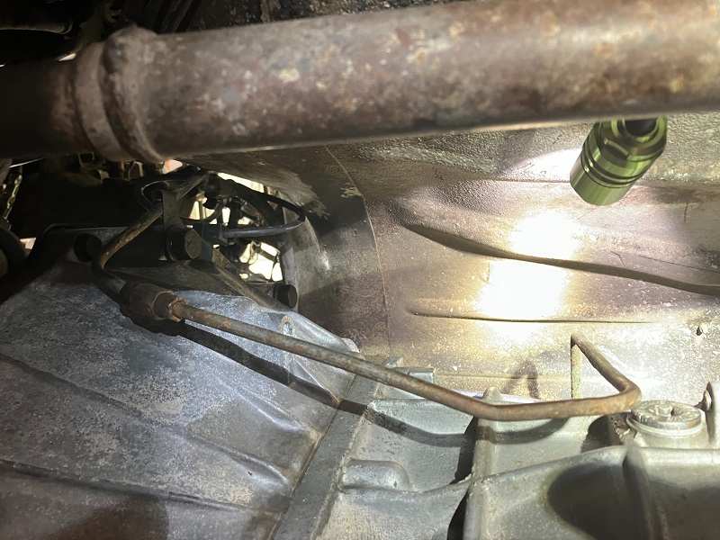

White_Comanche Posted June 1, 2025 Author Posted June 1, 2025 @eaglescout526 Initially, I had plans only to replace my clutch cylinder. But I know there's a leak somewhere, because I need to top off the reservoir every once in a while. Later this summer I plan to replace my entire clutch hydraulic system (clutch master, slave cylinder & the hydraulic line that connects the two). Got under the vehicle today and got a visual on everything. Think I should be able to tackle this. I own an official M.R. 277 manual for this 1986. I'm curious of what the manual says is the correct way of bleeding. Quote from the book is below: BLEEDING PROCEDURE • (raise vehicle and fill reservoir) • Remove the slave cylinder from the clutch cover housing and remove the push rod • Compress the slave cylinder plunger using tool J-24420-A or equivalent • (after this do the standard half-filled bottle bleeding procedure) Do I need to have the slave removed and somehow compressed to properly bleed the system... or can I have the part installed beforehand?
eaglescout526 Posted June 1, 2025 Posted June 1, 2025 1 minute ago, White_Comanche said: Do I need to have the slave removed and somehow compressed to properly bleed the system... or can I have the part installed beforehand? You can bleed it the traditional way. It’s tough to open the bleeder from the slave with the trans in position but I found it’s easy if you remove the crossmember and lower the trans and bleed it that way. But still doable the traditional way. Now I never really studied the procedure and I’m sure it works really really well with the tool but I don’t own the tool so I can’t say.
White_Comanche Posted June 1, 2025 Author Posted June 1, 2025 Yes, found out there's not much working room. A bit awkward really. A 10mm box end fits over that valve. I thought about getting something like this to help bleed the system. It's a brake bleeder wrench with a tube attached. There's a few styles of these around. Both with internal and external check valves. They create a positive seal apparently. A wrench like this could work in that tight space. I'm thinking of buying a NOS Mopar slave to keep things OEM. When looking at that bleeder valve it seems like it's just a threaded fitting. Is it simply loosening up the fitting until fluid begins to flow? I may ask about lowering the transmission in the future. I haven't done something like that before.

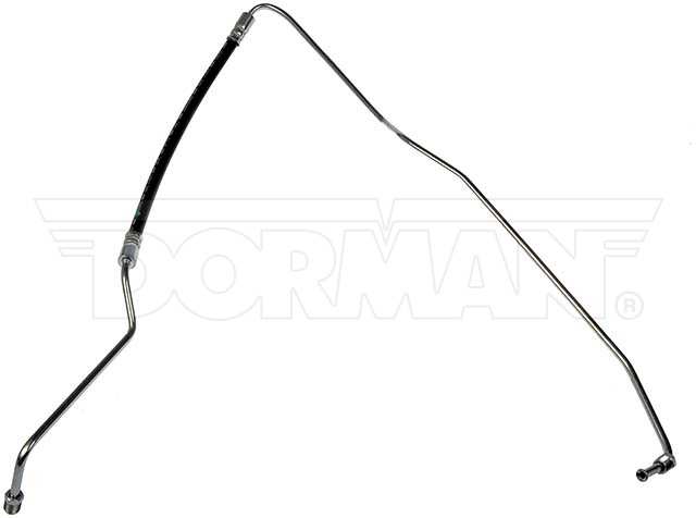

White_Comanche Posted June 26, 2025 Author Posted June 26, 2025 On 12/21/2024 at 6:58 PM, eaglescout526 said: Hopefully you get it off. If not there’s still a line out there that’s made. Getting a little closer to replacing all the parts of my clutch hydraulic system. However, I still need to purchase both the slave and the line. Would this be the correct hydraulic line/hose to use on my 1986 2.5L? The two Mopar numbers (52000069 & 53004247) forward to this part. If correct will this line match up with my supposed factory line? Or will a tubing bender likely be needed? (links at the bottom) https://www.rockauto.com/en/moreinfo.php?pk=2888325&cc=0&pt=2332&jsn=502 https://www.dormanproducts.com/p-48395-h38270.aspx?origin=keyword
