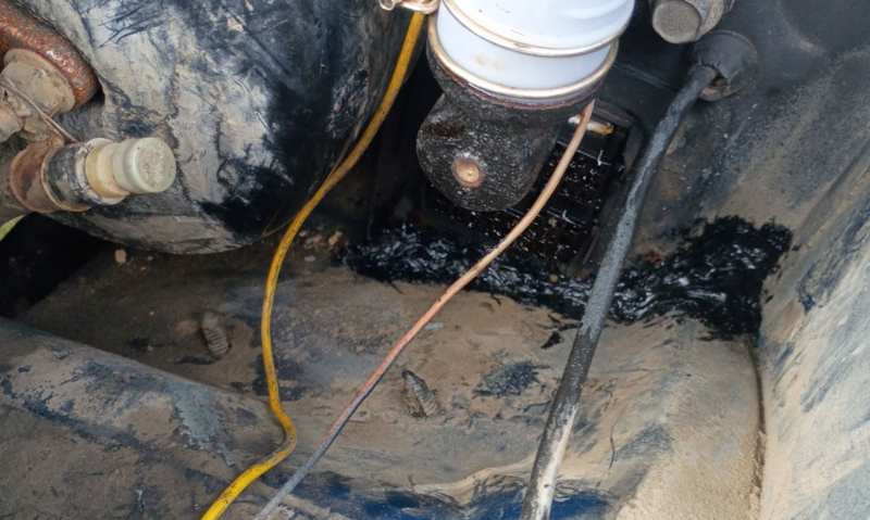

Awesome Posted August 15, 2023 Author Posted August 15, 2023 More progress. I got the truck titled last month. No hiccups other than they didn't believe me that it was a scrap truck that I got running and they charged me taxes based on "market value" - which they figured at $1200. Daughter got some more coaching/practice for the new shooting team she's been invited to join. Tonight she finally used the right tool to get the seat belt bolts undone and we pulled the seat out. She was trying to use an allen tool instead of a torx tool. The hardware is actually in really good condition. Maybe I oughta get the seat recovered. The floor on this side doesn't look as bad as I expected. See all the moisture? It hasn't rained here in over a month, and hasn't seen moisture since I picked it up in early June.
Pete M Posted August 15, 2023 Posted August 15, 2023 that moisture could be from the last decade. I just wrapped up the leaks in the truck I'm helping fix up and there were a bunch.
Awesome Posted August 15, 2023 Author Posted August 15, 2023 Is that behind the heater blower area under the glove box?
Awesome Posted August 15, 2023 Author Posted August 15, 2023 Update; the floors are out. Passenger side. Driver's side. I've never had to fix floor rot like this before. Time to order some floor pans. The passenger side doesn't look that bad, but it is rotted through when looking from underneath. I'm guessing the hole is under that floor support.
Pete M Posted August 16, 2023 Posted August 16, 2023 23 hours ago, Awesome said: Is that behind the heater blower area under the glove box? yes, that's the pass side firewall. had to pull the dash and hvac to get at it all.
