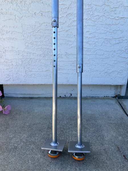

fiatslug87 Posted May 2, 2025 Author Share Posted May 2, 2025 Drilled a series of 5/16” holes, one inch apart, in the sleeping platform support poles to receive locking quick release pins and added adjustable feet for fine adjustment. Originally they had hose clamps but they would always move when load was applied. Link to comment Share on other sites More sharing options...

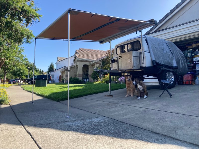

fiatslug87 Posted June 17, 2025 Author Share Posted June 17, 2025 One thing missing from our setup is shade over the cooking area so I got an ARB 8’ x 8’ awning. To mount it I attached 1 1/2” zinc plated perforated tubing to both sides of the bed front (spaced out with some flat bar to clear the bed lip) that 1 1/4” perforated tubing will slide into. Slots had to be cut in the backs of the 1 1/4” tubing to clear the bolt heads holding the 1 1/2” tubing, nutserts were added for threaded knobs to keep things in place, height adjustment and storage. At the top of the 1 1/4” tubing I attached Ironman 4x4 awing quick connects to make installing/ removing of the awning easy. The plan is to carry the awning on the FJ Cruiser’s roof rack and assemble at the campsite. The propane box had to be moved forward about 1 1/4” so the opened lid could clear the 1 1/2” tubing which then required a hitch extension for the FJ Cruiser’s rear door to fully open without hitting the box. I used my 20 ton press with a 2” ballbearing to pinch the extender and hitch together at the hitch pin hole so it wouldn’t rattle. Link to comment Share on other sites More sharing options...

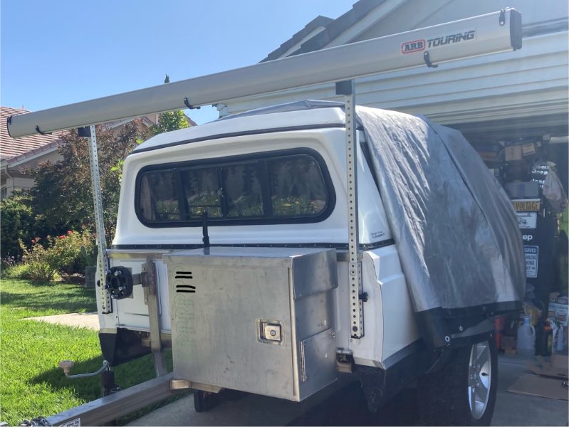

fiatslug87 Posted July 1, 2025 Author Share Posted July 1, 2025 Change of plan, instead of carrying the awning on the FJ I decided to keep it on the trailer. It only weighs 43lbs but it’s long and takes a little back and forth to get it into position on the FJ. All I had to do was attach a modified dual hitch extender to the hitch end plate (using existing holes ) and use the supports that are used for the front with a few modifications. Now it’s very easy to load/unload, we’ll see how stable it is and modify from there. Link to comment Share on other sites More sharing options...

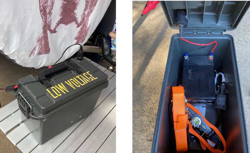

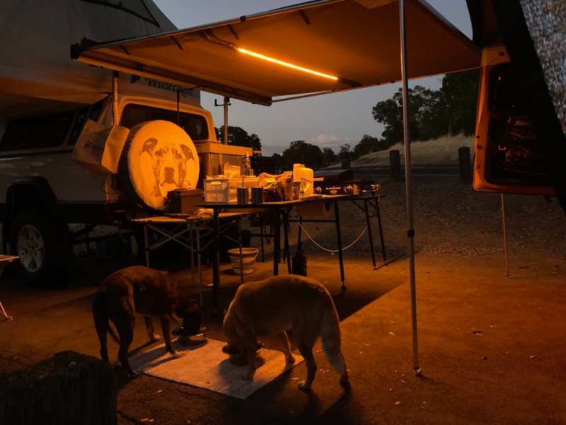

fiatslug87 Posted August 31, 2025 Author Share Posted August 31, 2025 Went camping last week to try out the new gear, it's great going during the week after schools start, no one else in the campground. Storage of the awning on the side worked really well, no vibrations and very sturdy. The awning has an integrated LED strip that can be white, amber (reduced insect attraction), or both. It requires a 12v power supply so I got a small AGM battery, put it into a Harbor Freight plastic 50mm ammo box and added a 12v cigarette lighter adapter, hardly drained the battery at all over the entire week. Link to comment Share on other sites More sharing options...
