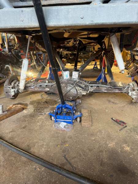

colthrax Posted March 9, 2025 Author Share Posted March 9, 2025 Rear axle arrived, been lazy and have not gotten much done. Link to comment Share on other sites More sharing options...

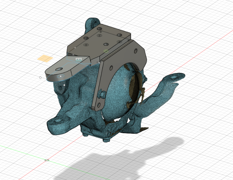

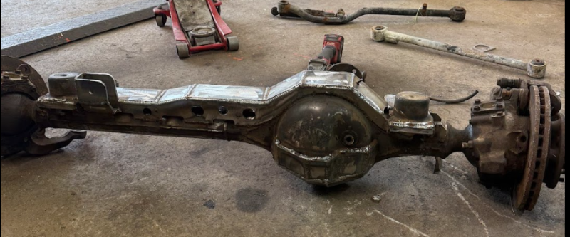

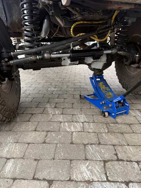

colthrax Posted May 12, 2025 Author Share Posted May 12, 2025 Started putting the front axle on the car, today I tried to mount the tie rod thing, it hits the control arms with patrols dumb location of it Need to make some kind of high steer, 3d printing it before cutting this time. Link to comment Share on other sites More sharing options...
colthrax Posted May 13, 2025 Author Share Posted May 13, 2025 I hope this will be enough Link to comment Share on other sites More sharing options...

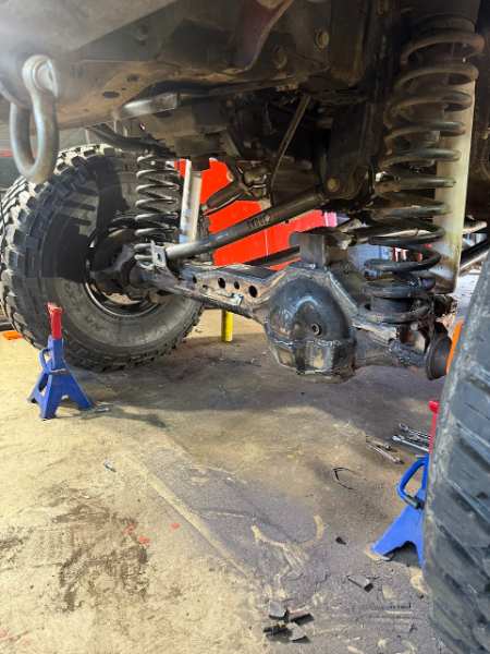

colthrax Posted May 22, 2025 Author Share Posted May 22, 2025 Finally the axles are on the car, I hope I will have it running this saturday Link to comment Share on other sites More sharing options...

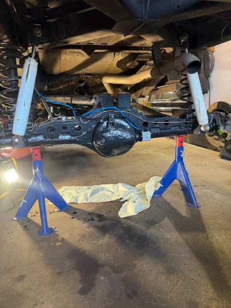

colthrax Posted June 18, 2025 Author Share Posted June 18, 2025 Axles are mounted, airlocker is installed in the front axle and rear one is converted to air. Just got to make some protection for the rear one Link to comment Share on other sites More sharing options...

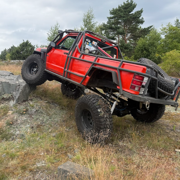

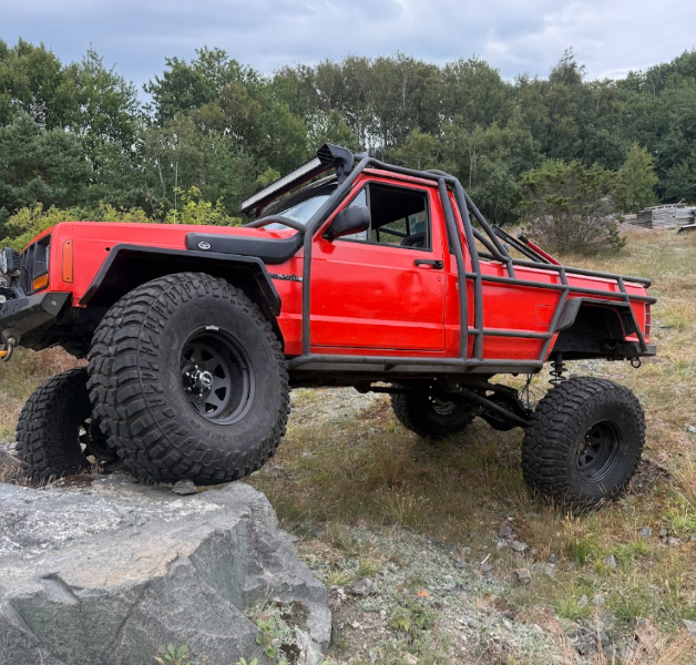

colthrax Posted July 11, 2025 Author Share Posted July 11, 2025 I had welded my old rims to fit the new bolt pattern, but at around 110–120 km/h, the car started to wobble a bit. Today, I went to check out some new rims and a set of 38.5" Super Swampers. When I got there, the guy had a set of 40" Cooper tires already mounted on the rims. He wasn’t planning to sell them—but I managed to convince him. So now I'm rolling on 40s! 😄 My old rims and new ones, got to weld beadlocks on them but as sweden offroad tour is starting tomorrow I do not have time. Link to comment Share on other sites More sharing options...

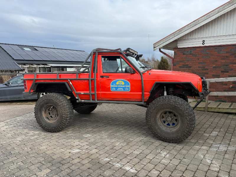

colthrax Posted July 12, 2025 Author Share Posted July 12, 2025 Had to extend my front fenders, but still got alot of trimming left to do. Will join in on sweden offroad tour 3 days late Link to comment Share on other sites More sharing options...

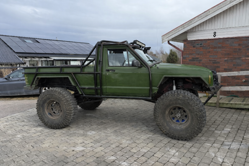

colthrax Posted February 5 Author Share Posted February 5 This weekend my project on moving the rear axle forwards abit so I get the same wheelbase as a shortbed will start. also bought a new steering hydro assist thing, found the part from a tractor. Link to comment Share on other sites More sharing options...

colthrax Posted February 7 Author Share Posted February 7 And here we go… I should have done this from the start instead of just cutting the rear of the bed. I’m moving the rear axle forward by 17.5 cm to match a shortbed wheelbase. When I cut the bed, it ended up with shortbed dimensions, so now I also need to move the wheel opening forward and fill in the section behind it. Link to comment Share on other sites More sharing options...
