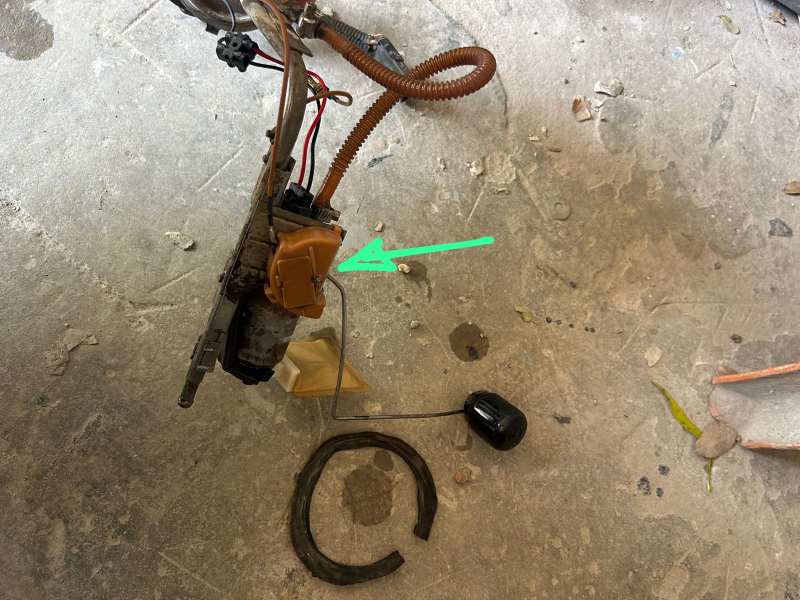

MagicJames Posted April 16 Share Posted April 16 On my 2.5, I replaced the pump and the wiring from a YJ. Everything was plugged exactly the same. But would anyone know if you can buy the orange box I'm pointing at that indicates the fuel level separately? The tiny wires inside are snapped. If anyone knows a replacement, please let me know. Ty Link to comment Share on other sites More sharing options...

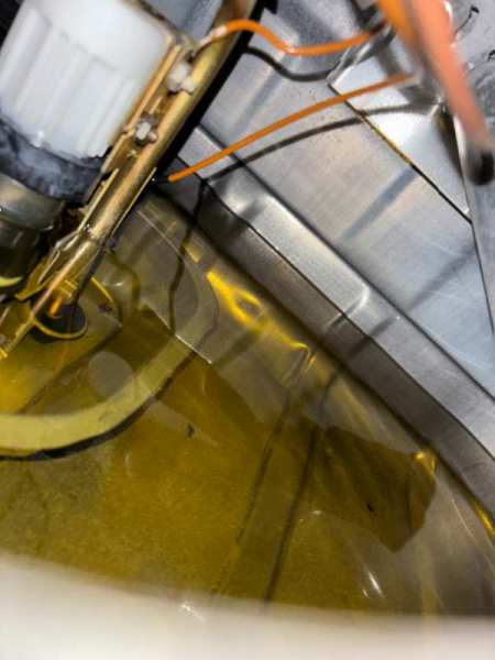

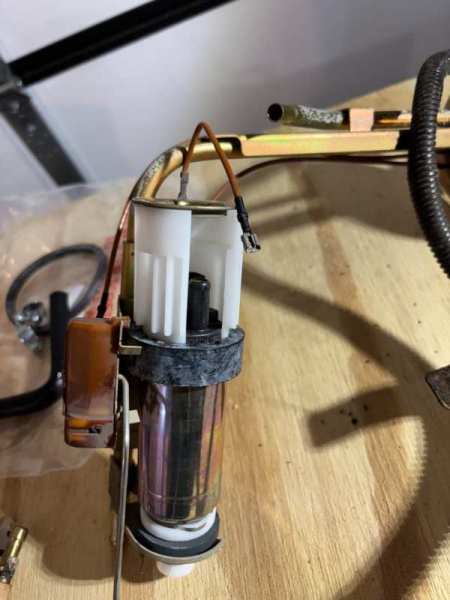

JYau Posted May 5 Share Posted May 5 I was able to replace my fuel pump and motor and that seemed to have fixed my original issue of the engine loosing power when it had warmed up. I used the replacement part Bosch 69302. It was not a direct replacement and required a little improvising to get the pump to fit nicely into the assembly but it can be done. I was able to get the fuel assembly out of the tank without damaging it. I had used some penetrating oil and took my time using a brass punch. I did not need to drop the tank, I was able to do everything that I needed while under the truck. Getting the entire fuel assembly back in was difficult, it requires lining up the fuel line nipple with a rubber grommet fixed on the inside of the tank. I tried for an hour by using touch and feel to get the alignment right but I couldn't get it. I then did the best I could to sneak my phone in front of the fuel assembly and get a picture of inside the tank, only then was I able to get the assembly lined up correctly. Link to comment Share on other sites More sharing options...
