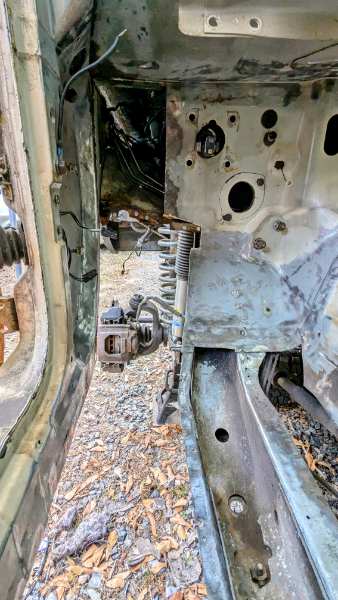

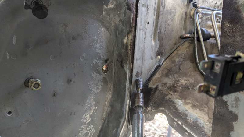

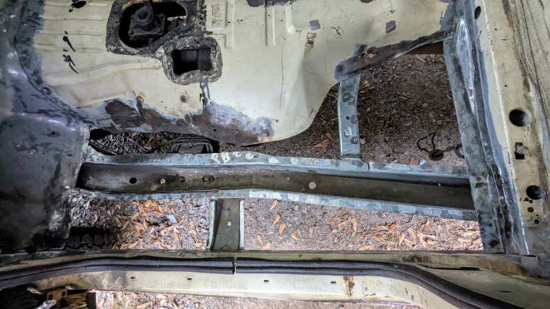

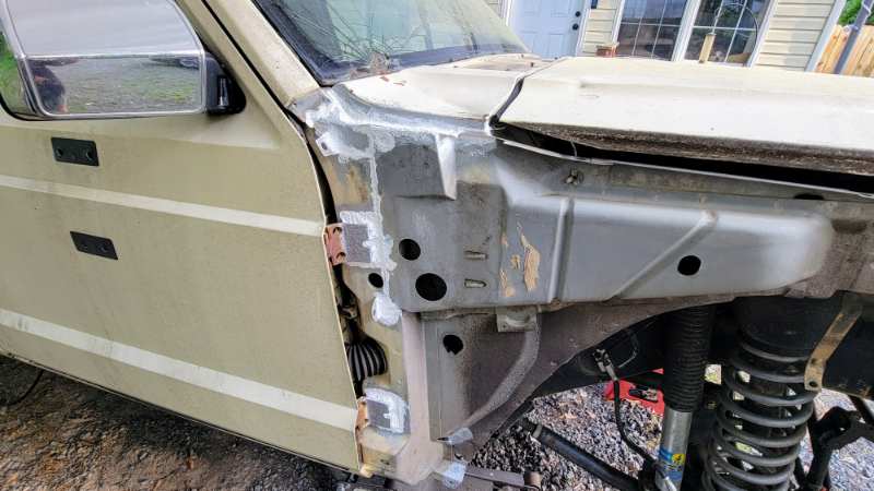

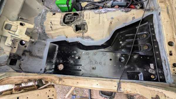

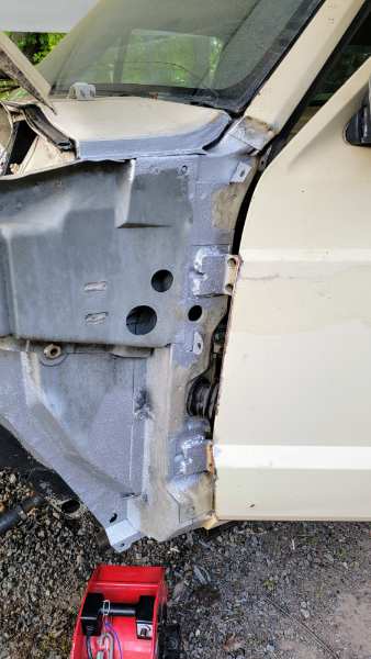

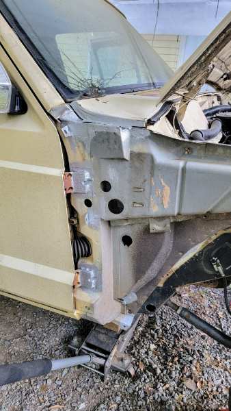

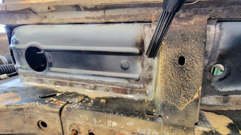

Well, I guess I spoke too soon and put my foot in my mouth. All that heinous seam sealer was hiding rot.
Went searching for firewall patch stuff to see how others did it and stumbled on this thread from earlier in the year. This made me want to remove every bit of seam sealer and check every crevice for rust. I really only want to do this once.
Good thing I did. There's rot up to the cowl on the drivers and rust is starting on the passengers. I poked a bore scope into the cowl and looks like there's no rust up there so I'll spray a good bit of the Eastwood internal stuff into the cowl and it should prevent it in the future. In addition, there's a rust hole underneath the heater core inlet, a hole in the bottom corner of the pass firewall and a big patch of rot under the fuse block bulkhead. The firewall also has a sizeable crack next to the clutch master mount holes. Not sure if I want to just weld over that or patch it. I think I may just weld it since I'll be going auto with the 3.4 swap.
Would really like to have a nice discussion with the person responsible for deciding this truck need this much seam sealer.

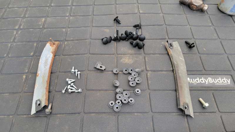

I did manage to get both braces off the drivers side and the inside of the frame looks great. Yay for small victories.

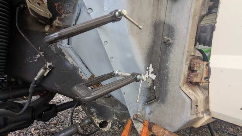

Using the Blair spot weld cutter and these things like to skip around a lot. I was wedging the cold chisel in between panels and when the cutter got deep enough it usually gives a little pop.
Unfortunately, I didn't realize I only had one of the cutter bits. It got me through the drivers side braces, the small one on the pass, and about half the big pass brace before losing all the teeth. So, here's where we wait for a bit.

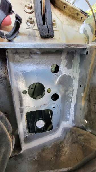

The patch over the slave cylinder access hole was glued in place with dicor.
This one baffles me. youd have to drive the truck around with no carpet or a hole in that spot with a trap door to keep the heat and road noise out. Plus taking out the seats and interior when it only takes 15 min to lower a crossmember haha.
Should be an easy patch though. Dont forget to grab your neighbors broken washer or dryer for cheap floor panels.
Seems like it is common for those spot weld cutters to loose teeth. Harbor freight sells spot weld cutters. They have worked well for me.
https://www.harborfreight.com/38-in-double-sided-rotary-spot-weld-cutter-63657.html
Yeah, I've been cutting with them dry and that's probably not helping. I may get some cutting fluid from work and see if that helps. I got a pack of 3 of the blades on eBay for $12 with 2 day shipping so that should more than get me through this job.
This week I spent my little spare time tearing down the steering columns I have to make one good one. Now I have a freshly cleaned and greased tilt steering column to go back in the truck. Also, removed the shift interlock so I don't have to worry about that. I'll also gain intermittent wipers with this swap.

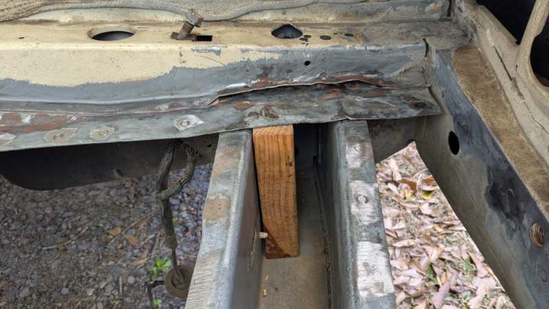

Last night I got the pass side 99% cut out. Will need to drop in the new pan and mark where to trim on the tunnel. Gonna devote all of tomorrow to that and getting the drivers side out.

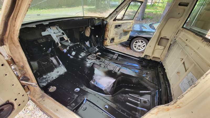

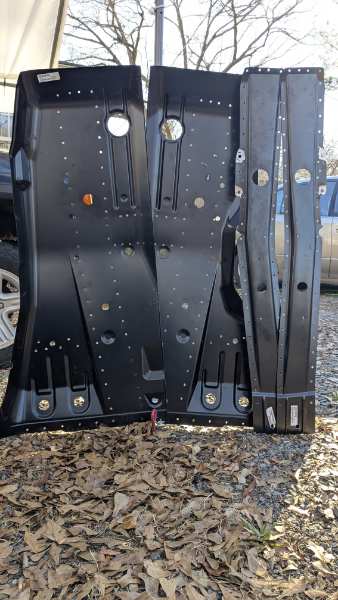

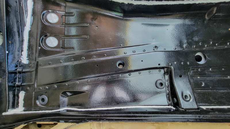

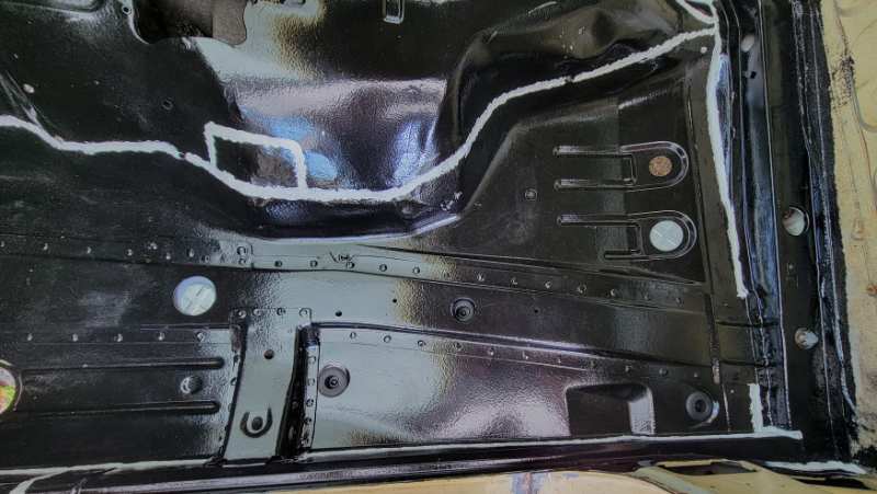

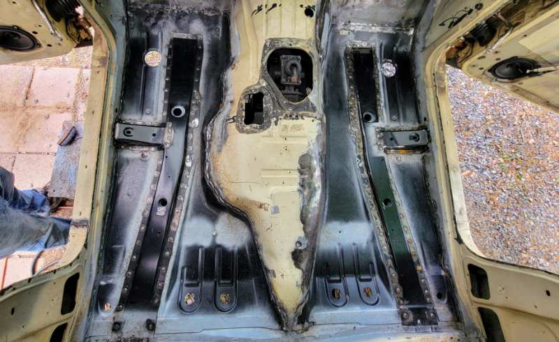

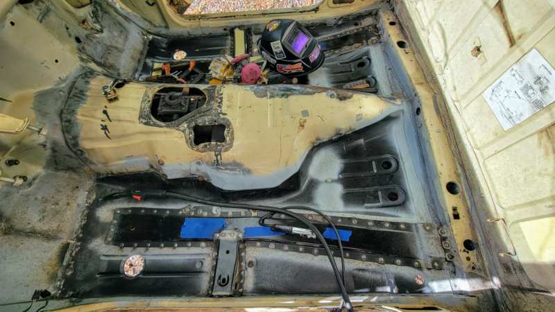

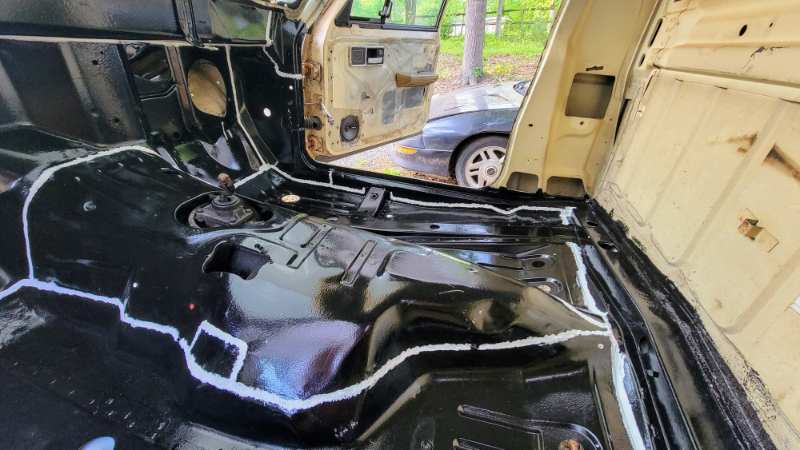

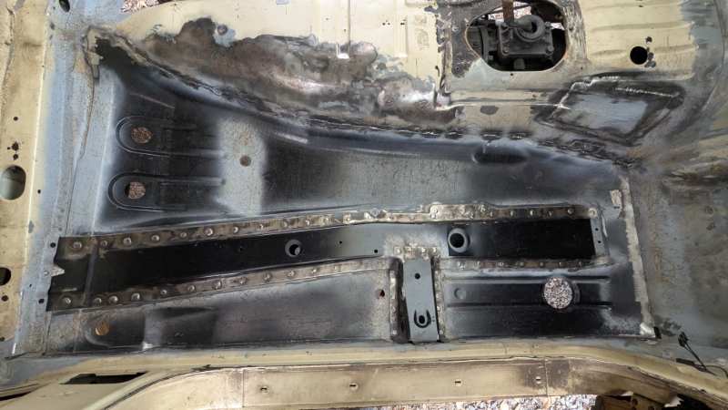

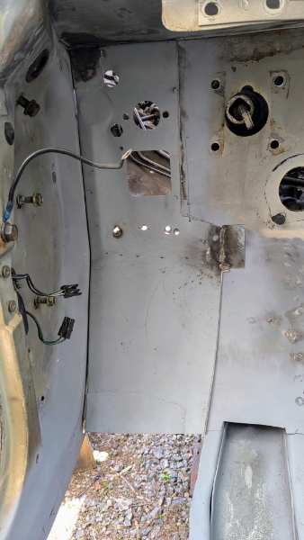

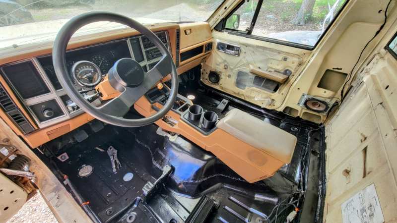

Man, time can really get away from you. Going on 6 months for a floor replacement.... I'll just let the pictures do the talking

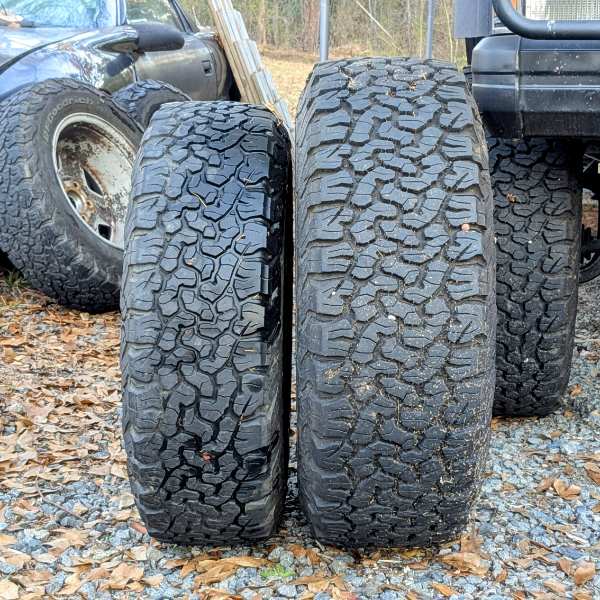

Still have the section of the tunnel right above the tcase on the drivers side to weld up then paint and put the interior back in. I also managed to score a nice set of XJ Icons so I can run a skinnier 32 at some point. Stock size tires are so tiny

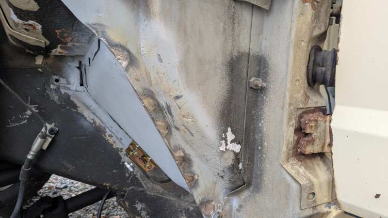

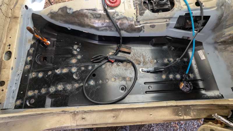

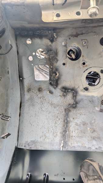

Finished all the welds up. Used a compact needle scaler I bought from harbor freight and hopefully peened some stress out of the welds to avoid issues in the future since it was all gasless fluxcore and I know there's slag left in some of those welds lol. Thinned out a pint of POR15 and brushed it over all the seams. I know it seeped through the way I hoped it would because when I used the needle scaler on the underside of the truck a good bit of excess came out. 4 coats of POR15 on the interior. Needle scaled underneath the truck and hopefully tomorrow afternoon and Friday I can put down some coats of the Mastercoat I got for the bottom and use the internal frame coating on all the unseen stuff.
Should've bought myself a needle scaler years ago. This is so much less work than a wire wheel.
This matercoat stuff is no joke. Let some dry on my arm and can't get it off no matter what I try.

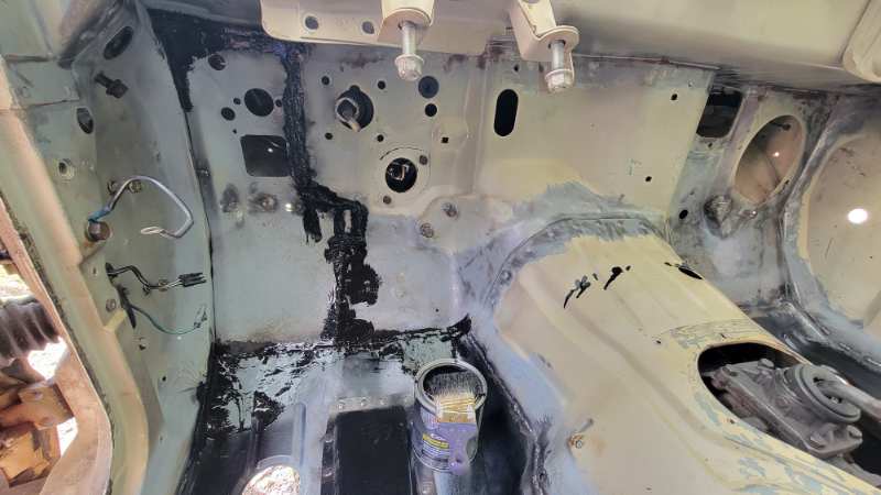

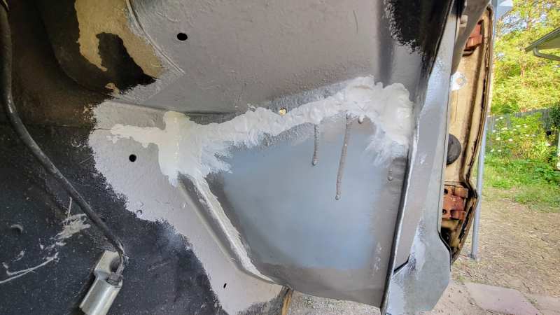

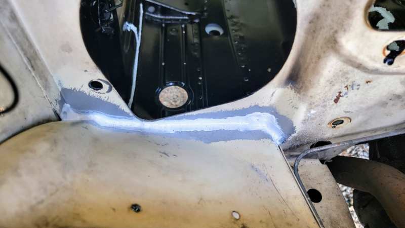

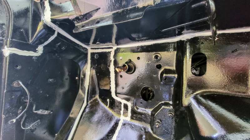

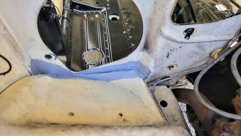

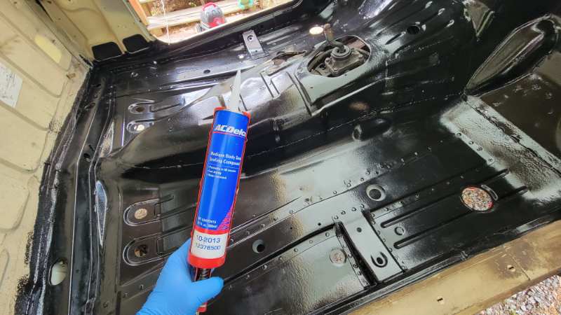

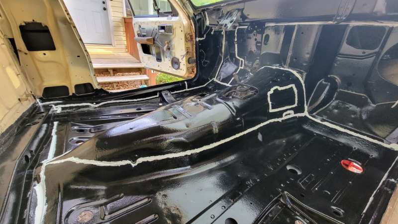

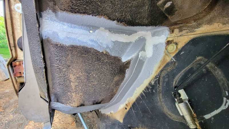

Not the prettiest seal job, but a sight better than what AMC put on the truck. Got the AC Delco sealer for a good price. Hopefully it won't shrink too much, but I applied it pretty liberally. Still gotta seal underneath.

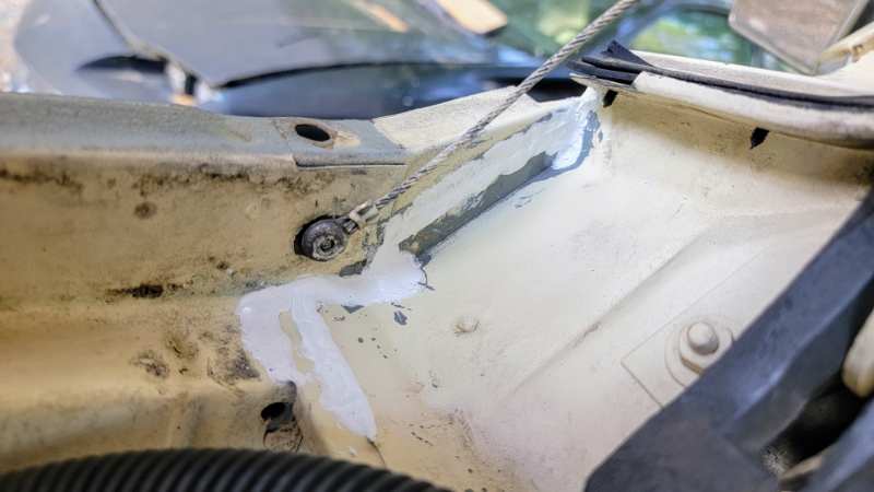

2 hours ago, coheed said:
Looks great!

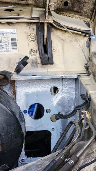

I would go further inboard with the seller on the firewall. I just had a leak there last week. I had sealed it before but did not go far enough with the sealer.
9 hours ago, Eagle_SX4 said:
Looks great!
That's a good tip. I was going by where the sealer was originally, but we all know these trucks weren't sealed the best. How much further in did you go? Or should you have gone?
I went about 3 inches past the hinges. You could go the entire length of the firewall just to be safe. As long as you hood to cowl seal is in good shape that isn't necessary.
It's not in the greatest condition but it's not falling apart like some other trucks are. I'll reexamine that area when I go to seal the rest of it. Thanks for letting me know.

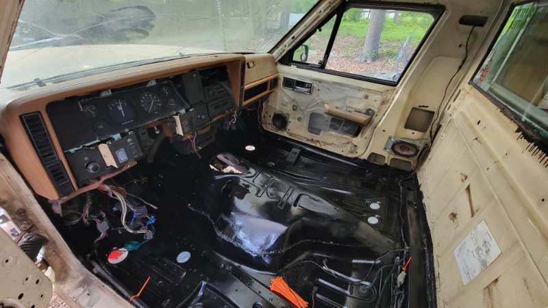

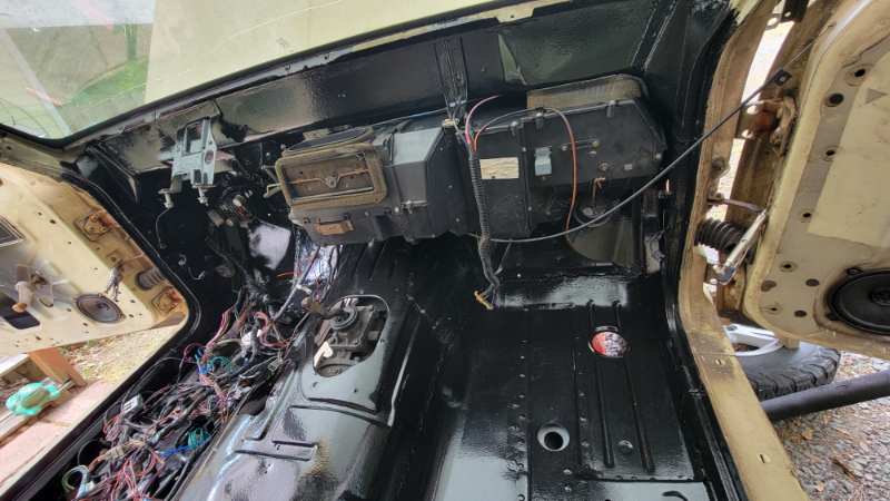

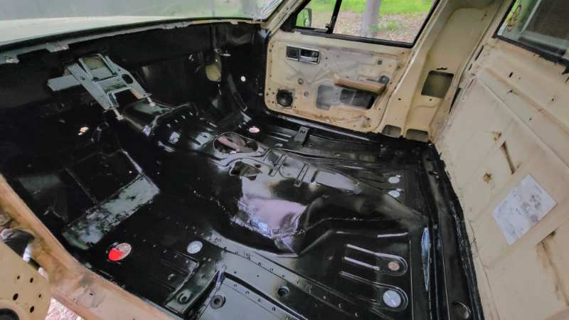

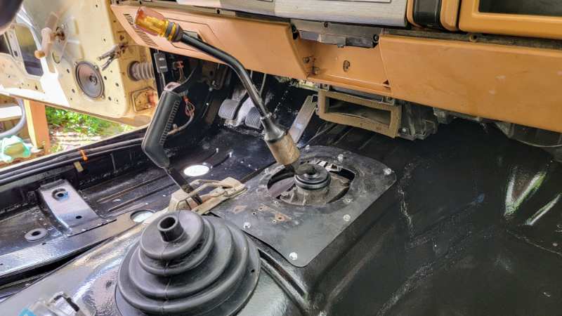

Miscounted plugs for the floor, oops. Quick coat of POR15 over the sealer so the floor looks uniform until I get some carpet. Got the underside sealed up today and I'll wait for the rain to hold off in the next couple days and I'll do a quick coat underneath as well. Put one thick coat on the roof. Hoping that and the new SMS headliner will cut down on some noise and radiant heat in the cab. Put a coat on the seat mounts as well and they're hanging in the cab to cure out of the rain.

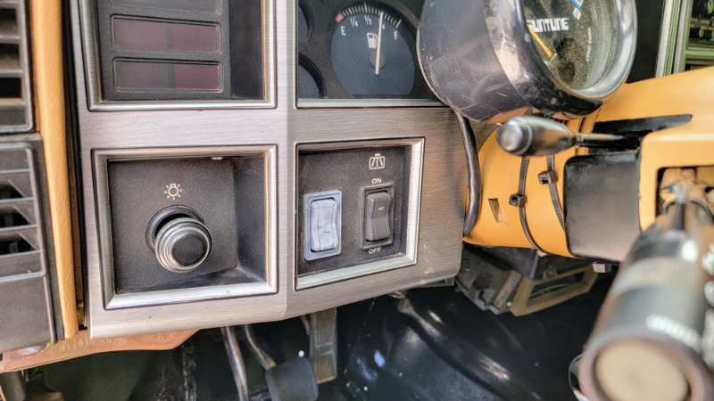

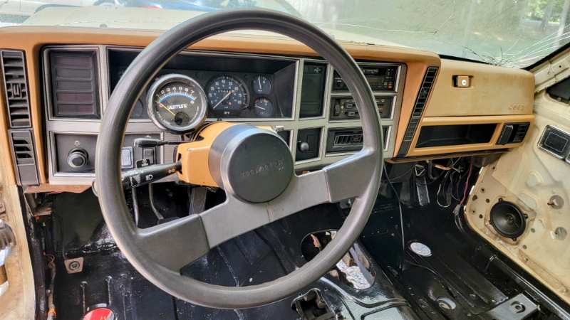

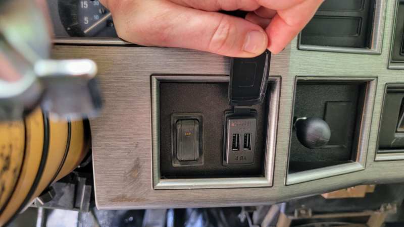

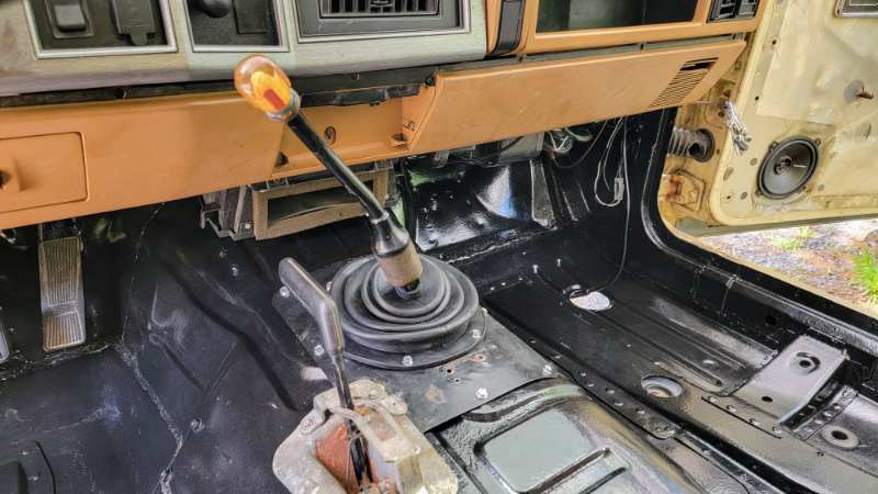

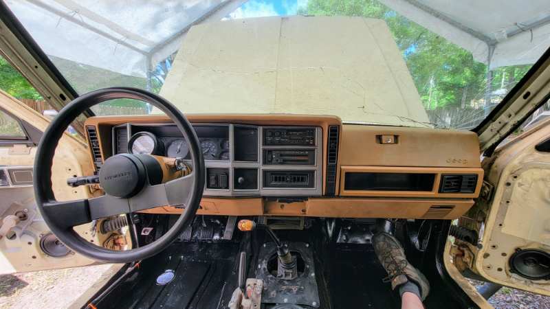

Got the dash buttoned up aside from radio antenna. Added a blue sea systems dual USB 12v source for charging. Swapped the fog light switch with one for an XJ back wiper, that way I can supply constant power on one throw and use the momentary throw to flash the fog lights instead of trying to use the high beams.
I decided to go with a mid 80s S10 steering wheel. I've always loved the way they looked and since the splines are lower than center on the wheel,  it will give me a bit more leg room. Much more with the tilt column as well. Also added delay wipers with the "new" column.

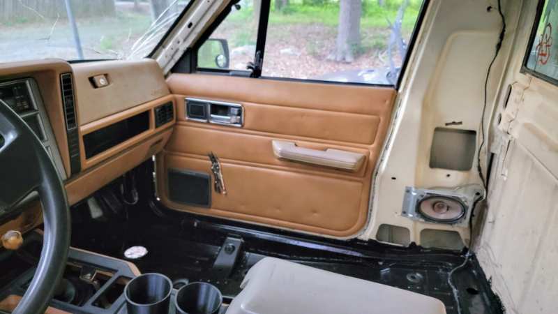

Got the lower dash and wiring done. New shift boots for the tower and in the cab. Got the center console and the driver's seat mounts in. Need to get some hardware to bolt the seats to the brackets. Reinstalled both fenders with new hardware and a little anti-seize and got the header panel and wiring back in for the front end. Feels good to not have it on stands again. Need to get a few things buttoned up and should be getting a new windshield installed this week and the shop will also be swapping in the rear slider I've had laying around for a while.
Really need to get some carpet for this thing.

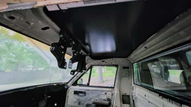

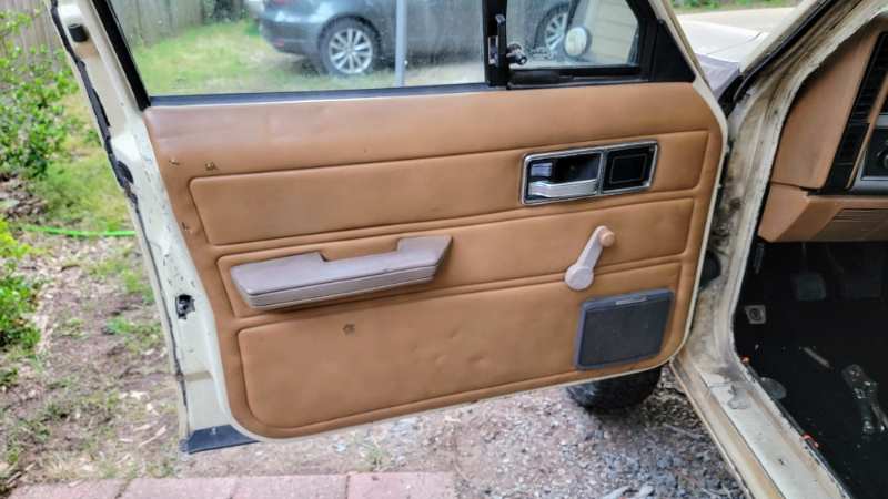

Told myself I was done messing with the truck for the night, but couldn't stop myself from fiddling around. Pulled down my door cards and some of my interior panels so I could clean them off. Ended up putting my door cards on. They're ratty and the PO installed some really large Jensen grills. The window crank hits, but all that said crappy door cards are better than the none I've been running for like 2 years

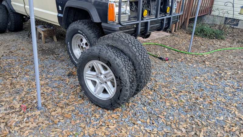

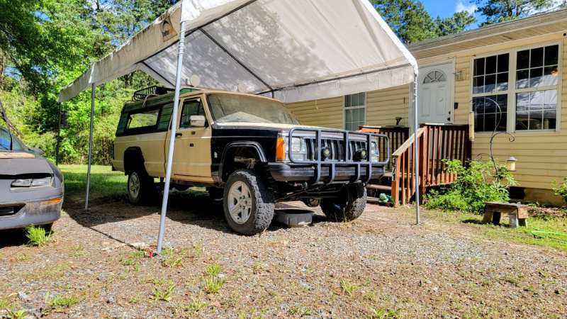

Got driven to work for the first time in forever. Need to get the flares and front liners reinstalled. Don't want crud building up in the freshly cleaned out rockers. These tires are way too tiny :comancheB:

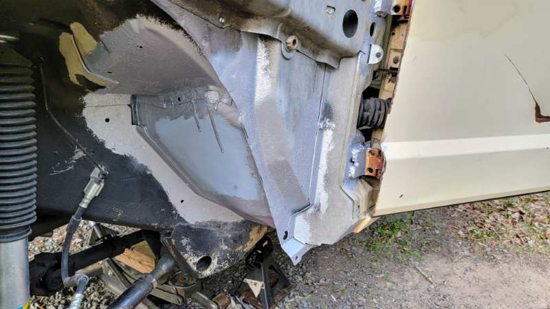

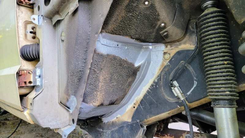

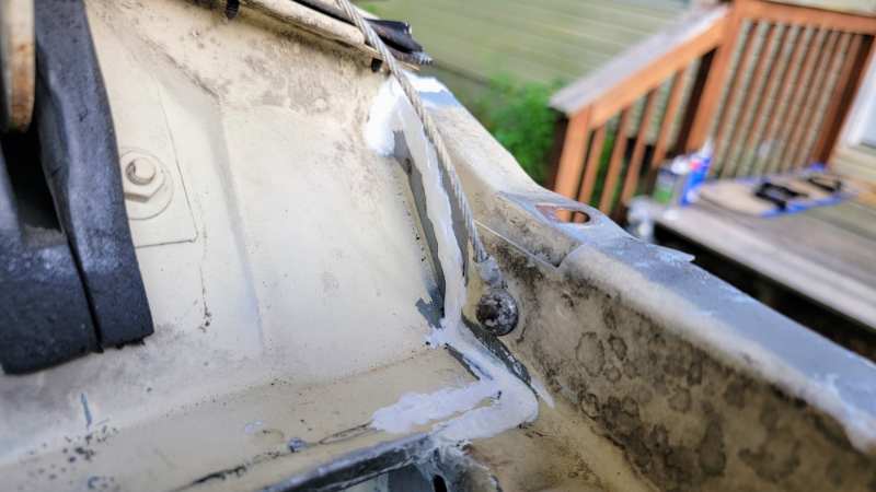

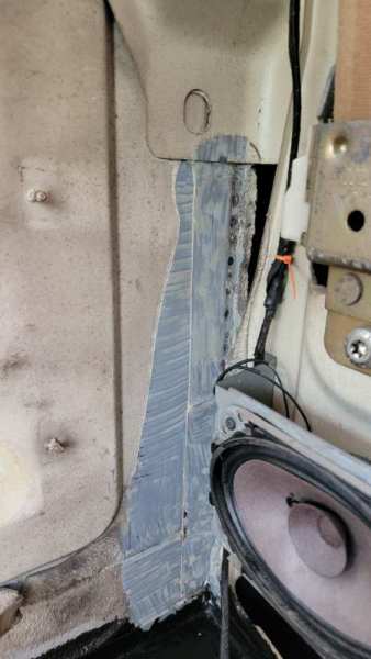

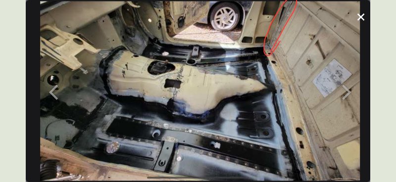

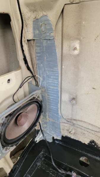

Looking great! One suggestion while you still have things apart, get the seam sealer out of that vertical back cab seam and treat those areas. There is one seam under each lower corner of the back glass. They run from the glass to the floor. The factory’s cheap seam sealer was applied to the inside and sometimes to the outside groove. I’ve deleted that seam and welded it shut on both my MJ’s. They are horrible water trapping spots.
Appreciate the tip. I'll try and scrape it off today and see what mine looks like.
Scraped of the rear cab seams as @ghetdjc320 recommended. Pretty clean compared to the floor and firewall.

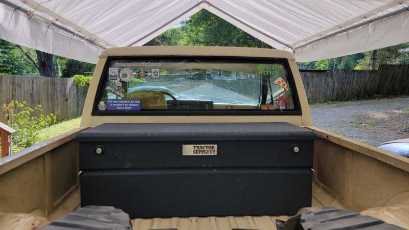

Got a used toolbox to throw my stuff in when the camper isn't on the back.

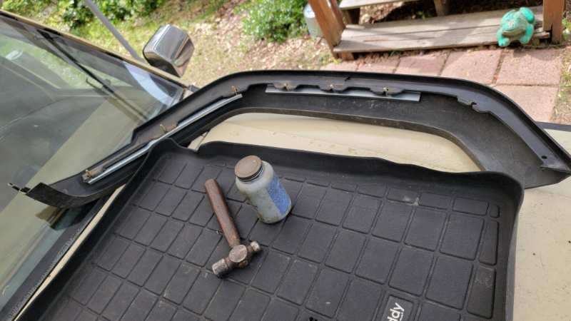

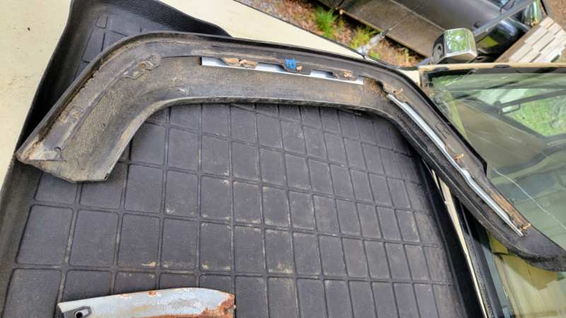

Reinstalled the front flares with new Crown hardware. They weren't the best quality, but got the job done. Since my flares are cut I had to mod the front retainer a bit

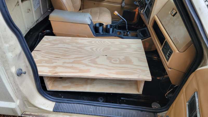

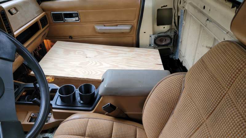

Built a little platform for my dog and it gives me a little storage spot in it.

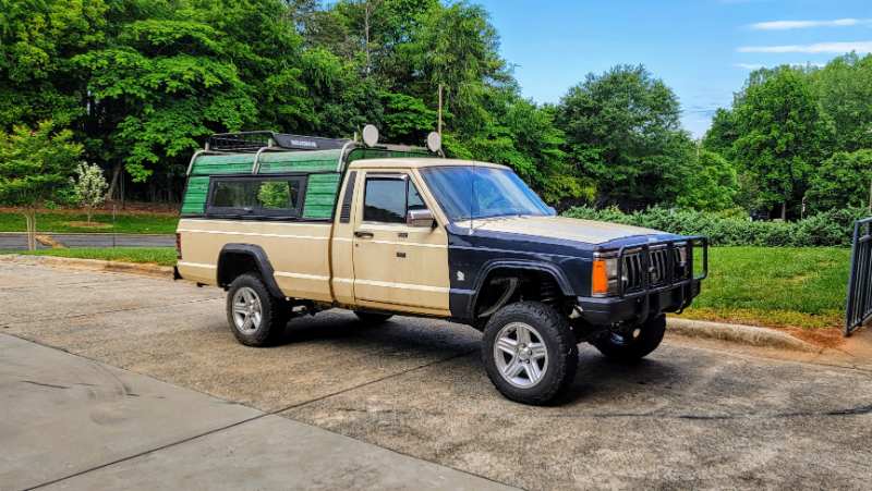

Getting some new tires tomorrow, and a new windshield Tuesday. The shops also gonna swap my back window out for the slider.
