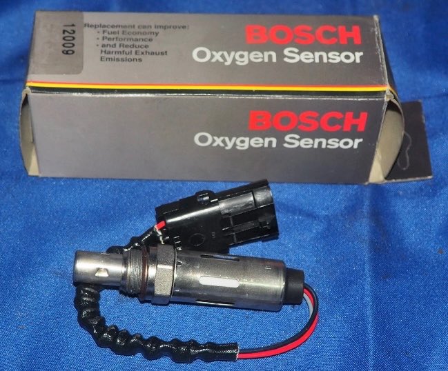

I think the new NTK O2 sensors are junk. The old ones had a ceramic body with three wires coming out into the three pin connector,  the two new ones I purchased both have metal bodies and four wires coming out of the body into the three pin connector. I have the RenixEngineMonitor from Nickintime and both of the new ones pretty much stay at ~2volts when the truck is warmed up and the REM indicates a lean condition and open loop. I pulled an old one out of my other MJ that fluctuates between 0.2-4.8 volts and lean/rich in closed loop as it should, put it into the MJ that had the new sensor and now everything operates normally. I don't know when they changed, all the pictures I see still show a ceramic body.  Anyone else have an issue with them?

I am having issues with my O2 sensors as well.  I had the NTK, also.  After a few weeks/months, the REM show the O2 voltage holding steady at ~2.3 to 2.4.  It wouldn't vary much above or below those amounts.  The REM showed I was constantly in OPEN loop.
I am on a second O2 sensor now - bosch?.  The voltage does move up and down on a wider range, but it is still stuck in Open loop.
Does anyone have one that is more reliable?  Not C.R.A.P.
