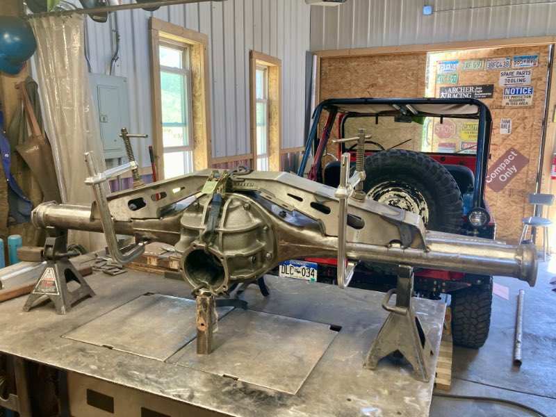

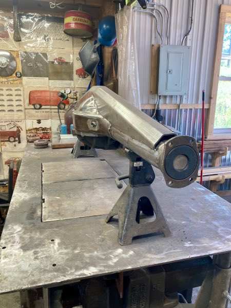

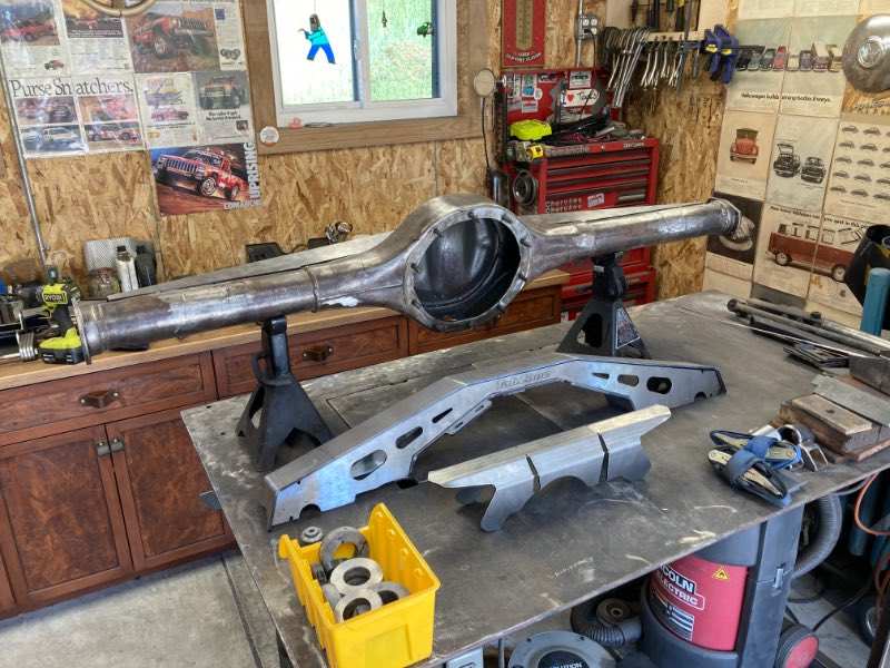

Mazen dropped his axle housing off with me when we were rearranging parts at my shop. We turned around the front axle fairly quickly being he did an awesome job getting the inner C’s where they belong. The 9” was going to be a bit more of a project.

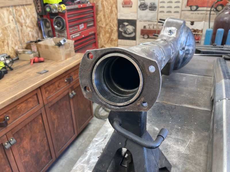

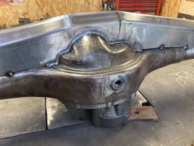

The housing was VERY clean which was nice to start with. This kit Mazen purchased is nicely cut and fits great! I did need to get the outer bearing races out which put up a little fight.

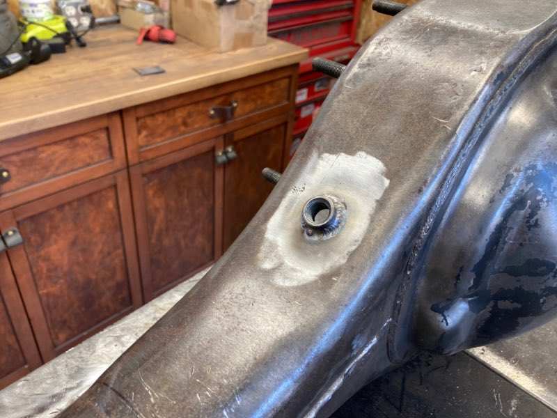

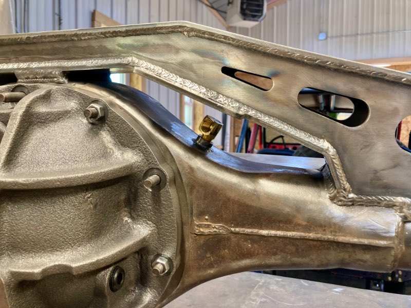

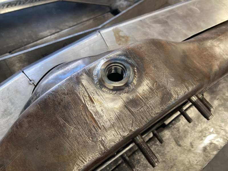

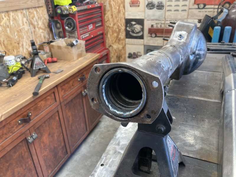

After yanking on them with a puller, they were being stubborn. I welded a bead inside each one to shrink them down and they popped right out. Then there was a drain plug supplied with the kit and I added a pipe fitting at the top of the housing for a low profile vent.

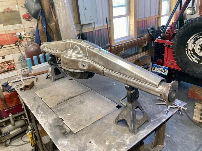

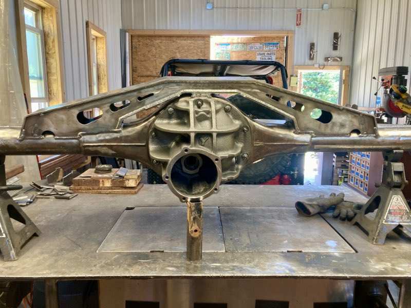

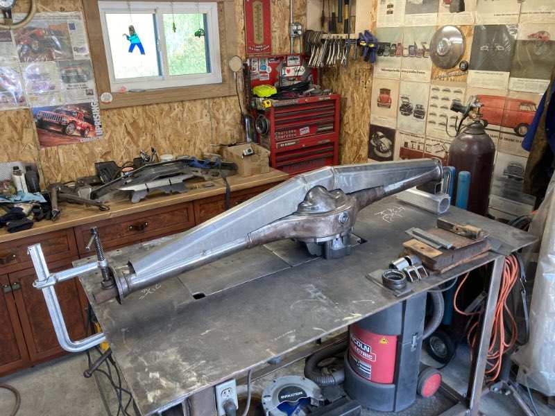

In the past, I’ve used alignment bars to keep these axles straight when doing this much welding on them. My buddy has one however he didn’t have the right size pucks to go in place of the bearings.

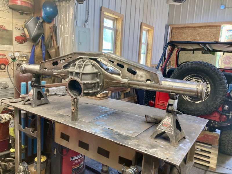

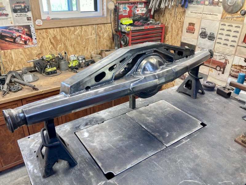

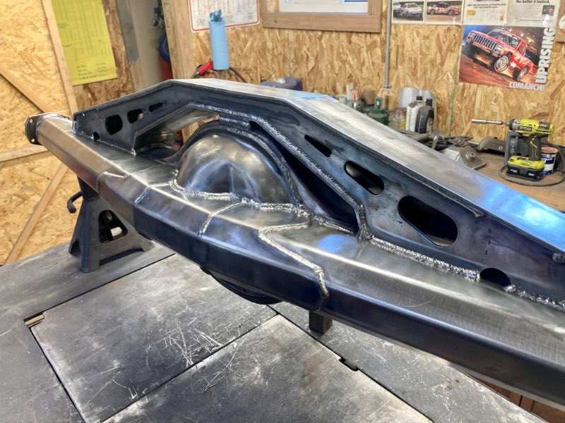

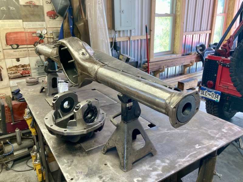

After clamping it to my table with some preload in it, the back brace got some good tacks and I welded the center. Then I chickened out and it sat for a few days. :laugh:
The problem I wanted to avoid was the hub bearing cups. Anytime I’ve welded a truss on a 9” it turns into a 50/50 shot if the outer cups need to get cut off to realign with the center section. Back over to my buddy’s shop for some problem solving!

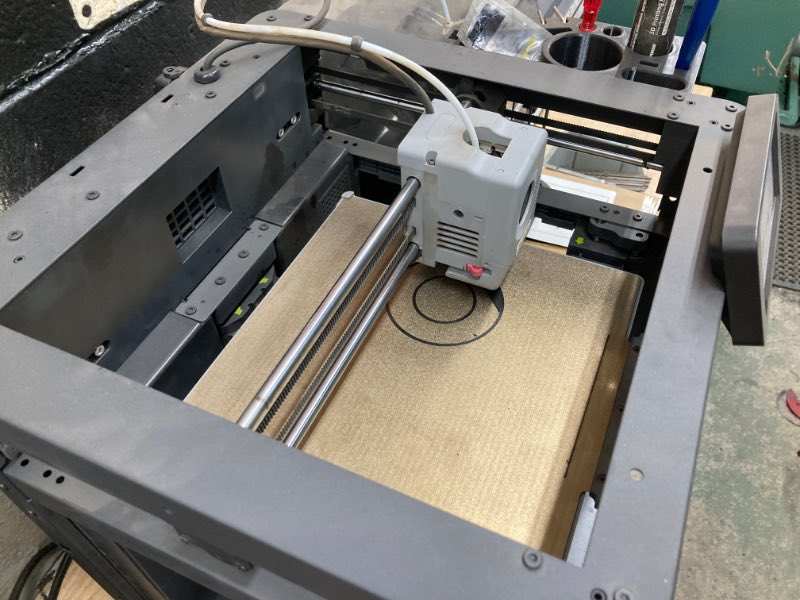

Yup… he 3D printed the pucks I needed! He’s done this before with good results even with getting them a little warm with welding.
Overall, I’m very happy with how Mazen’s axle turned out! It’s so nice to use a truss kit that just fits correctly with minimal fuss. Glad to be part of this rad build! :beerchug:

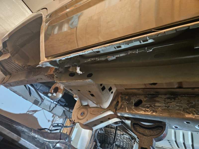

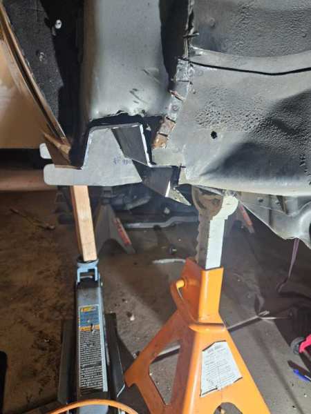

Finally got some time to get back in the garage after summer stuff. Still needing to get the rockers done. They are a royal PITA but I've been going slow to not have hack job.
Got the front piece cut out and mocked up. Instructions from IRO are non existent so lots of test fitting, fix something and over and over again. Looks like there is a masive gap but It needs to be pushed further up and there's also the cap that goes over it.
Then got the rear
This B pilar sections was a bear, could not get it to fit the way it was supposed to so took the BFG and angle grinder to make it fit. IRO is saying you're supposed to weld the pilar to the back but there was no way in hell it would work.
Then final mock up before I burn in the gussets.
