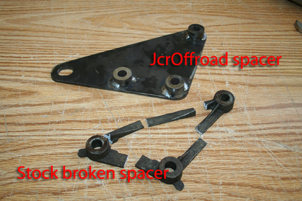

btm24 Posted April 14, 2011 Author Share Posted April 14, 2011 Well it looks like from what Wade and a few others have told me I should be looking into reinforcing the steering box mounts (which can be done with my front bumper mounts) and getting a steering box spacer be for a brace. Wade gave me a good pic of the spacer here: http://www.jcroffroad.com/Merchant2/graphics/00000001/SteeringBoxSpacerCompare.jpg And of a reinforced mount here http://http://www.c-rok.com/ff.html So I think I'm going to do that. Thanks for the help again guys! Brandon Link to comment Share on other sites More sharing options...
