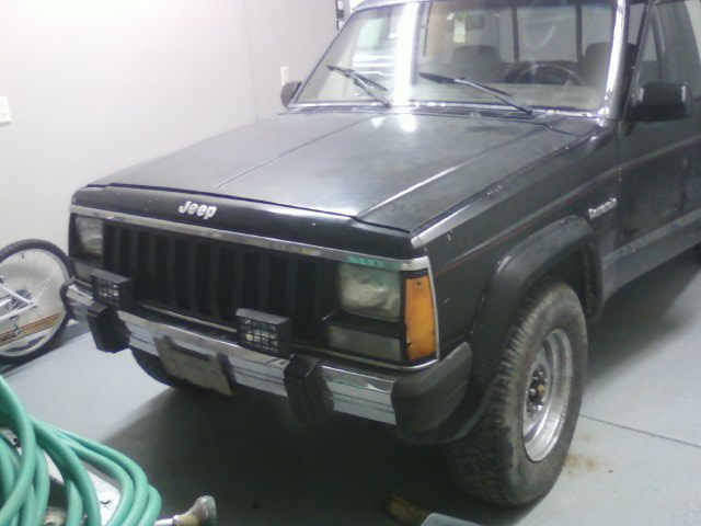

bottomline89 Posted January 1, 2011 Posted January 1, 2011 This is my first truck, i bought it myself from money i got from mowing and stuff like that. i was 13 when i bought it and I'm 15 now. i got it off one of my dads friends. it sat it a field for 5 years and before that was just a daily driver and before that was a pasture truck that never left the land. NO RUST and the engine still doesnt smoke with 206,XXX miles on the original motor. when i got it, it had a bad clutch, radiator and tires.... it has manual windows and they'd only go down part of the way and wouldnt go back up so i took the door panel off, took a pair of vice grips and "unwound" or streched the spring out and the passenger snapped but the driver's side works great now i put a new radiator, new clutch master cylinder, new resivor tank, new valve cover gasket, new vacuum lines, new rear tires (mud and snow 235, 17, r15), straighten steering and major tune up (distributor, wires, plugs, oil, air filter ect.) this is my last, and most major project was putting a new intake/exhaust manifold gasket which was the first one i majorly took pictures of so here they are from start to finish

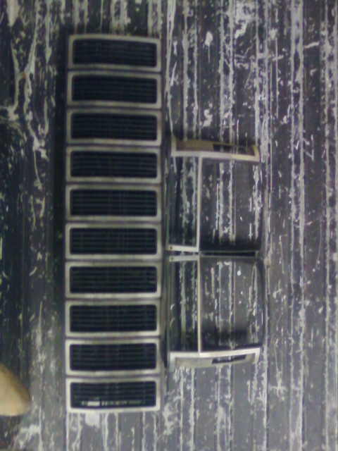

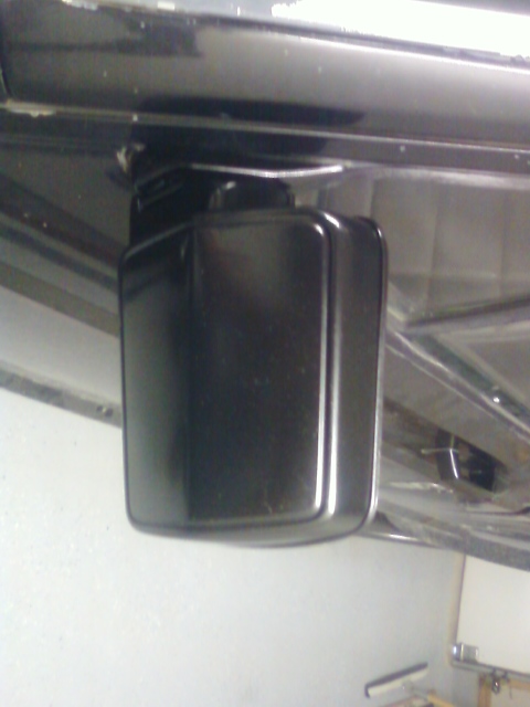

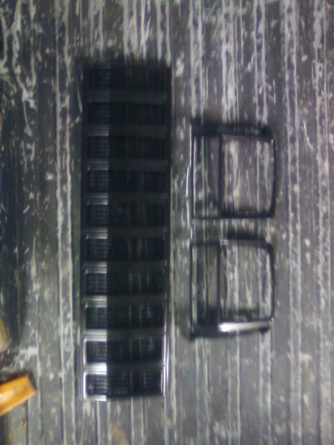

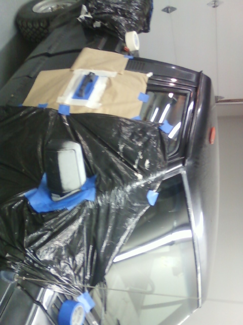

bottomline89 Posted January 30, 2011 Author Posted January 30, 2011 I haven't done anything in a while but this weekend i finally got around to painting those faded plastic parts (door handles, mirrors, grille, headlight frames) Before- After-

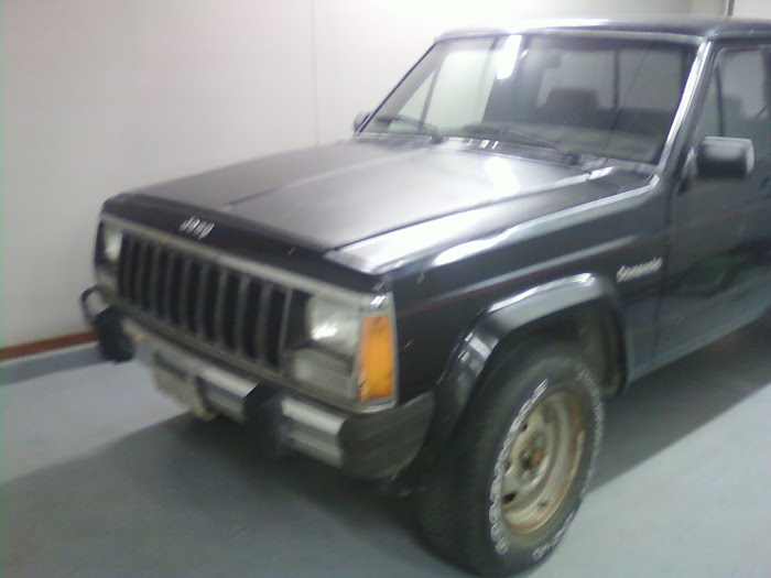

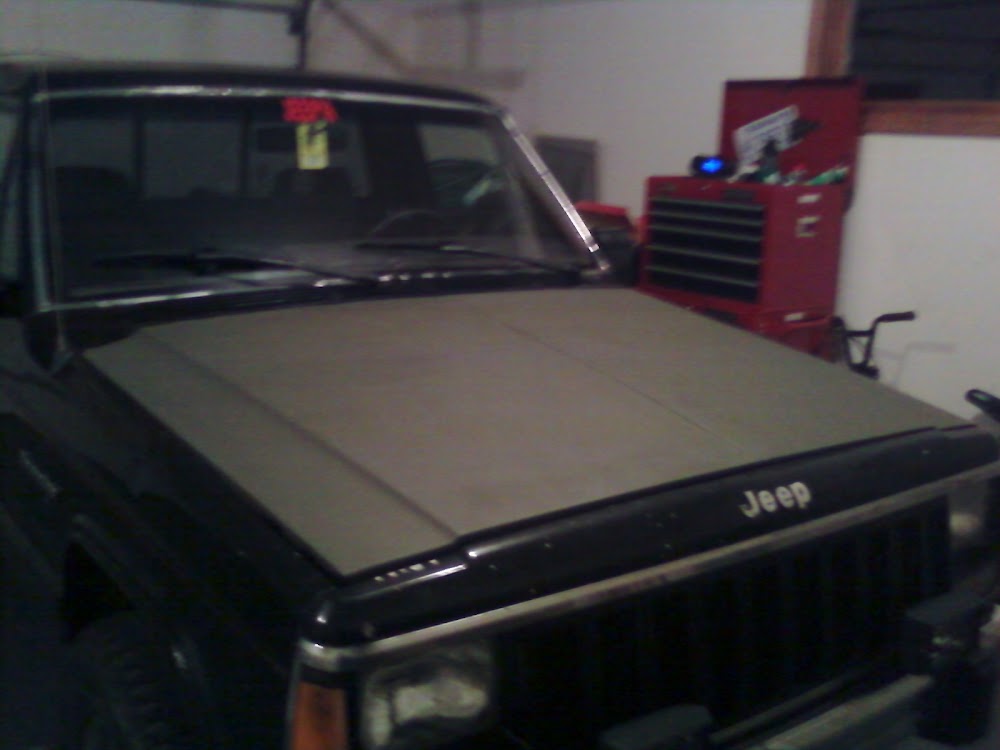

bottomline89 Posted February 2, 2011 Author Posted February 2, 2011 finished product of the last few projects :wrench: wichita's been getting snow consistantly so its a little dirty..

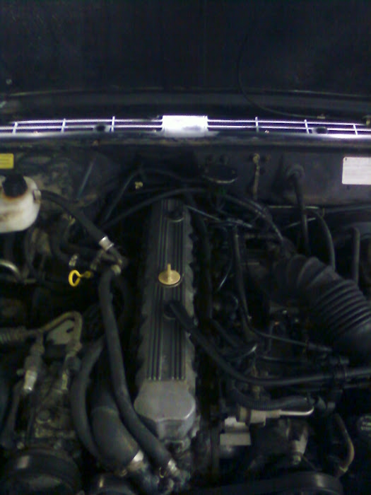

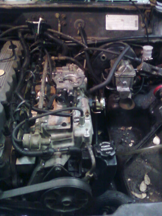

bottomline89 Posted January 10, 2012 Author Posted January 10, 2012 OK! lets keep this ball rolling... Got my full license so she's been working a little on my buddy's land. been hailing a little trailer around :D so since my last post i've gotten the following done.. - new harmonic balancer - tool box - mounted my cb under the dash. (right above my right leg. doesnt get in the way at all) - new fuel injectors from precision auto injectors. they work great! - new oil pan gasket - new vacuum lines i know this isn't very exciting, just keeping you guys updated.. few pictures.. Playing around a little bit Tool Box :D It's an army green and the rest of the truck is going the same color eventually Harmonic Balancer swap Oil Pan gasket swap

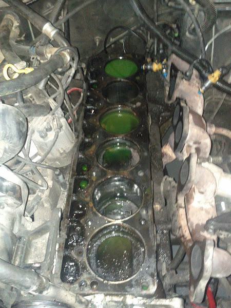

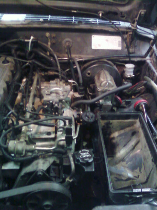

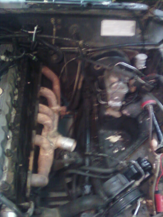

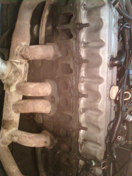

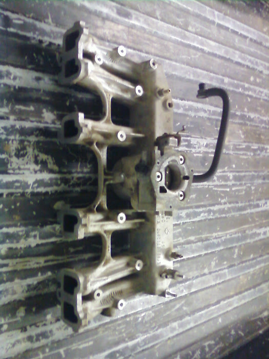

bottomline89 Posted January 26, 2012 Author Posted January 26, 2012 well Layla started to act up a couple weeks ago. she would just die as i was driving, she was lacking power so i checked everything and there was water in the oil.. so here we go.. so i broke out the shop-vac and putty knife and went to work. i rigged up a straw and duct tape to get down around the lifters. I spend a whole day and a half of the build just cleaning. time to go back together. got the head torqued down and the rockers back on.... didn't get a pic of the cleaned block and pistons, i was on a roll and just kept moving nice and clean with a new thermostat housing because i broke the old pot metal one.. and today i just got done putting in a new heater core.. :headpop: only if we all had the dash of a cj..

bottomline89 Posted July 31, 2012 Author Posted July 31, 2012 Alright. it's been a long time since i've put up anything new but layla's had a lot of work done to her so i think it's time to get everyone back up to speed :jump: SOOO... the head cracked and that's what caused the water to get into the oil.. NEW MOTOR TIME :) i decided to buy a rebuilt long block from united engines in wichita.. took them forever to find the amc head I degreased and painted all the inner fender wells.. I know i'll love myself for that later :D I've already got 2000 miles on the new motor and she's running like a champ. NOW. i'm looking for a 4x4 donor cherokee.. wish me luck... or you can help me out :D i've been looking forever.
