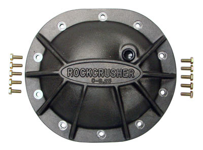

I hopefully will have all the parts together for the 8.25 install after I finish my 8 day stretch at work, that begins on Thanksgiving day. :fs1: Now if I can only make up my mind on a diff cover.
I went with a Rock Crusher cover from jasin over at jeepinoutfitters. Its a ncie looking cover, the fill plug is pretty high, so just watch how much fluid you put it, it will fill up the tubes before it over flows out of the fill hole. I think I added an extra 1/2 quart to mine, just for a little more oil.
http://www.jeepinoutfitters.com/scripts ... oduct=1518
I've looked at those, one thing I found interesting thing is the wide differences in the prices I assume it's the same cover :dunno: ...
http://www.4x4groupbuy.com/store/rockcrusher-chrysler-825-diff-cover-p-9223.html
There is a bunch of great covers out there!! I decided on a Blue Torch Fab cover for my 8.8 in my TJ.
CW
I like it. Nice beefy looking cover. I was told that the 8.25 from Blue Torch is back ordered though. I ended up ordering The Riddler Cover from Rokmen.
