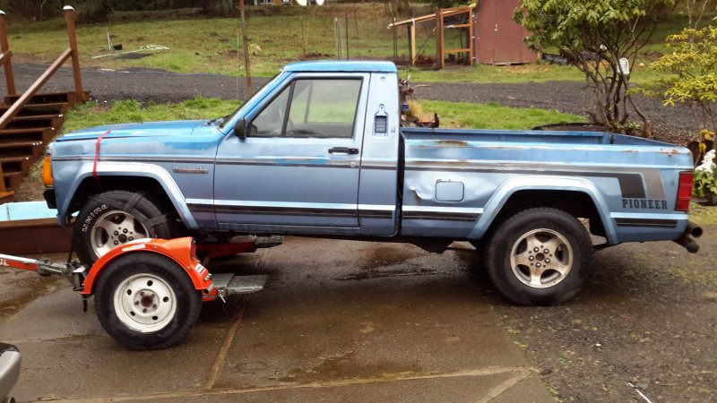

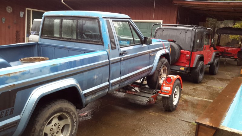

3 week ago I Picked up an 88 Pioneer. 4.0, 5sp 2wd. 207K miles on her. Paid a grand total of $500. Brought it home on a dolly with the hood tied down. She has no rust in her and only a couple of dents. Yes, I did tow it with my TJ. It has not been registered since 2013,
So the first plans was to make it run to see what was. I bypassed the voltage reducer on the fuel pump and she started up. I change the cooling system to an open system, new radiator, hoses, thermostat and housing, and water pump.
replaced all the fuses in the fuse box cause they were corroded, got the electrics flowing again to the jeep, checked the brakes, change all the oils and greased her up good, replaced a steering knuckle and the track bar. change the key lock in the steering wheel and fixed the horn so it would work. She runs now.
Future plans? change it to 4wd, short lift kit, 31"tires, 3.54 gears. upgrade the interior to bucket seats, maybe put a camp wrap on her.
