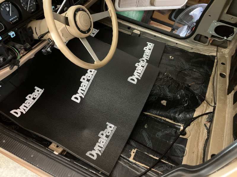

jodawill Posted Saturday at 08:43 PM Posted Saturday at 08:43 PM Does anyone have advice for installing DynaPad around the transmission hump? It's a really awkward shape and it just doesn't lay flat no matter how hard I try. It also doesn't reach the edges. I do have a second pad so I could cut it up to fill the gaps, but I'm afraid of making permanent changed when I don't know what I'm doing.
Pete M Posted Saturday at 08:58 PM Posted Saturday at 08:58 PM you can do it anyway you like. little gaps won't matter and the ugliness will all be hidden for breanne's truck I cut the insulation into shapes that fit on the floorboards directly, aka avoiding putting it on top the frame cap and braces. the key is that the carpet lays proper on top and the various seat bolts and seatbelt bolts are accessible.
jodawill Posted Saturday at 09:28 PM Author Posted Saturday at 09:28 PM 29 minutes ago, Pete M said: you can do it anyway you like. little gaps won't matter and the ugliness will all be hidden for breanne's truck I cut the insulation into shapes that fit on the floorboards directly, aka avoiding putting it on top the frame cap and braces. the key is that the carpet lays proper on top and the various seat bolts and seatbelt bolts are accessible. Did you glue any of it in place?
ratrapp Posted Saturday at 11:09 PM Posted Saturday at 11:09 PM i used the siless brand off of amazon.it was in sheets that you just cut and peel.it did a good job of quieting the cab but I'm sure it would be a mess too remove.
Pete M Posted Saturday at 11:37 PM Posted Saturday at 11:37 PM 2 hours ago, jodawill said: Did you glue any of it in place? only enough to get it to stay put while I wrestled with the carpet (new carpet so there was a LOT of wrestling to be done )

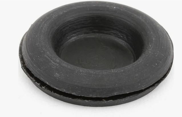

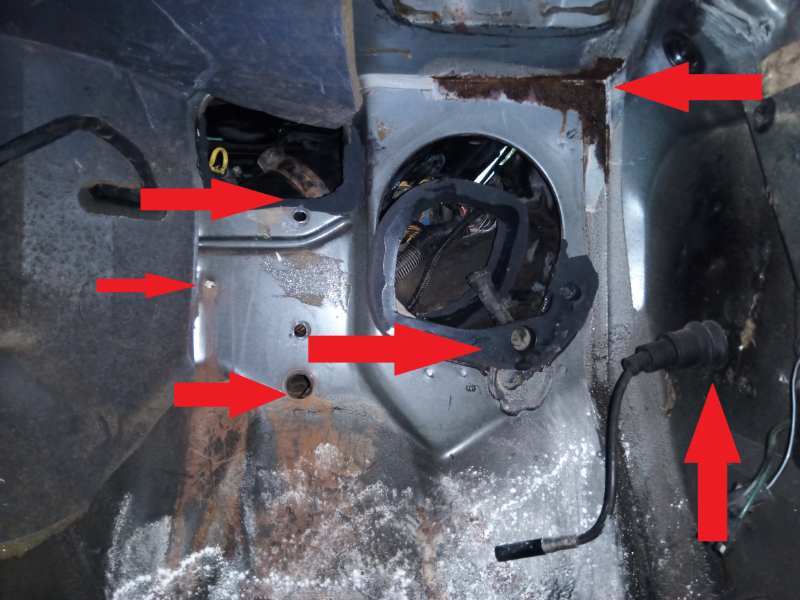

Pete M Posted Saturday at 11:38 PM Posted Saturday at 11:38 PM I've probably mentioned it before, but I'll say it again just in case... it is immensely important that you be sure that all water intrusion has been dealt with. especially the sneaky ones like the antenna grommet.

jodawill Posted Sunday at 01:46 AM Author Posted Sunday at 01:46 AM 2 hours ago, Pete M said: I've probably mentioned it before, but I'll say it again just in case... it is immensely important that you be sure that all water intrusion has been dealt with. especially the sneaky ones like the antenna grommet. Are you talking about the rubber part inside the cab? Where do you get a replacement for that? Or do you just use seam sealer?

jodawill Posted Sunday at 03:30 AM Author Posted Sunday at 03:30 AM 1 hour ago, Pete M said: I bought a generic grommet fit very snug Where did you get the replacement? You bought a single, not a big pack? How did you install it? Do you just pull that rubber right out and over the cable?
ghetdjc320 Posted Sunday at 01:54 PM Posted Sunday at 01:54 PM 16 hours ago, Pete M said: you can do it anyway you like. little gaps won't matter and the ugliness will all be hidden for breanne's truck I cut the insulation into shapes that fit on the floorboards directly, aka avoiding putting it on top the frame cap and braces. the key is that the carpet lays proper on top and the various seat bolts and seatbelt bolts are accessible. Cut it into pieces as Pete mentioned. Personally, I only use dynapad on horizontal surfaces so I don’t run it up the sides of the tunnel. I use a couple of layers of dynamat for vertical areas followed by dynaliner. The dynapad is phenomenal stuff but can make it hard to install carpet if you get it on the areas where the carpet has to bend or curve such as the tunnel hump. Installing dynapad around the frame caps on the floor works excellent. Don’t be afraid to cut your the shapes you need instead of trying to use it as a continuous uncut piece. Also, give yourself some gaps around the seat belt anchors, and specially the outboard ones in the rocker panels. Those are already tough to get to with just the carpet there.
Pete M Posted Sunday at 03:18 PM Posted Sunday at 03:18 PM 11 hours ago, jodawill said: Where did you get the replacement? You bought a single, not a big pack? How did you install it? Do you just pull that rubber right out and over the cable? I used a universal on that truck, but for this next truck I'm getting a sized unit. I think it's 1 1/4"? be sure to get one that is a "make your own hole" so it's a snug fit around the cable.
