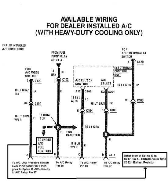

I made an updated diagram for the dealer installed connector for the 4.0, as I realized the ones in all the manuals are for a 2.5:

Making the harness - first steps. The assumption is that the relay will be mounted on the inner fender well immediately aft of the washer bottle, or strapped to the engine harness with the Dealer Installed A/C connector. Since I've done the 97-01 washer tank conversion, I'm mounting on the inner fender well.
5-pin relay is as follows:
85 - to pin B of Dealer Installed A/C connector
86 - to pin C of Dealer Installed A/C connector
87 - to pin D of Dealer Installed A/C connector
87a - directly to G106, tucked into engine harness loom
30 - join diode pin A behind LH headlamp assembly, extend through engine harness to C109 pin C and compressor clutch connector C309
To handle the A/C low pressure switch connection, the Dealer Installed A/C connector pin A needs to run to C239 pin 2, at the switch on the receiver-drier. Low pressure switch pin 1 needs to run back to the A/C relay on pin 87. Since I'm running a 1996-copy plumbing setup, my drier will be just below and outboard of the compressor. That means running a wire to, and back from this location, or tying C239 pin 1 into the LT GRN wire just upstream of C103 (upstream = in the direction of C100) for the return path to relay pin 87. The same applies if you're running an earlier setup, the length of wires needed to make the run(s) will be the only difference.

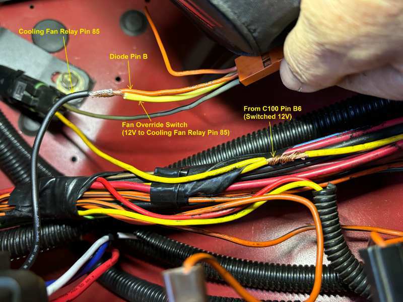

I did not have the Heavy Duty Cooling option, so I wired in a relay for fan control, copying the factory setup. I'm already using a Renix-era radiator mounted temp switch. To get switched 12V for the relay like factory I tapped into the 14AWG yellow wire  from C100 pin B6, behind the LH headlamp. The yellow wire from the diode/ temp switch connector assembly (C243 Pin B) will go here. I'm replacing the temp switch connector I originally installed with the one in the diode harness I harvested.
Diode pin B to cooling fan relay pin 85:

I should go back and explain the source of this connector that will be going into the Dealer Installed A/C connector:
I took both sides of C109 from one of the roughest 88 XJs I've seen in the boneyard in quite a while. I took a pin out of one side to add the missing pin C on my C109. I used the other side to make this. These colors do NOT match what would have been on the Dealer harness or have any meaning whatsoever. They're just the right AWG in the right places and attached to the right things.
The Dealer Installed A/C pins' AWG (engine harness side) for C117 are as follows:
D - 16AWG - LT GRN
C - 18AWG - BLU W/TRC
B - 14AWG - ORN/BLK
A - 16AWG - LT GRN W/TRC
On my homemade connector in the first picture above, I swapped the orange and blue/black pins on B / C, as the blue/black is 18AWG on C109. The orange w/ trace wire on my pin B is 16AWG, not 14AWG per the wiring manuals. That should be no issue, as its job/ current draw is simply to energize a relay on pin 85 (150-200mA). 16AWG has a capacity of 10-13A continuous, short duration up to 15-18A, so a minute fraction of that is fine. 200mA is 1.5% - 2% load vs a wire capacity of 10-13A continuous.
