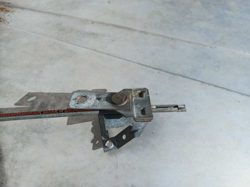

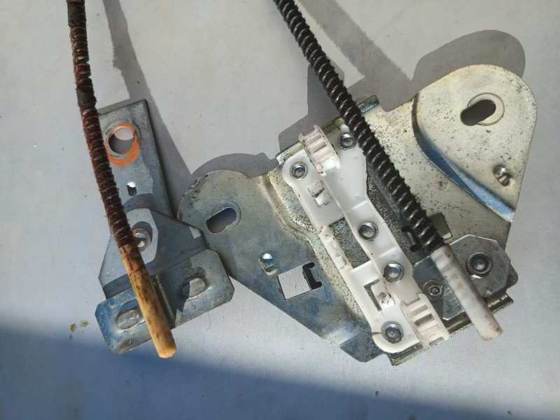

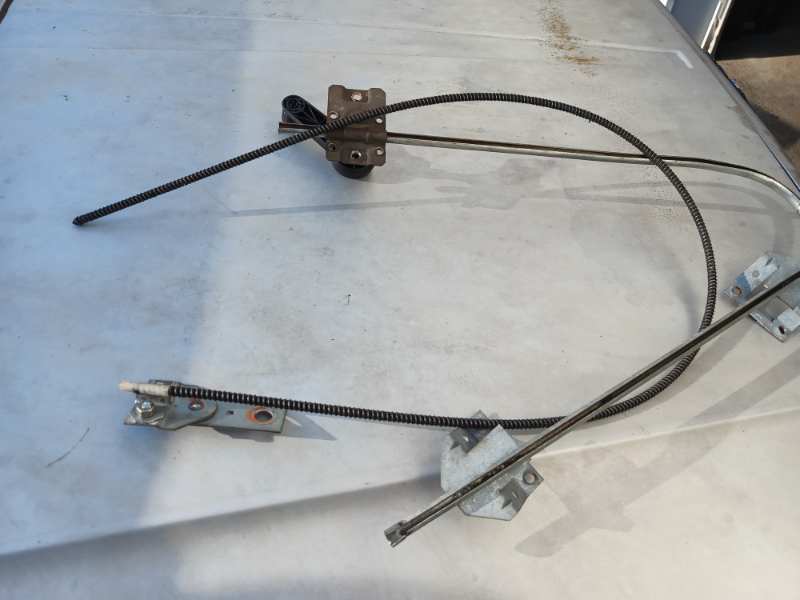

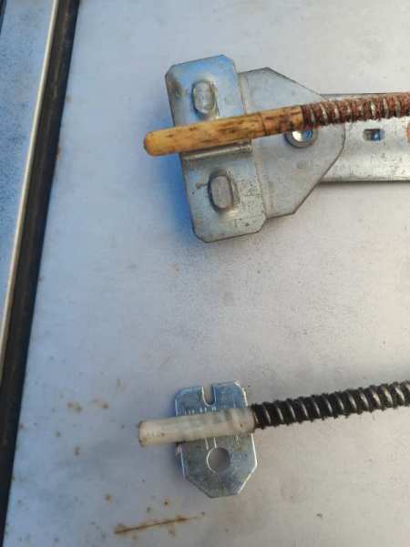

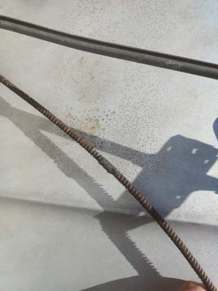

GonzoTheGreat Posted 9 hours ago Share Posted 9 hours ago I took an electric worm out of an XJ (rear door because I figured it had less wear) the trolley assembly is completely different, but the worm is the same, (just a little longer--maybe the front one is equal length. ). Manual on left, electric on right: To take the worm out, you have to uncrimp the end of the tube, I used pliers, then recrimp when the new worm is in. I drilled out the rivets on the electric regulator trolley and drilled out the stamped bits on my old manual regulator. I was able to bolt the new worm onto the old trolley, just slightly off-centered, but its been working great so far. The problems with the old one were obvious. A bunch of hairs had fallen off and caked up with grease and rust. I had sprayed it wil pb blast a year ago, and it was a bit better, but it didn't help for long. I have a lot more confidence in the worm swap as a permanent repair. Link to comment Share on other sites More sharing options...
