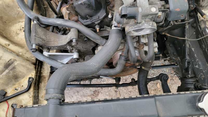

With a little trimming a PT Cruiser electric fan fits the 2.5/2.8 radiators pretty well. They have 2 speeds and you have to wire both power feeds together to get the high speed. Some of the OE style replacements are advertised as pulling over 2000 cfm, so a good one should keep the truck plenty cool. Also, if you use a program such as TunerCat you can lower the fan turn on/turn off temps. The stock fans come on at 228° and that seems like asking for issues given the cooling issues these trucks can face. Also, if you get a upper radiator hose for a 2.8 with A/C you can trim it to fit perfectly from the 3.4 t-stat hosing to the 2.8/2.5 radiator.

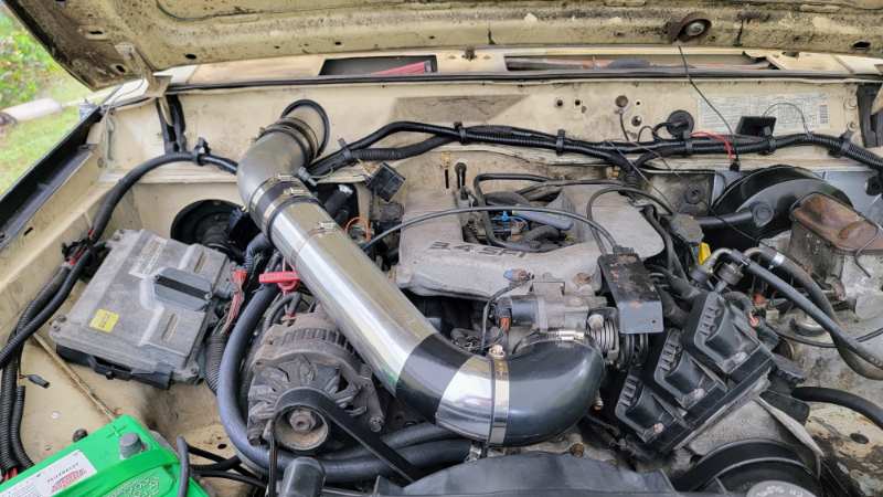

20250919_140133.jpg.8860d4c6a6b48776de97ea9a3cb856eb.jpg.f6cd77b813ec6668084401420b4c680a.jpg
20251013_144026.jpg.080e87ee4a8826db0d4783754ffa0fbd.jpg.7e2ad06356426af87ddad495dd00b203.jpg
My truck was not wired from the factory to have a functional check engine light in the cluster, but I know some 86s were. As such, I just spliced a power tap for the 12v feed to that bulb and plugged it into the fuse panel and spliced the switched ground from the Camaro PCM to the other contact.
I have not figured out how to turn the reverse lights on the truck on with the new shifter. The previous AX5 had an internal switch, and the Camaro uses the PRNDL switch attached to the shifter. Still trying to figure that one out.
