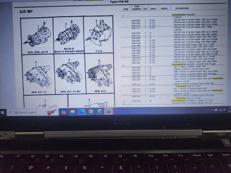

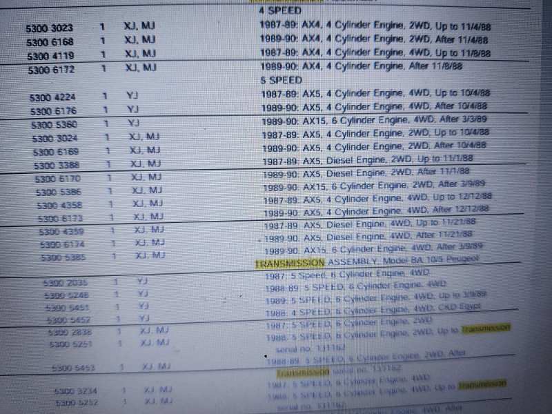

robfg67 Posted Monday at 08:38 PM Author Share Posted Monday at 08:38 PM Thanks for all the responses. I just added the VIN to the registry. The 87-90 Parts Catalog that I have in digital form lists on page 584 that the AX5 was changed on 10/4/88 and has two different part numbers for the transmission: Pre 10/4/88: 5300 3024 Post 10/4/88: 5300 6169 Link to comment Share on other sites More sharing options...
robfg67 Posted Monday at 09:08 PM Author Share Posted Monday at 09:08 PM Here are the pictures from the parts catalog that detail the 10/4/88 difference: Link to comment Share on other sites More sharing options...

eaglescout526 Posted Monday at 11:44 PM Share Posted Monday at 11:44 PM I’m failing to see the difference. Chrysler likes to do that crap. Chances are it’s probably an internal component. Link to comment Share on other sites More sharing options...
