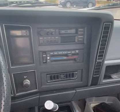

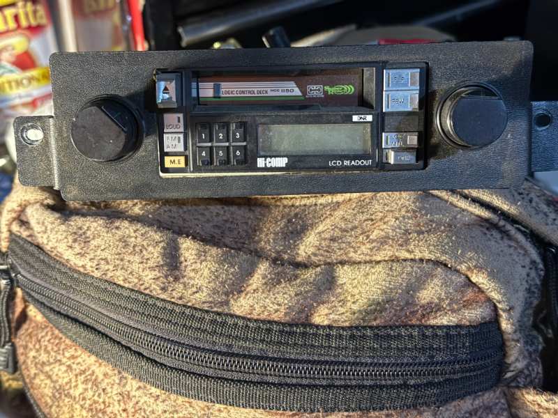

grey89elim Posted December 1 Share Posted December 1 Hello everyone. I've been away from the site for a long time, but I'm back. Since the old radio stop working in the 89 Eliminator, I thought I would replace it. Got an Audiovox out of an 86 Comanche Limited Edition (factory installed). It has all the features. Any ideas? Thanks everyone. It's good to be back. -grey89elim Link to comment Share on other sites More sharing options...
eaglescout526 Posted December 1 Share Posted December 1 17 minutes ago, grey89elim said: Any ideas? Are ya looking for an opinion on the radio or how to put it in? i mean if it works, toss it in for that 80’s/90’s aftermarket goodness and look. Though if I was swapping that in I would look to make an adapter harness so I wouldn’t lose the original wiring. 84-86ish is packard connectors 87-89ish uses metri packs 89-96 uses the Jeep/Eagle/Chrysler connector. Link to comment Share on other sites More sharing options...

grey89elim Posted December 2 Author Share Posted December 2 Thanks eaglescout526, this is good information. I will slap it in. grey89elim. Pete M. I'm not sure, I tried everything. But I'm gonna throw in the Audiovox anyway. It's got the Auto-reverse cassette. Cool. I'm really old school. Bought my MJ off the show room floor in 1988, she and I have been everywhere. Link to comment Share on other sites More sharing options...
