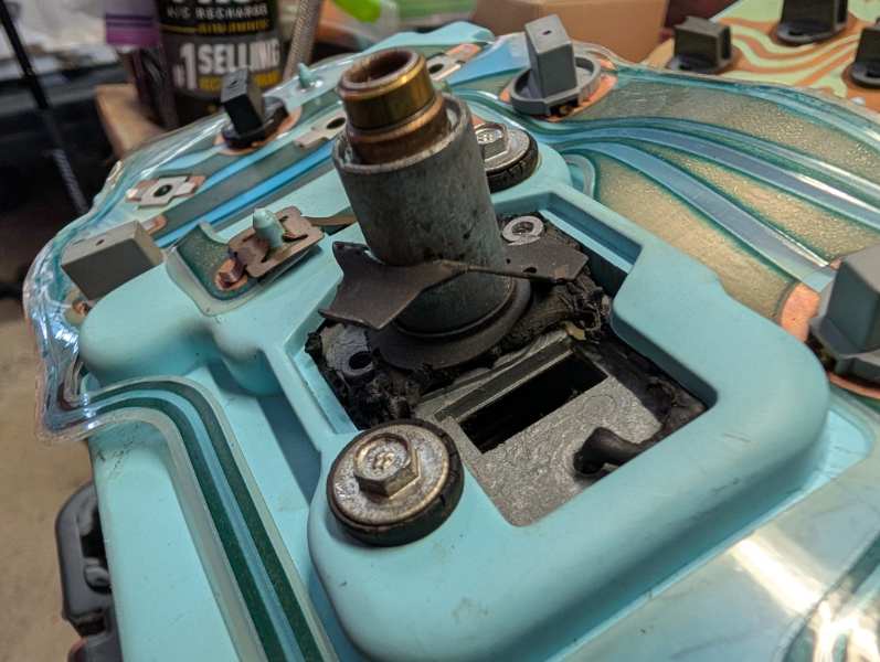

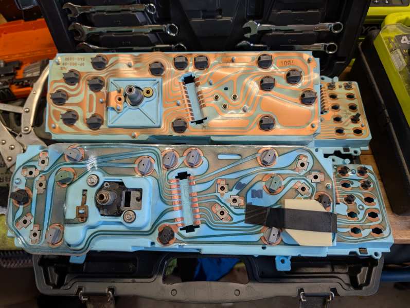

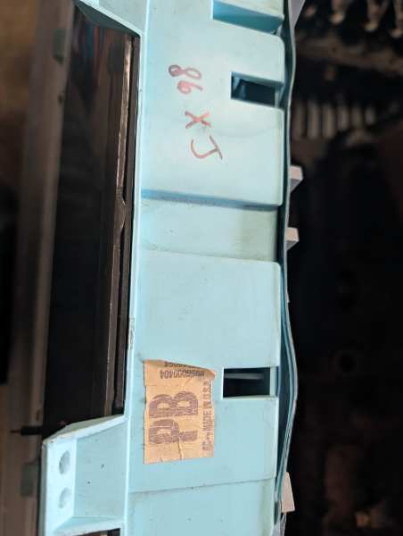

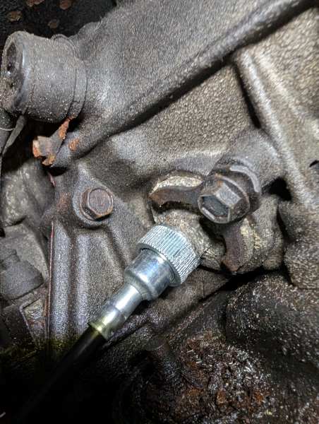

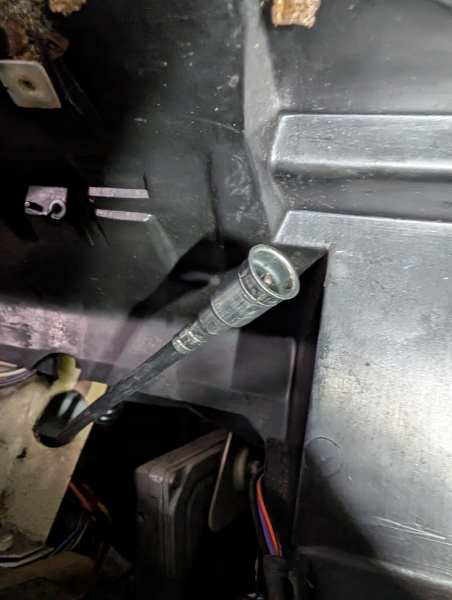

RNMashups Posted December 4 Author Share Posted December 4 Yes, I decided that was for the best. I am actually waiting on a delivery of a '90 XJ cluster at the moment. Blue housing, full gauges. Here are a few images I took a few weeks ago before forgetting to post them. If anyone is reading this in the future, this is NOT the right one to get if you're looking to upgrade an automatic with no cruise control! Pic 1: the original dummy cluster on top. The 5 gauge cluster from an 86. Pic 2: closeup of the 86 speedo and the metal clip. Also shows how the metal housing is a bit taller than normal Pic 3: The speedo cable that wouldn't screw in all the way. This caused the internal rod not to spin. Pic 4: The top of the weird cluster. PB should mean "pretty bad" 😤 Pic 5: The other end of the speedo showing the old school metal end it had. This clicked right into that cluster...too bad it was all for not! Link to comment Share on other sites More sharing options...
