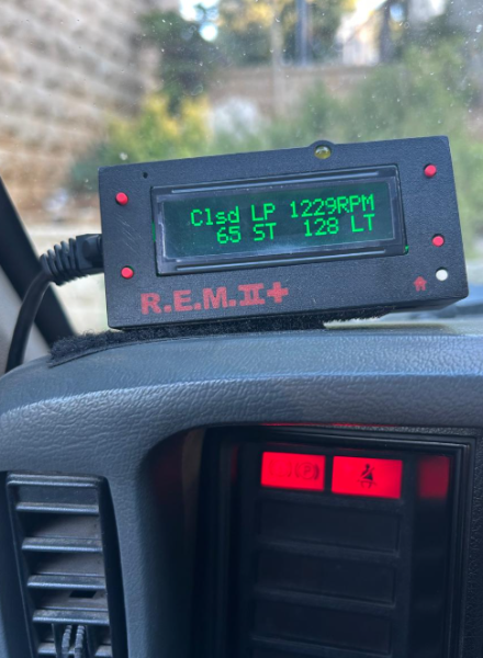

MagicJames Posted September 28, 2025 Author Share Posted September 28, 2025 At high idle it stays in closed loop and STFT will swing between 55-70. LTFT stays a 128. So the ECU is dropping the trim a bit and it's running rich. But I have no vacuum leaks, even from the manifold. Could it be the coolent temp sensor? the connector gets about 5V when cold. Ive tried two so far but havent read the reading when hot, it should drop right? Also this is the sensor in the block, on the drivers side, in case I'm messing with the wrong one. Link to comment Share on other sites More sharing options...

MagicJames Posted September 29, 2025 Author Share Posted September 29, 2025 Nothing in the fuel rail vacuum line when cold IAC is at 128 and will drop sequentially as it gets up to temp. When hot at high idle (1200-1300) IAC is fully extended and will read zero. MAP when cold is starts at 12.8 then will drop to 10.5 when hot. I think my ECU is good, its a lowish mile truck and its trying to close that IAC to bring the idle down. It has to be a vacuum leak right? Do you think I should run smoke through it again? I know a guy that has one with the UV tracer thing. If so which ports do I use? last time i used the brake booster line Link to comment Share on other sites More sharing options...
