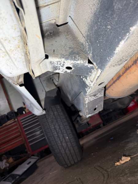

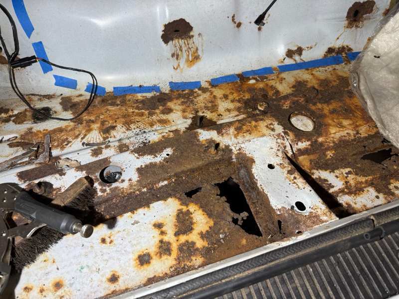

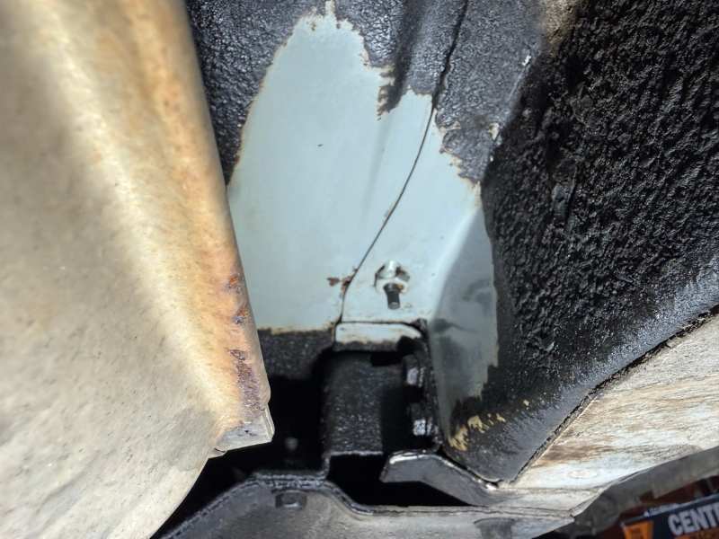

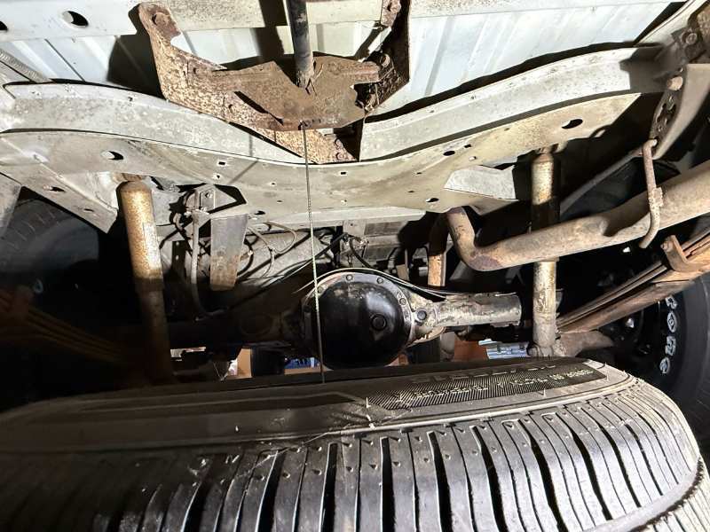

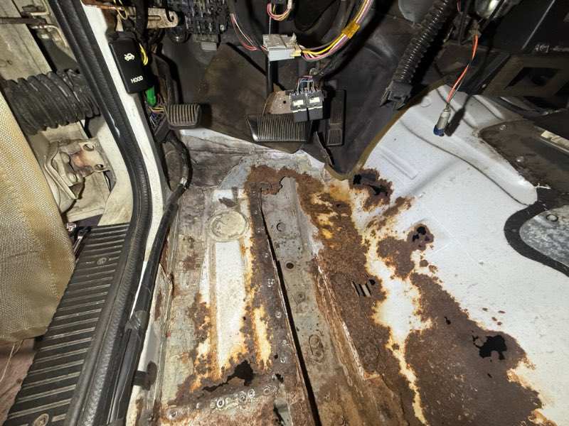

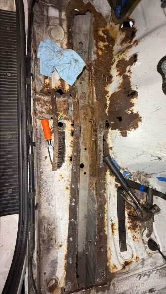

Moosieus Posted July 26 Author Posted July 26 I haven't had any updates to share in a hot minute - been busy upgrading my skills and workspace to make my restoration go right. I've some perhaps interesting data points to share though! With the old carpet removed I've only come to reinforce my theory: the rot progressed from the inside out, likely due to wet carpet retaining moisture against the interior floor. I say that because the underside is stunningly clean. Daisy's underside body is remarkably free of rust and corrosion. Some undercoating was done in the past, which I suspect to be asphalt/bitumen based b/c it dissolves poorly in alcohol and well in mineral spirits. Here's the passenger side rear frame rail for reference. There's not much left of the coating in this area, but it seems to have done well. The underside of the bed while dirty, couldn't look much better for a ~35 year old truck. This makes me believe she was largely spared of winter driving, which would track with the 2x4 open diff config. Here's the passenger side floor, which is DRAMATICALLY in better shape than the driver side (but still getting fully repaired). Here's what the underside looks like for reference with this undercoating removed. More to follow in a moment.

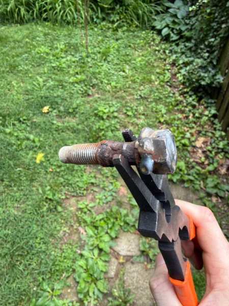

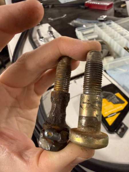

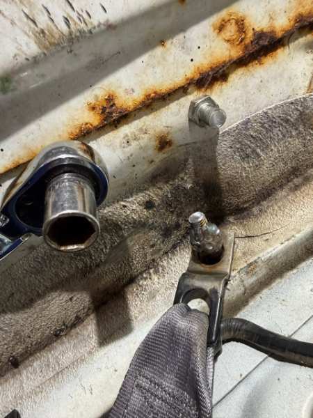

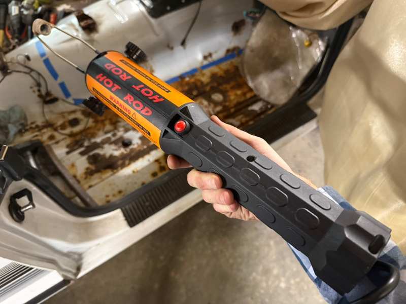

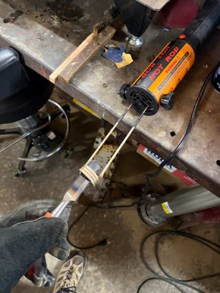

Moosieus Posted July 26 Author Posted July 26 So far my greatest challenge has been removing corroded fasteners while not callously causing competent combustibles to confligrate into certain catastrophe. The worst of this (so far) has been my driver side seat belt (torx) bolt. The tight space and rust on the bolt head left me spare for options. I first managed to weld a tack up and weld a bolt into the rounded out torx head. The first attempt broke on the welds, but left me with more workable surface area. The second attempt resulted in this. I welded, it helded, but the parent bolt ended up shearing ;_; For the third attempt, I cut away the failed bolt, welded on a nut to the now more accreted surface area, and borrowed my pal's "Solary Induction Heater", pictured below. Third time's the charm, right? With the nut welded on, metered use of the induction heater, and a long-@$$ breaker bar, I managed to get THIS RAT B****** OUT! Here it is compared to the passenger side!
Moosieus Posted July 26 Author Posted July 26 I'd say I've learned two key takeaways from all of this: The best (not necessarily the most convenient) extractor for a stripped bolt is a welder. This induction heater is well worth its cost for restoration and general use. I've been especially adverse to using an open torch to free these fasteners, for fear of damaging my interior wire harnesses and factory e-coat. The asphalt undercoating also sponges up petroleum products and is soaked with motor oil, so I regard that as a fire hazard as well. Compared to a torch, induction heating works on fasteners from the inside-out, gets heat into the threads faster, keeps it far more localized, and removes the combustion risks of an open flame. It's a genuinely useful piece of kit I cannot recommend enough.
taddraughn Posted July 27 Posted July 27 16 hours ago, Moosieus said: I'd say I've learned two key takeaways from all of this: The best (not necessarily the most convenient) extractor for a stripped bolt is a welder. This induction heater is well worth its cost for restoration and general use. I've been especially adverse to using an open torch to free these fasteners, for fear of damaging my interior wire harnesses and factory e-coat. The asphalt undercoating also sponges up petroleum products and is soaked with motor oil, so I regard that as a fire hazard as well. Compared to a torch, induction heating works on fasteners from the inside-out, gets heat into the threads faster, keeps it far more localized, and removes the combustion risks of an open flame. It's a genuinely useful piece of kit I cannot recommend enough. The induction heaters have gotten a lot cheaper in the last couple years so I picked one up recently but haven't used it much yet except to test it out. Welding has always worked for me in the past though. Maybe it takes a few tries but the additional heating and cooling probably help loosen things up to. The shoulder on that seat belt bolt looks pretty gnarly though!!
pizzaman09 Posted July 29 Posted July 29 On 7/26/2026 at 7:05 PM, Moosieus said: I'd say I've learned two key takeaways from all of this: The best (not necessarily the most convenient) extractor for a stripped bolt is a welder. This induction heater is well worth its cost for restoration and general use. I've been especially adverse to using an open torch to free these fasteners, for fear of damaging my interior wire harnesses and factory e-coat. The asphalt undercoating also sponges up petroleum products and is soaked with motor oil, so I regard that as a fire hazard as well. Compared to a torch, induction heating works on fasteners from the inside-out, gets heat into the threads faster, keeps it far more localized, and removes the combustion risks of an open flame. It's a genuinely useful piece of kit I cannot recommend enough. I've recently purchased an inductive heater, about $160 from Amazon. It's one of the best tool purchases I've ever made, almost a miracle cure for rusted on hardware. A set of bolt extractors used on the end of an air hammer are also quite useful. This truck is luck to have found you, Daisy is a lucky gal. I'm jealous of your 1991 Eliminator graphics, they are so much cooler than the earlier Eliminator graphics.

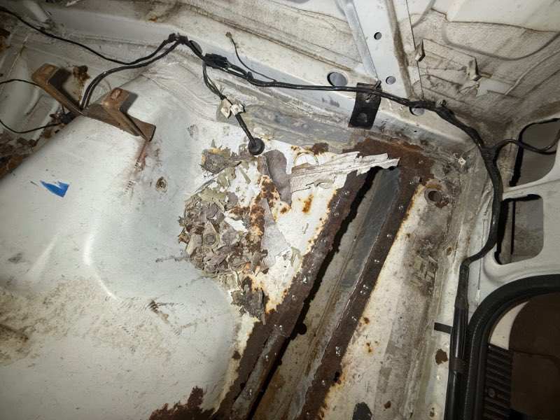

Moosieus Posted August 29 Author Posted August 29 Making incremental progress, damn this is a lot of work… I’ve removed most of the driver side longitudinal floor support, providing a look at the interior of the frame rail. It’s mostly clean primer with some surface rust. That’ll clean up nicely with some abrasives, Ospho, and 2K epoxy primer. For all the damn work this takes, I’m buying a stroker motor someday.
