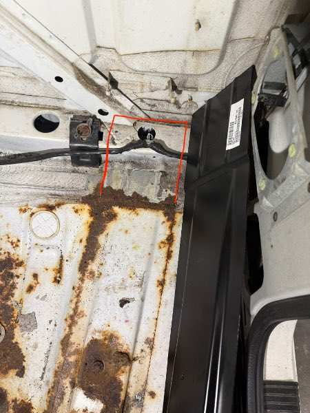

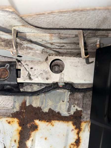

I’m currently working on restoring my driver side floor with the necessary components from Key Parts, build thread for reference. Does anyone have a canonical procedure on how to disassemble the rear flange on the longitudinal floor supports? Pictured below with the Key Parts replacement for reference. Everything else in the teardown process is relatively customary — removing seam sealer, cutting spot welds, etc. This overlap is the only thing giving me serious pause. There’s a fastener in this hole for reference. To dump my thoughts: I’m hoping any spot welds are forward of the square-tube, such that I don’t need to pull apart the rear wall of the truck. Hopefully the bolt pictured above is the only other thing I need to remove.
