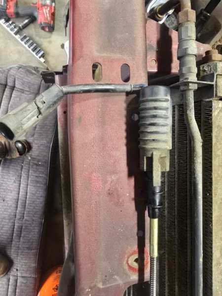

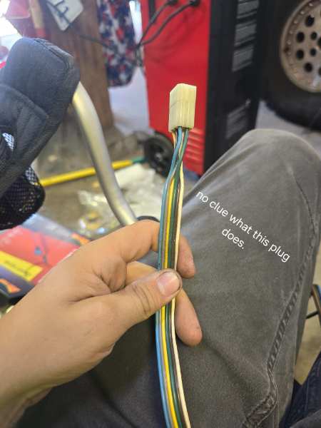

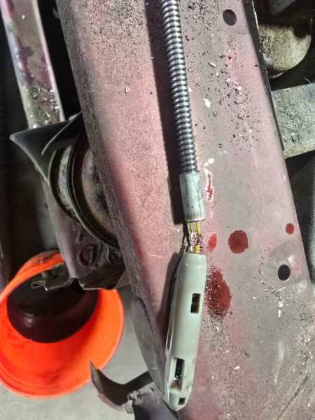

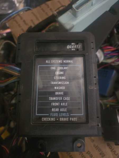

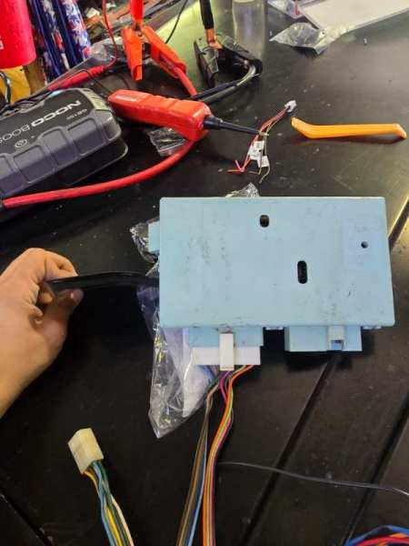

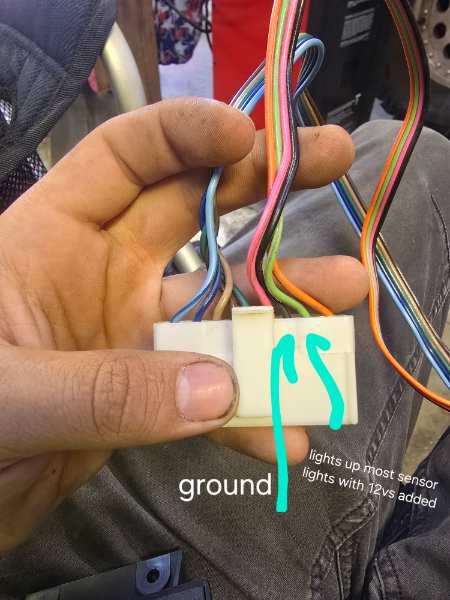

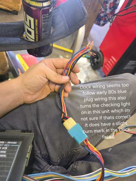

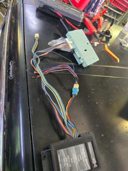

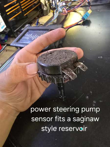

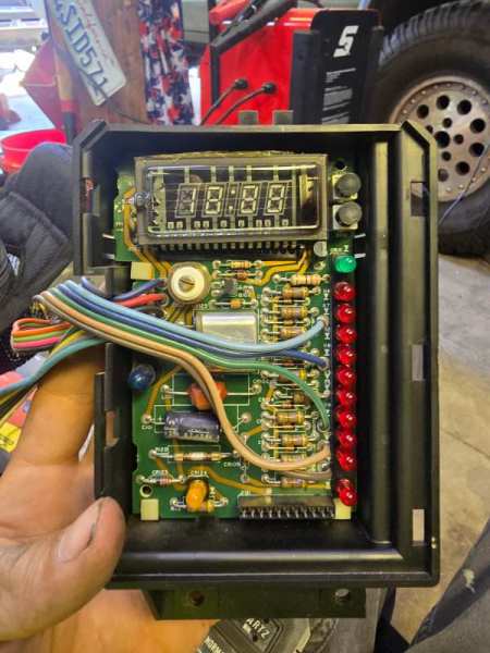

Muncher Posted August 7, 2025 Share Posted August 7, 2025 Hoping to make this into a spot for all the little bit on info we have on sentry. Here's some first day owning a sentry info lol. Got some lights to work all though it does have a burn mark in the clock but that does still work. Checking light is stuck on when the clock is powered and I got those red lights to pop on with one wire conducted with 12v. I have the computer but am waiting on the engine side harness for the sensor inputs. I have no idea what the white plug does any input would be awseome the only sensors I currently have are the washer fluid and power steering rear axle might be obtainable but its a d35 so not sure if its worth the 4 hour drive again. Link to comment Share on other sites More sharing options...

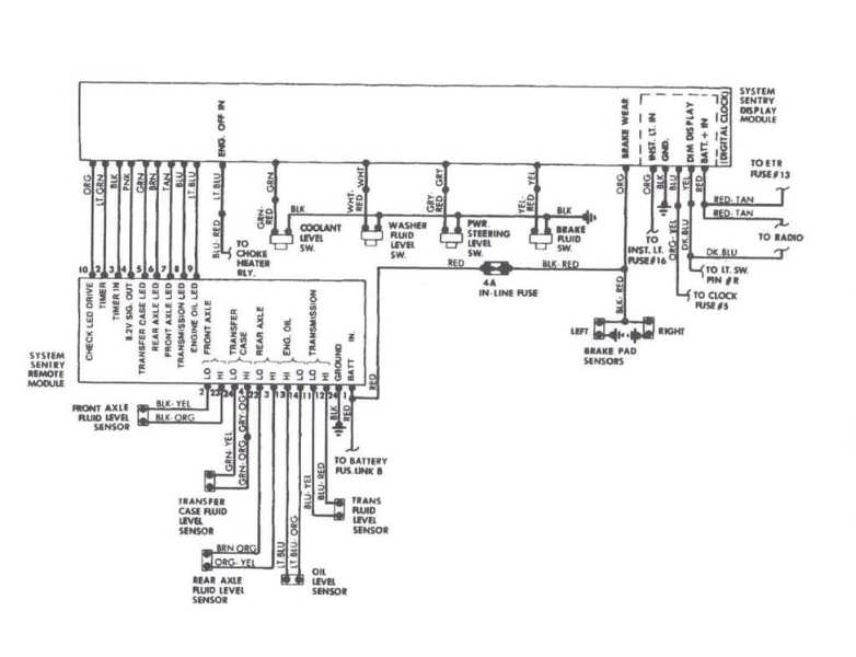

Ωhm Posted August 7, 2025 Share Posted August 7, 2025 Someone on here posted this once. If I knew/remembered who, I'd tag the picture. Link to comment Share on other sites More sharing options...

Muncher Posted August 8, 2025 Author Share Posted August 8, 2025 19 hours ago, Ωhm said: Someone on here posted this once. If I knew/remembered who, I'd tag the picture. Looks like the main plug. Link to comment Share on other sites More sharing options...

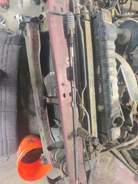

Muncher Posted August 8, 2025 Author Share Posted August 8, 2025 19 hours ago, 89 MJ said: You could always add better axle shafts and stronger parts to the D35. At the very least, I would think you'd want the sensor out of it. Yeah id like to have it jt does not look easy to get the sensor out though Link to comment Share on other sites More sharing options...
eaglescout526 Posted August 8, 2025 Share Posted August 8, 2025 The one on the rear axle, that’s just a shield protecting it. Link to comment Share on other sites More sharing options...
