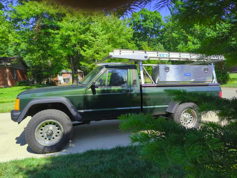

jamespwsullivan Posted Sunday at 08:55 PM Share Posted Sunday at 08:55 PM I have a Currie Dana 44 front axle and am using stock XJ springs with ~1.75" pucks to get me good clearance for my tires. Everything is working fine but the front end is STIFF... I would like to substitute springs that would give me a softer ride and hopefully be long enough so that I could dump the pucks. I'm running a 4.0 and seldom go off road. It is a fine work truck with a ladder rack and bedside box. Looking for ideas and guidance. Is there a stock spring that might fit the bill? I'm guessing that I could go custom but I bet that's expensive. Thanks in advance Link to comment Share on other sites More sharing options...
