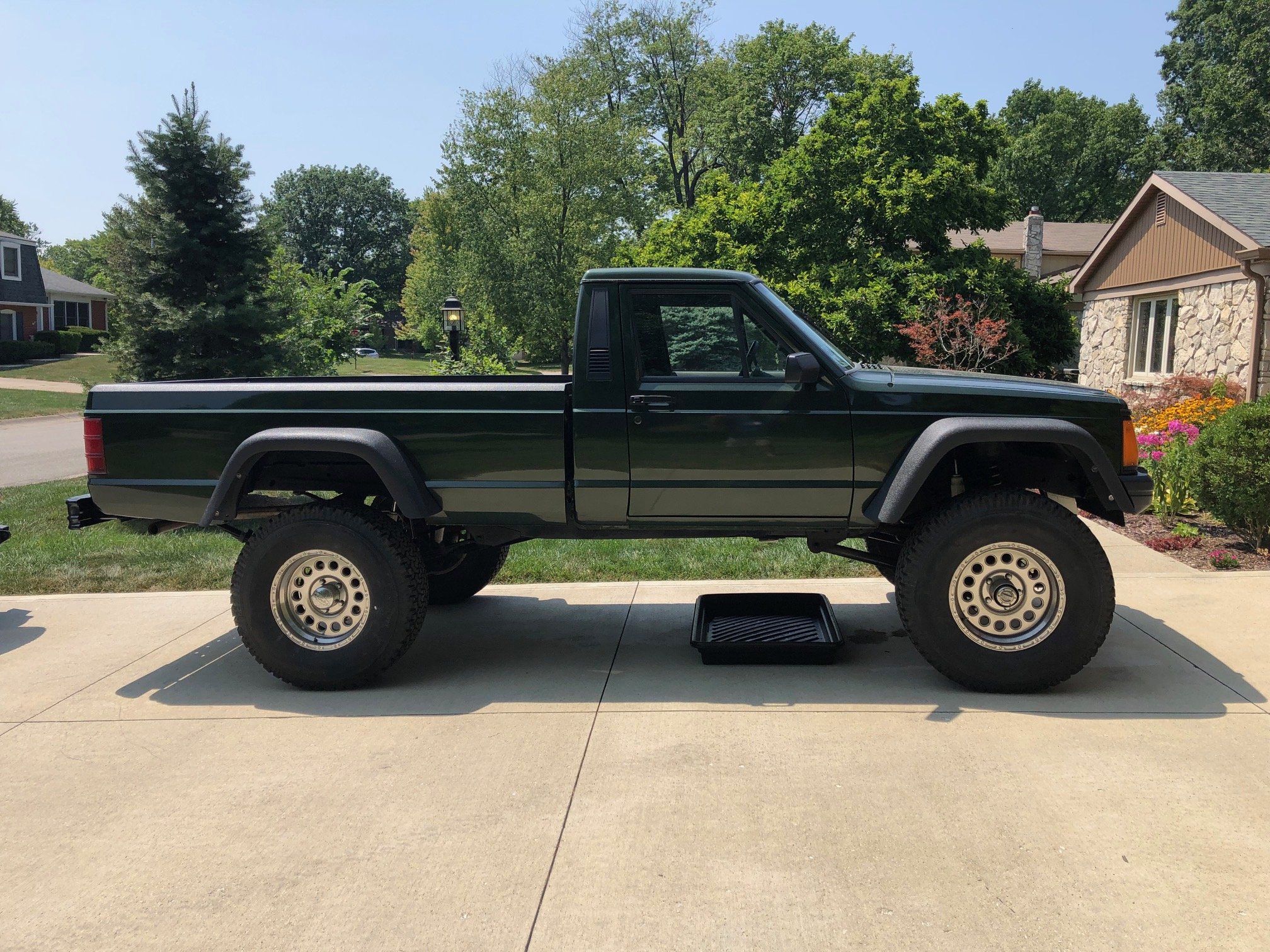

  5. Thanks for the ideas. I don't think that I am hitting the bump stops but i do get a "bang" occasionally that seems to happen before any bump stop interaction.. It could be that the isolation shims (rubber OEM?) for the long bed are either missing or worn out but that's a different symptom. Shocks certainly play a part and I understand that different (better) shocks could be the answer. The reason I started out looking at the springs is that if the springs are "softer" then won't they compress more easily? It seems like they are barely compressing. I think I understand that the compression on the shocks (dampening) should control the speed at which the springs compress, but what if the springs are so stiff that, under a quick and hard compression (hitting a wheel-swallowing chuckhole at 30 mph), the shock dampening doesn't even come into the equation? If I'm missing something and the dampening effect of the shocks is what is really controlling the ride, then so be it. Willing to be educated...
  6. I have a Currie Dana 44 front axle and am using stock XJ springs with ~1.75" pucks to get me good clearance for my tires. Everything is working fine but the front end is STIFF... I would like to substitute springs that would give me a softer ride and hopefully be long enough so that I could dump the pucks. I'm running a 4.0 and seldom go off road. It is a fine work truck with a ladder rack and bedside box. Looking for ideas and guidance. Is there a stock spring that might fit the bill? I'm guessing that I could go custom but I bet that's expensive. Thanks in advance
