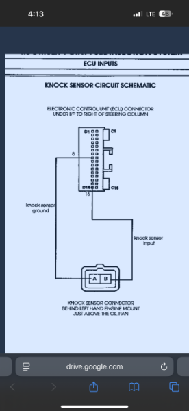

ja_racing Posted July 19 Author Share Posted July 19 5 minutes ago, Ωhm said: Shifting the CPS either CW or CCW only fools the ECU to thinks a cylinder is at TDC when it is not. Shifting will also shift, for each cylinder, when KNOCK looks for ping and when the INJ fires. The ECU seems to be able to handle CPS ADVANCE, not sure on CPS RETARD. I'd pin it out, back to the ECU just to make sure. I'm going to hold of on messing with cps rn I'm going to check the knock plug to ecu for continuity and found a page hopefully its accurate in how the wires go following how its pictured and get a new better knock sensor i have a autozone in it rn Link to comment Share on other sites More sharing options...
Ωhm Posted July 19 Share Posted July 19 Drawing matches the stuff I/we have. _mj1988electricalmanual_1.pdf Link to comment Share on other sites More sharing options...
ja_racing Posted July 19 Author Share Posted July 19 Ok cool ima buy a oem knock from a member and make sure its connected correctly and go from there Link to comment Share on other sites More sharing options...
ja_racing Posted July 19 Author Share Posted July 19 4 hours ago, Ωhm said: Drawing matches the stuff I/we have. _mj1988electricalmanual_1.pdf Just checked it and i have the wire continuity on the knock sensor connected opposite than what the diagram says I'm going to correct that see if that does anything Link to comment Share on other sites More sharing options...
