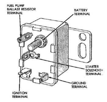

llhat Posted July 3 Share Posted July 3 solenoid on the starter it does a couple of functions, transfers power from the battery to the windings, and 'pulls' the lever to engage the bendix to the flywheel there is also the starter relay up behind the battery under the plastic cover over the coil and some relays. this relay supplies a signal to the solenoid ( small wire) to energize. start.pdfstart.pdf Sounds like starter winding shorted to me... and some contacts 'fried' in the relay or solenoid ( the extreme voltage draw that you are experiencing) i take it you did not release any 'smoke'? check your cables for resistance or damage... good luck! Link to comment Share on other sites More sharing options...
