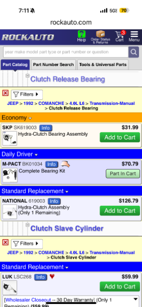

also on rock auto there is a clutch release bearing.. under the 92 Comanche, it looks like a slave cylinder idk if it’s the same thing just under a different name
19 minutes ago, InTacosWeTrust said:
Yes, I’m very curious about the timken one as well! I’m honestly not sure which one I should go with, I want to have a good quality one.
Post the part number or link. Probably the same thing
