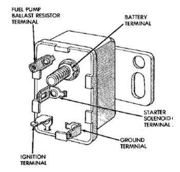

llhat Posted May 29, 2025 Share Posted May 29, 2025 Just from memory I think the pigtails on both the + and - were at least 12 gage.... I do not think relay control, I'd have to go pull the cover and see where it went... i think to the main terminal (threaded on this image) there are leads heading to the alternator from the relay also from that threaded terminal. starter solenoid terminal goes to the solenoid ON the starter to energize fuel pump terminal bypasses the fuel pump relay block and ballast resisitor (IIRC) i know on that terminal you can jump from battery + to that wire and pump will run continuously Link to comment Share on other sites More sharing options...
AnotherOldJeepGuy Posted May 30, 2025 Author Share Posted May 30, 2025 5 hours ago, llhat said: i think to the main terminal (threaded on this image) That is correct, I went ahead and pulled the plastic cover and the + pigtail does indeed go to the Battery Terminal. Link to comment Share on other sites More sharing options...
