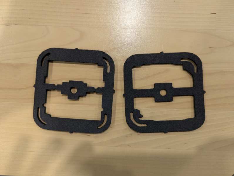

H3ADBANG4L1F3 Posted February 1, 2024 Share Posted February 1, 2024 Browsing forums the other day I came across this gasket that allegedly fits the Comanche/Cherokee fuse box. Will be testing whether or not that's the case soon! I purchased from here: https://gbodyparts.com/product_info.php?products_id=3016 Looks like it's from this site: https://www.casperselectronics.com/cart/index.php?route=product/product&path=12&product_id=870 Link to comment Share on other sites More sharing options...

Gojira94 Posted February 5, 2024 Share Posted February 5, 2024 Here's what's left of my old one, compared to the one from Casper's. Looks like an (almost) perfect match. Ordering now lol. GM and AMC both referred to the connector as "C100." AMC C100 vs GM C100 (88 Electrical Manual image vs the one in the Casper's 107149 install instructions) Link to comment Share on other sites More sharing options...
H3ADBANG4L1F3 Posted February 5, 2024 Author Share Posted February 5, 2024 Definitely looks like it'll work! Glad to see someone else confirm that obscure post I found lol. Link to comment Share on other sites More sharing options...

H3ADBANG4L1F3 Posted February 27, 2024 Author Share Posted February 27, 2024 Went ahead and knocked out the fuse box tonight, the gasket fits perfectly! I didn't get all of the old black grease, but I did scrape out the bulk of it. Here you can see the old crusty gasket. It just crumbled as I tried to take it off. Here's the new gasket. A perfect fit! Nevermind the bent plastic at the top, it was like that before. Straightened it out as best I could. Here you can see the gasket peeking out before I screwed everything tight. Fingers crossed this will take care of at least one leak source! Link to comment Share on other sites More sharing options...
