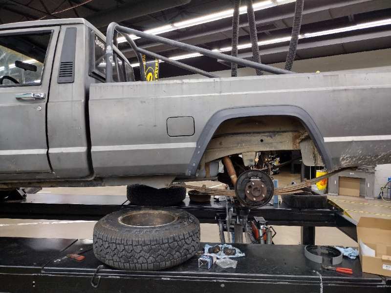

Found out why the brake pedal is a bit spongey and where the leaking fluid is coming from - the drivers rear wheel cylinder is leaking a bunch. Good thing I bought replacements already!
Got the rear brakes torn apart this afternoon. Had to buy another wheel cylinder because I could only find one of the ones I bought. Discovered the shoes are pretty shot so it's going to be a full brake job. Posted in another thread trying to figure out if I can use the TJ brakes I have that are on a bad axle.
Daughter drove her MJ in traffic. She did not do well under pressure and after stalling it about a dozen times trying to pull out of a parking lot, she told me I was driving. Think she may be sitting too far forward and doesn't have enough pedal control.
Finished up the brake job today.
Didn't take any "after" pictures. But it stops even better now and the brake pedal is no longer soft. Ended up just getting stock replacement shoes instead of trying to fit the newer TJ brakes on it.

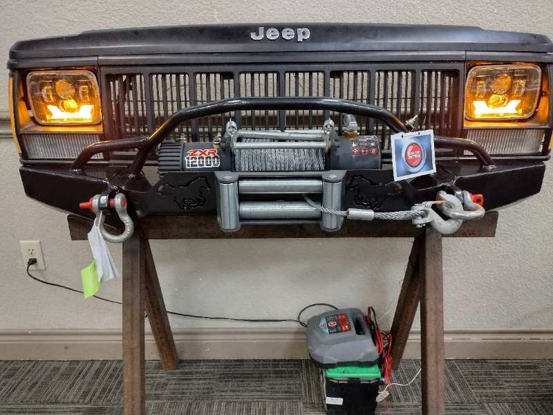

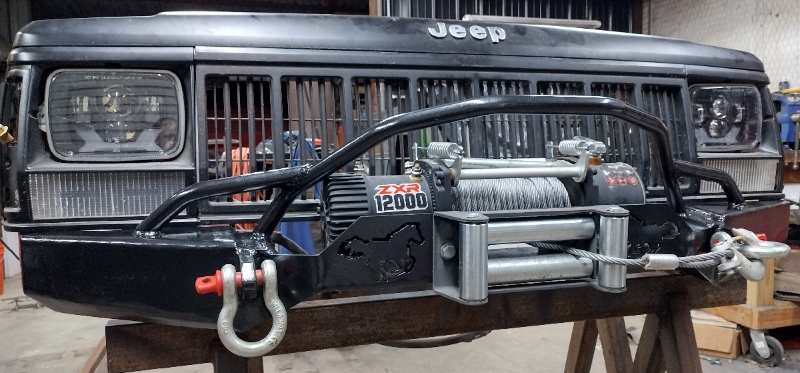

Well the last few weeks have been spent on building this:
Built for a show by my daughter. She designed and built it. I didn't like the aftermarket bumpers that require cutting the grille to fit the winch, so we built around those design flaws. Once the show is over we'll get back to working on her truck.
EDIT: She got sixth place. She's bummed, but the bumper was extremely popular with spectators and she gets to install it on her truck anyway.
