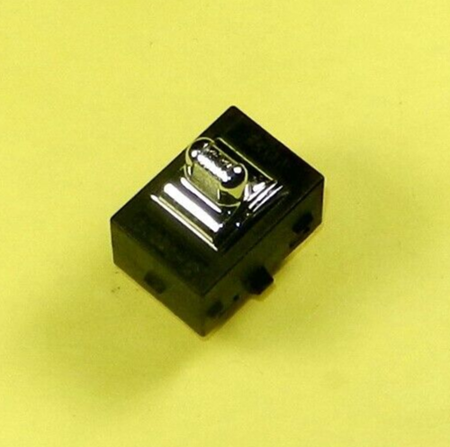

If the issue is a problem with one of my switches, could I just go use the ones from an XJ? I know of a 4 door laredo XJ in a local junkyard that has power windows and locks.
1984-1996 Jeep Cherokee Rear Passenger Power Window Switch Chrome OEM - Picture 1 of 8
Something important to consider, the passenger side switches. The locks don't even lock from this side, but even stranger is the fact that the power window only moves in one direction, but won't go in the other.
