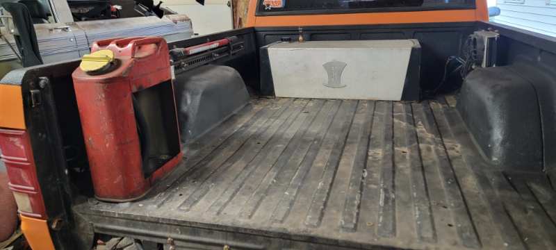

ThatJeepGuy Posted March 17, 2025 Author Share Posted March 17, 2025 Spring is here, holy smokes it's been over a year since I've updated this! I think I can safely declare it's time for some change! This single piece window, the fuel cell and potentially the trans cooler gotta go! I'm sure ive said it in here before but i really want all the bed space back and while ive had a TJ tank setup sitting on my shelf for a while now (stuck undecided on how to mount it) i think its finally time to just remove the fuel cell and make it happen! At the same time why not relocate a trans cooler to the front of the jeep? The last bit - factory rear sliding glass! In my other MJ build (truggy) I have sliding rear glass and it's very nice on the warmer days with slow crawling - ive missed that option from day one with this Orange truck. Not doing as much crawling but the option for extra air flow through the cab is desirable. The fun part to acquiring another sliding rear glass becomes simple. Buy expensive salvaged glass from ebay or by luck - buy a whole truck locally and salvaged the glass yourself. Unfortunately I have done both 😑, Not only did I nab that tan longbed MJ ($400) i also to my surprise won an ebay "make an offer" listing for $330. Honestly not my original plan but here we are... Soo here's to springs welcomed warmer weather, a glass job with a spare to cover my a$$, a new fuel delivery setup and trans cooling setup and a future filled with en empty pickup bed.... or 2 empty pickup beds 😉 More to come! Link to comment Share on other sites More sharing options...

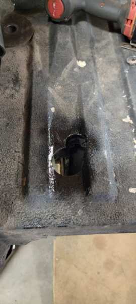

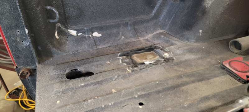

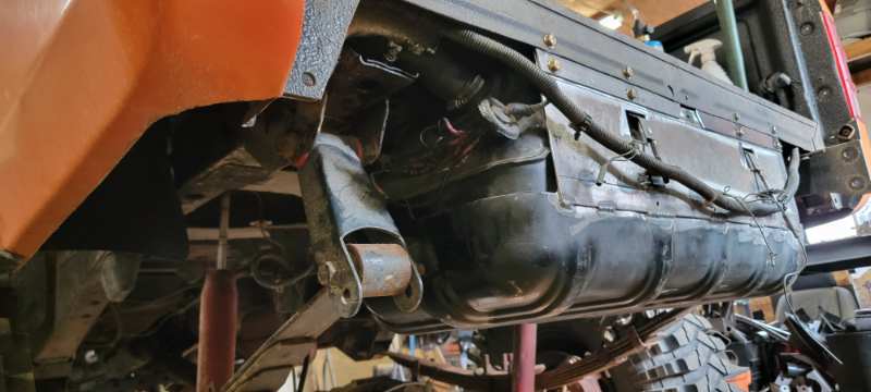

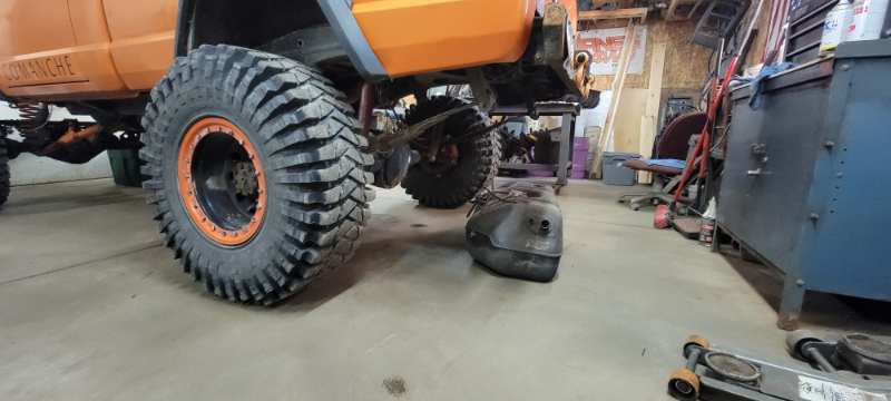

ThatJeepGuy Posted April 7, 2025 Author Share Posted April 7, 2025 Well it's finally time! Prepare for custom install! Yup that's the spot right there Hit the steel skid with some death wheels cuts Then pre installed the assy for some reference marks and came to adding some steel to the rear so it will attatch to the rear of the bed. And there we have it, it's angled down atm but that will get remedied before I start figuring out the front mounts More to come on this- see you next weekend OJ Link to comment Share on other sites More sharing options...

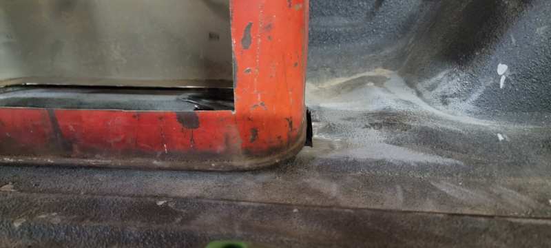

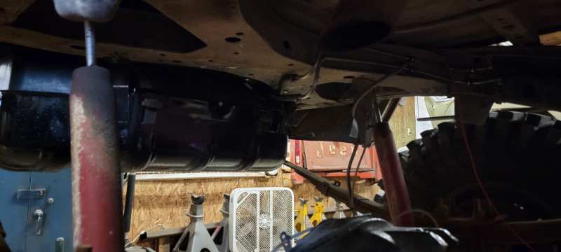

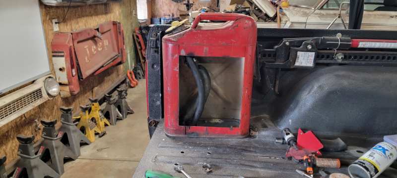

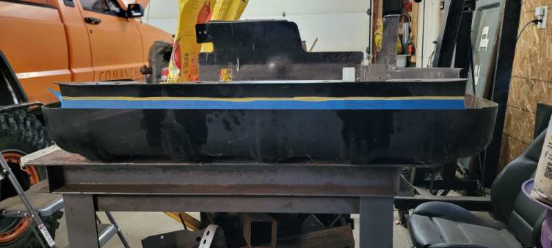

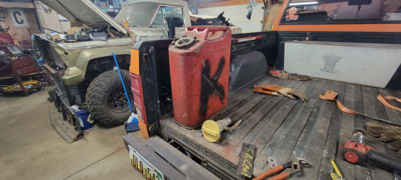

ThatJeepGuy Posted April 14, 2025 Author Share Posted April 14, 2025 More TJ tank progress Modified the rear mounting setup and then leveled the tank. Made some simple brackets that secure the front of the skid plate to the exposed 1" lip of the unibody X brace. Then came the fuel filler setup. One of my old jerry cans and the gift that keeps on giving - Tan MJ parts! Old style fuel filler cap to boot! After plasma cutting out the threads from the jerry can cap I bolted the filler from the inside to the can. Next was getting the fuel to go from the bed and into the fuel tank. A custpm steel elbow is in order. Some leftover chunk of 1.5" hrew tube and some cuts with the grinder. Then we sprinkle the fluxore welds into place And spiffy it up some - good enough for me Little access hole which avoids the leaf spring mount, rear bed mount and also the mounting setup for the rear bumper brackets Some salvaged radiator hose will do for the time being until the new fuel filler hose shows up And that's all for the weekend folks! Tune in next week and see where I wind up with either finding an 05-06 TJ fuel sending unit assy to drop in OR try to be crafty and adapt an Areomotive fuel pump to my current 04 and older sending unit. Link to comment Share on other sites More sharing options...

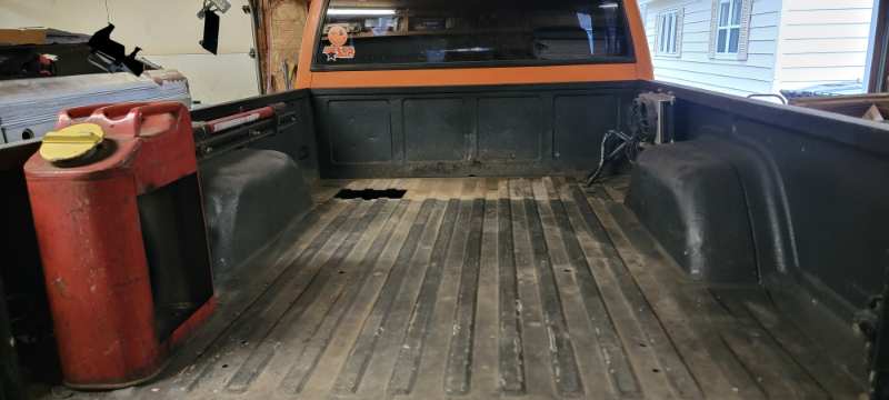

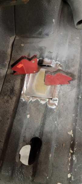

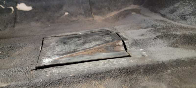

ThatJeepGuy Posted April 21, 2025 Author Share Posted April 21, 2025 Jerry can fuel filler wasn't going to mount level with the bed thanks to this raised section for the frame so I notched it and welded in a donated piece of tan MJ hood Link to comment Share on other sites More sharing options...

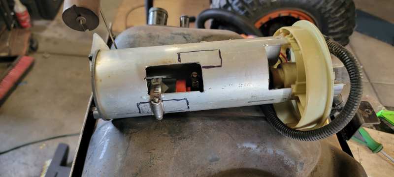

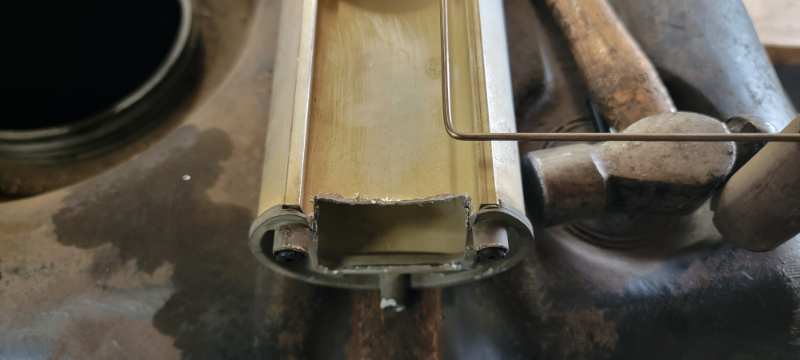

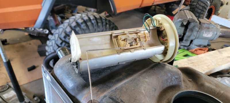

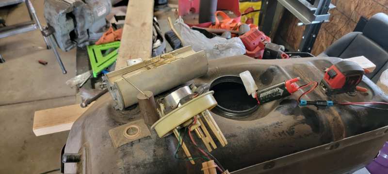

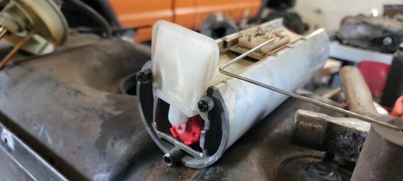

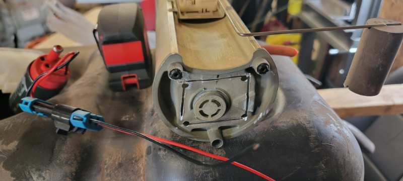

ThatJeepGuy Posted April 21, 2025 Author Share Posted April 21, 2025 Next came the fuel sending unit. This ended up not being nearly as complicated as I had thought... I had previously modified the sending unit top section by removing the factory pressure regulator and then drilling out the center to make room for this Gforce V2 regulator bypass setup. Also pictured is the aeromotive 340 series pump. To utilize the areo fuel pickup sock I had to make some extra room at the bottom of the sending unit body It's a squeeze but it's sitting nicely With a few access holes cut this assembly came together nicely! Link to comment Share on other sites More sharing options...

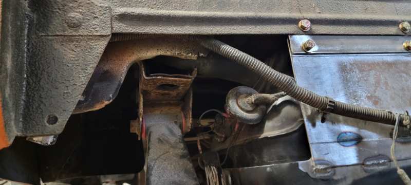

ThatJeepGuy Posted April 21, 2025 Author Share Posted April 21, 2025 Lastly came the final install and plumbing of everything! Fuel filler jerry setup, still need to affix the cutout section as an access door. Plan to store a bottle jack and small tool set for removing lug nuts - the bare essentials. Tank installed and filler hose connected I've kept all the stainless fuel lines from all of my part-outs over the years soo a pair of these factory MJ fuel lines worked out nicely for running the fuel from sender under the frame to the frame rail, soft line from there forward for the time being. Now you see me... And now you don't... but you do see the big hole that was made for the send/return lines - Yuck! Thats all for this weekend, there is a bit of cleanup in order because my garage is a disaster from this little project but we're not done yet, more to come! Link to comment Share on other sites More sharing options...
