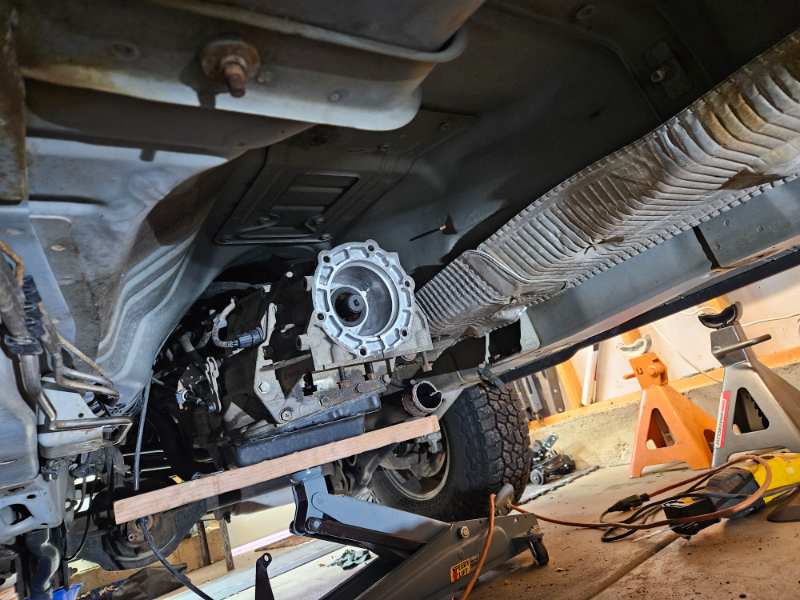

Also I went ahead and ditched the silly 247 t case in there in favor of the 242HD. By doing so I get 2wd vs all time 4wd. Also I get to add in a lunchbox to the rear. Freshed up the 5454rfe with new fluid and a filter.

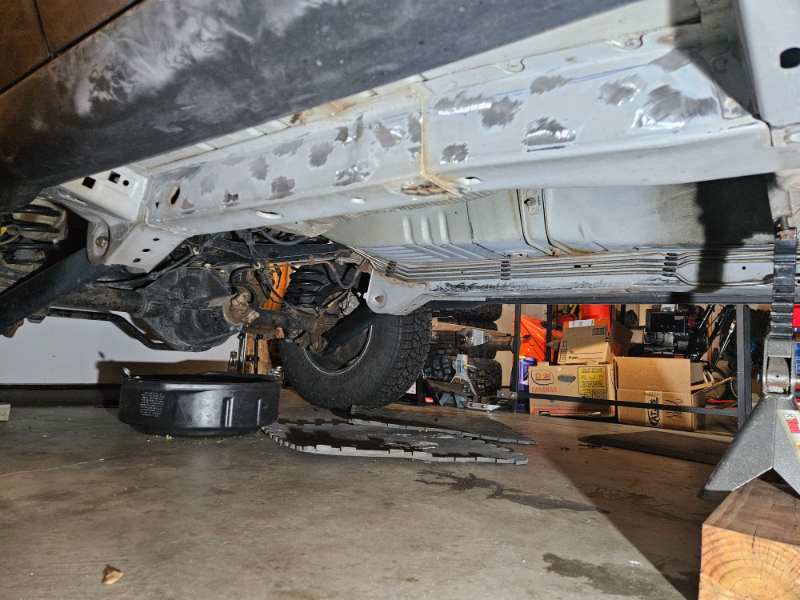

Next was freshening up the underside. I am going to be running a 3" IRO lift along with Bilstiens 5100's, extended sway bar links, ADDCO rear sway bar and some other things.
Go figure the coil buckets were toast.....waiting on my IRO replacement kit to finish up the front
I also replaced all the control arms, here's the rear. That a arm was a b*@ch to get out. Ended up having to cut the upper ball joint off as it had seized to the a arm.
Replaced all the brakes; calipers, rotors, pads and lines.

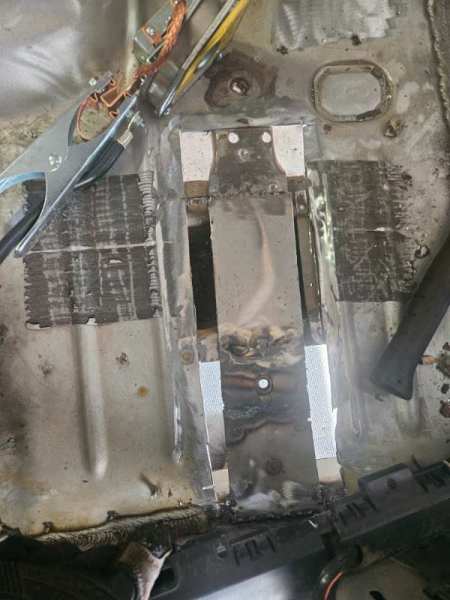

Fixed the coil buckets. Used the IRO kit. Worked well and didn't take to long to weld it all in.
Here's cleaning up the old area. had to grind down the old bucket as much as possible
Welded the new buckets together. This is the first project I've actually welded on. I've messed a round a little in the past but not actually throwing beads down.  Some beads came out really good others looked like, well.... $h!t
Still learning but I totally dig welding. Need to figure out why I got some splatter
New bucket mounted ready to burn in

Hey, since I'm welder and work for living, by the way it isnt spatter on the top where it look like bubble bunch of hole it called porosity cause by few thing, not enough gas flow, u weld too far, ur nozzle too dirty, too much grease on metal need to be clean real good, too much air flow for example windy outside? Did u set fan air flow forward to u?, or did u run low on gas? The bottom one ur weld look good, properly way on how u move ur welding look great. Keep on practice. :L:

Right on, thanks for the info and terminology correction. I was welding outside and it was a little breezy so I'm assuming it blew away the shielding gas. Guessing the lower turned out better because it had the top of the bucket to help block any wind. Next time I'll put up a shield or something to block any direct airflow.
