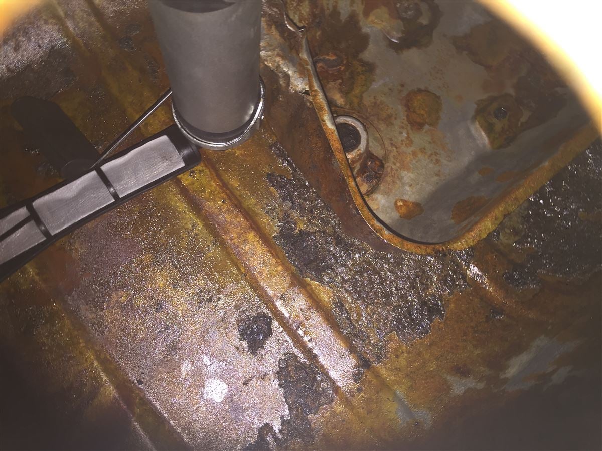

johnj92131 Posted January 3, 2018 Share Posted January 3, 2018 3 hours ago, Kickin’Chicken said: Can you explain the '97+ swap? I at least want to make an informed decision on which way to go. My tank was full of rust flakes and gunk. I'm thinking seriously about modifying the bottom of the tank so it will work with a Cherokee sending unit. But if the '97+swap is a more overall beneficial modification, I may as well tackle that while I'm flopping around with this tank. If your fuel tank is rusty, why not just replace it with a new Comanche tank? Lots of them on Ebay for about $100. Then get your existing fuel sender repaired/rebuilt. Seem like the easiest solution from my point of view. Link to comment Share on other sites More sharing options...
Kickin’Chicken Posted January 3, 2018 Author Share Posted January 3, 2018 1 hour ago, johnj92131 said: If your fuel tank is rusty, why not just replace it with a new Comanche tank? Lots of them on Ebay for about $100. Then get your existing fuel sender repaired/rebuilt. Seem like the easiest solution from my point of view. Agreed. I'm gonna order a new tank from Amazon. Then I'm gonna try to make a stock Cherokee sending unit work by either modifying the tank or cutting the sending unit and adding length to it with fuel line extension. I will take pics and start a new thread if I'm successful. Link to comment Share on other sites More sharing options...

Kickin’Chicken Posted January 6, 2018 Author Share Posted January 6, 2018 Decided to clean this one. I pored two gallons of muriatic acid in the tank and soaked it over night. Then pressure washed it. It's really clean now. Next I'm gonna modify the Cherokee sending unit to fit in my tank. Then I'm gonna seal the tank with "something"..... Any suggestions would be appreciated. Link to comment Share on other sites More sharing options...

Green Mesa XJ Posted January 6, 2018 Share Posted January 6, 2018 Muriatuc acid? How did you clean/neutralize the acid? It will eat all the rust in a tank then creat more if it’s not sealed off.I may be completely wrong on this. I know it’s a old school trick, I also know muriatic acid like to eat and eat causing a worst problem in some cases. Sent from my iPhone using Tapatalk Pro Link to comment Share on other sites More sharing options...
Kickin’Chicken Posted January 7, 2018 Author Share Posted January 7, 2018 On 1/6/2018 at 11:54 AM, Green Mesa XJ said: Muriatuc acid? How did you clean/neutralize the acid? It will eat all the rust in a tank then creat more if it’s not sealed off. I may be completely wrong on this. I know it’s a old school trick, I also know muriatic acid like to eat and eat causing a worst problem in some cases. Sent from my iPhone using Tapatalk Pro Washed it out with water. Cleaned most of the gunk out. I then decided to beat the heck out of the baffle till a Cherokee sending unit would fit in there (somehow or another.) This is an old tank so why not experiment with it till I decide on a permanent fix? Anyway this is what the new sending unit looked like after I "modified" the tank: Link to comment Share on other sites More sharing options...
