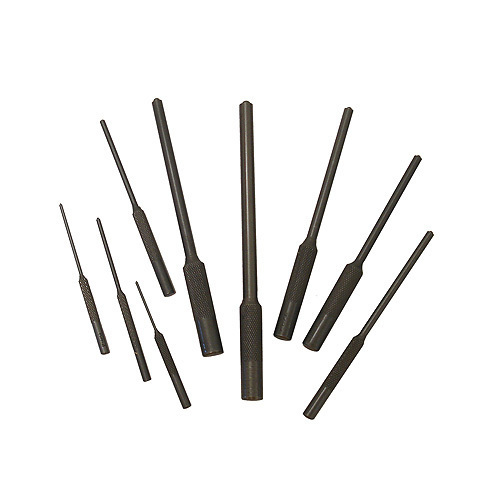

HOrnbrod Posted March 26, 2015 Posted March 26, 2015 Part number is 55000765. You can get it HERE. It's a split rolled pin, heat and drive out from the bottom using the correct size drift punch and a BFH.
Dillithium Posted March 26, 2015 Posted March 26, 2015 When I swapped my doors I used a hammer and a drift punch, no heat. But my jeep came from California, so you may need heat as Hornbrod suggested.

Jeep Driver Posted March 31, 2015 Posted March 31, 2015 Take a cheap air hammer bit, cut the end off so you have a blunt hammer bit. Use rubber hose to connect the bit to the hammer end of the punch. Use the air hammer to loosen or drive the pin out......short burps. You'd be surprised with a small amount of vibration will do to stuck pin.....ball joints.......etc... You'll have to hold the punch and bit together with your hand....all the fuel hose will do is keep the bit from running off the punch.
