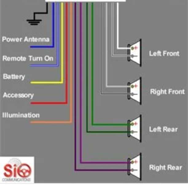

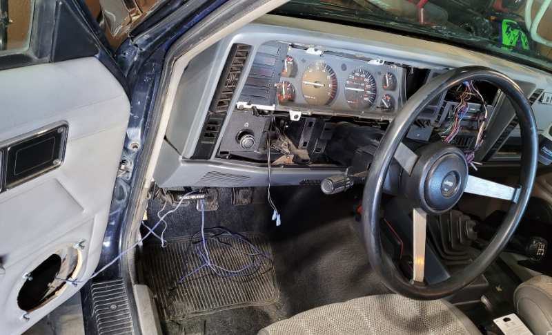

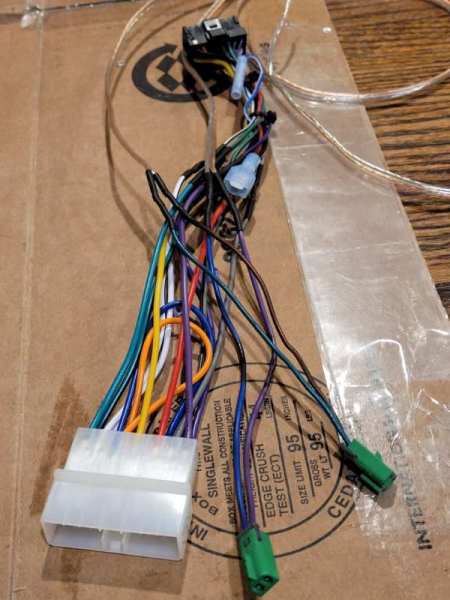

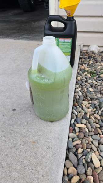

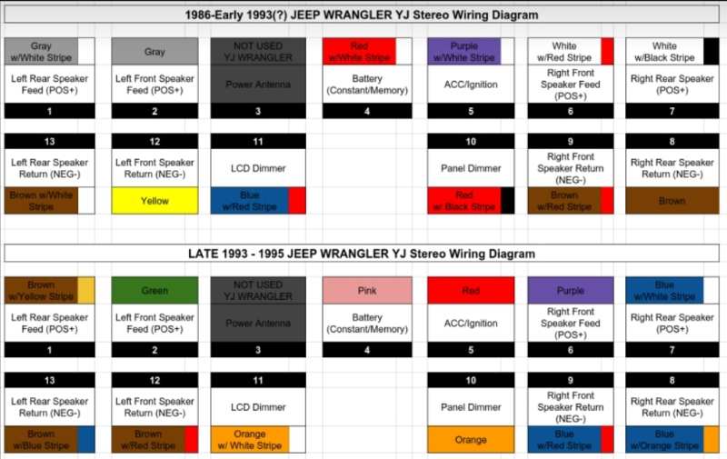

COMJNUT Posted April 26 Author Share Posted April 26 Looks like an update is in order. It's not a daily anymore, just goes to car shows and meets now. Trying to keep it in as good of shape as possible. I became a member of a two local clubs and have been on many outings with them. One was a show & shine for 4x4's, and I received an award that was imagined by regionally well-known artist Jeff Bates. Since I'm not driving it regularly, I have found that I have not been keeping up on regular fluid changes. The last time I have in my books that the coolant was changed was in 2018, so I changed it this past February...it still looked ok. I'm going to change out all of the other fluids also (brake, front & rear differentials, transmission, and transfer case) here in the next month. In February of 2021, I had to replace the wiring on my stereo. The previous owner installed low quality wiring to the front speakers instead of using the existing factory wiring which tested good and is still working to this day. I've attached some wiring pinouts that assisted me though the project. Many more adventures to come. Link to comment Share on other sites More sharing options...

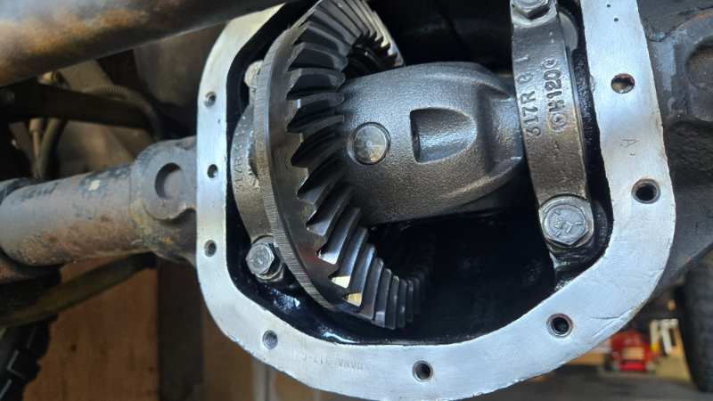

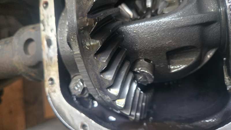

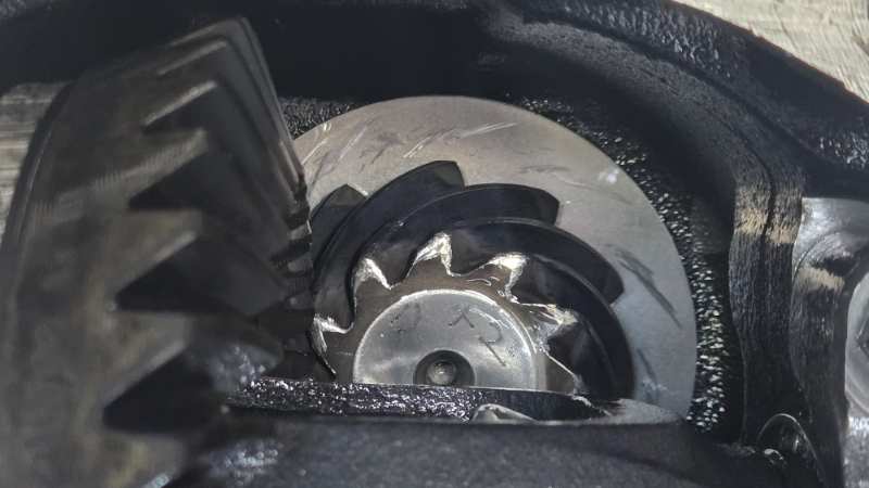

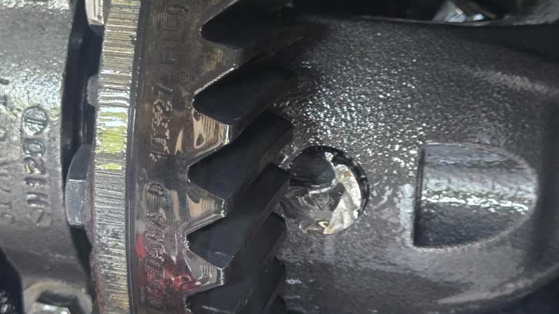

COMJNUT Posted May 3 Author Share Posted May 3 The saga continues... Went to change the fluids in the differentials, transmission and transfer case. I found the front differential to have damage. Repairs will be underway shortly. Link to comment Share on other sites More sharing options...

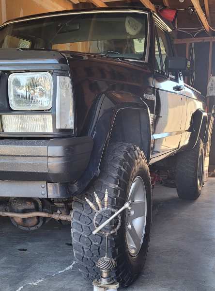

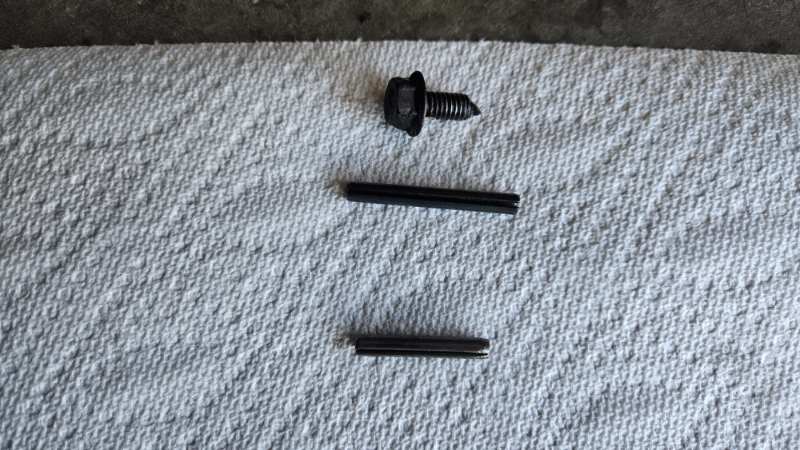

COMJNUT Posted May 15 Author Share Posted May 15 I have a personal motto "learn something new every day". I ordered a new roll pin for the front dana 30. While I was cleaning up the front dana 30 for the arrival of the new pin, I had found the old pin. I thought to myself, why not, I can have it back together sooner rather than later. I got the old pin back in, sealed it up, added fluid, and was proud of my work. The new pin arrived, I opened the bag and my heart sank, it was 3/4" longer than the old pin. I thought to myself, maybe thats why the old pin fell out. I took it back apart, removed the old pin, installed the new pin. That extra 3/4" was the difference between a recurring failure and a success. Driving the last 1/2" of the new pin was a little tougher than the old pin and will make a huge difference in keeping the pin in the carrier. Lesson learned. Link to comment Share on other sites More sharing options...
Salvagedcircuit Posted May 16 Share Posted May 16 On 5/15/2026 at 5:50 PM, COMJNUT said: The new pin arrived, I opened the bag and my heart sank, it was 3/4" longer than the old pin Same thing just happened with my anderson front screen door handle. 1/8in of the roll pin sheared off and caused the handle to wobble. just needed a new roll pin. She'll be right! Link to comment Share on other sites More sharing options...
