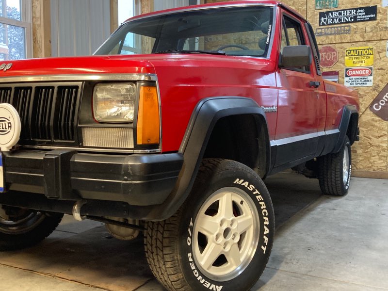

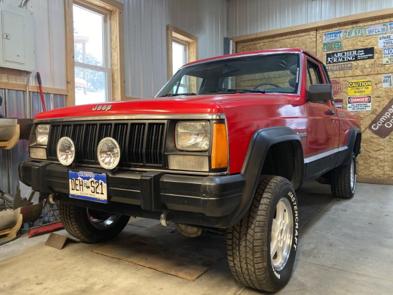

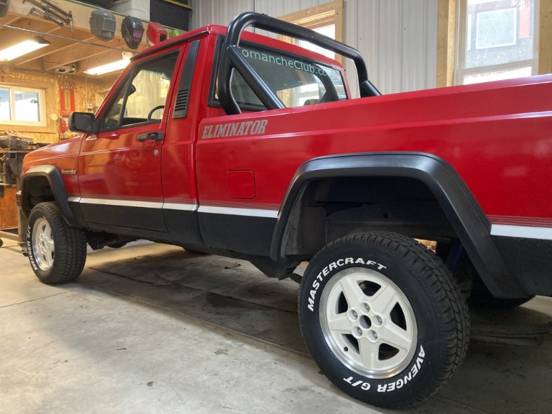

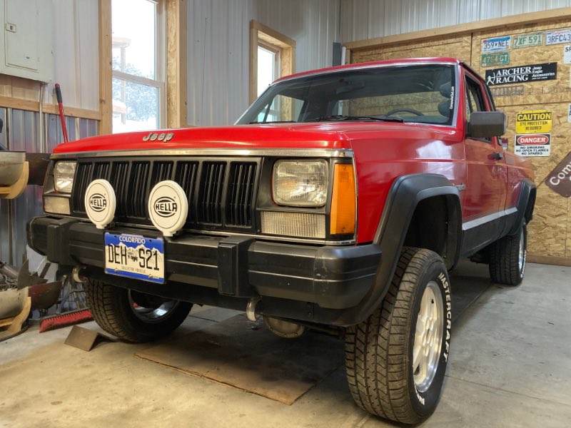

FOR REAL THIS TIME!!!... without the runs. I'm super excited how it turned out... I literally just got done painting so I'll let it all settle down and go out a snap some pictures. :rock on:
Bear with me... the flash on the camera kinda messes with the actual color of the truck. The red of the over spray on the floor matches what the truck really looks like. Next is to paint my silver stripe to match the factory decal kit I have, add some bed liner from the lowest body line down, clean up my shop, and start putting this little truck back together!
