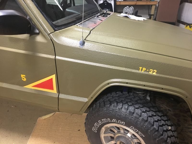

  22. Ok, got the body coated with Monstaliner. Just sat the bed back on the frame for this picture. Coating came out great, I am well pleased.

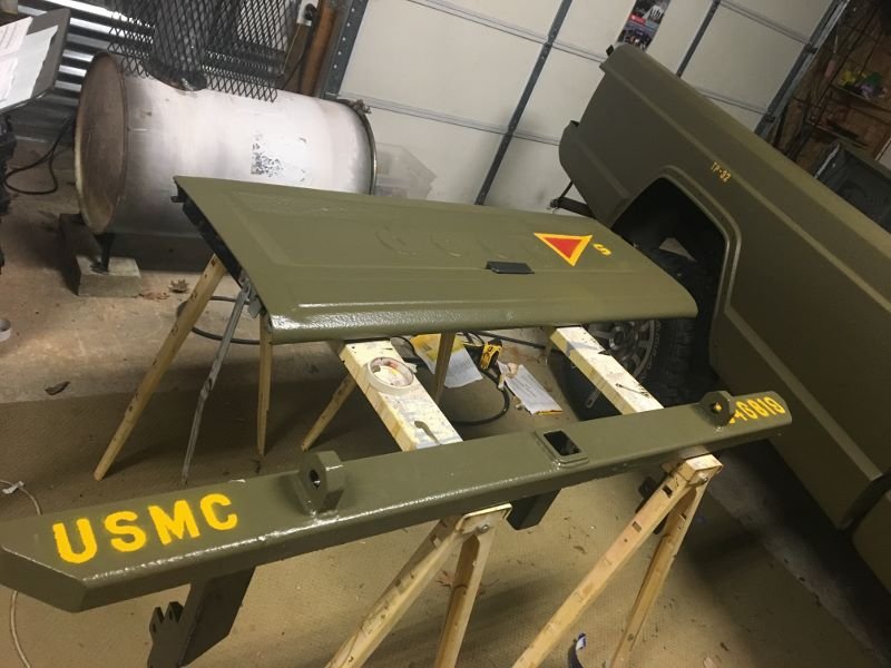

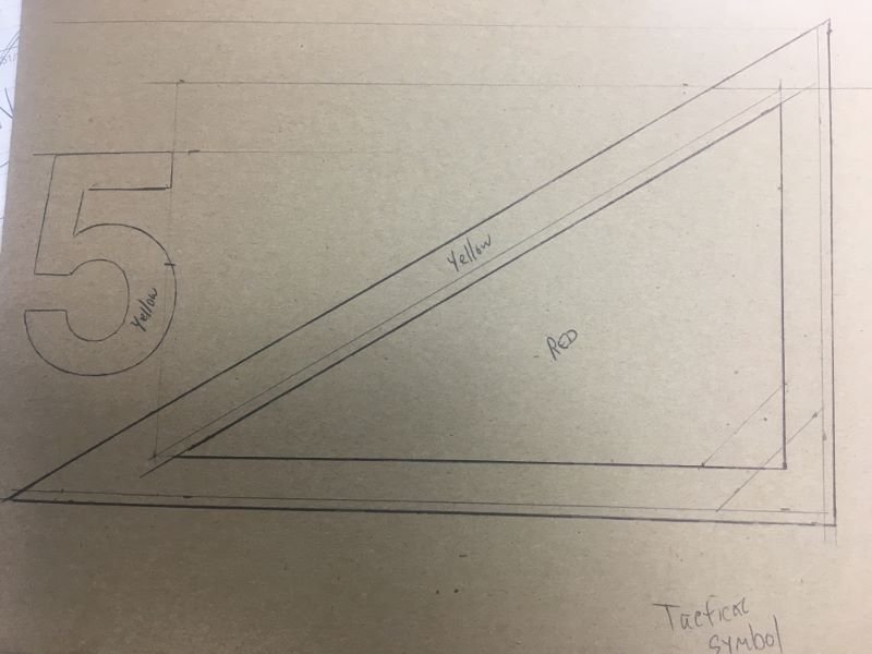

  23. Playing around with stencil ideas today. Here's what I have in mind. USMC & Lettering (letters from my actual VIN) on both bumpers. Unit tac symbol on tailgate and again on front quarters (or possibly doors). And you know where the TP-25 goes of course. All in yellow, with tac symbol center filled in red. Letter sizing in 3" with TP-25 at 1-1/2". I used some decals I had laying around and free-handed the symbol. I got some exacto knife work to do now. I was a 3rd Surveillance Reconnaissance Intelligence Group (SRIG) guy for a while, hence the shout out to my 5th Force Recon brothers with their tactical symbol. Accuracy? Likely not so much, but it's a hellavalot of fun.
  24. I bought the Monstaliner roll-on kit. Comes with textured rollers. I did this in my garage rehearsal studio so spraying was not an option. Two gallon kit and I had plenty. I did not do my bed interior, as I want to do that later perhaps in black. I don't think I could had pulled off the body and the bed interior with 2 gallons, but it would've been very close. Probably 1-1/2 gallons to do absolutely everything. .
  25. I didn't have that concern, as I rolled Monstaliner. All in all, I am pleased with the texture and finish. There were a few very tiny, hardened bubbles mostly on top of the cab where one can't easily see them anyhow.
