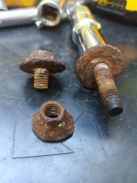

Pete M Posted October 7 Posted October 7 any tips? only one is still a 13mm. the other 2 are rotted. there's no way I'm the first to deal with this. I assume I'll need to drill them out but am open to other ideas. not a lot of access in there for that back one
89 MJ Posted October 7 Posted October 7 I've had good luck pounding a slightly smaller 6 point socket over the rust bolts and getting them out.
Pete M Posted October 7 Author Posted October 7 I went with the hammer-a-socket method and was successful got the nut off with a 10mm socket (pretty sure it used to be 13mm ) snapped the one using a standard socket got the other whole one out using a 12mm now I need to find my extractor set and see if I can remove the snapped bit out from the bottom
89 MJ Posted October 7 Posted October 7 39 minutes ago, Pete M said: I went with the hammer-a-socket method and was successful got the nut off with a 10mm socket (pretty sure it used to be 13mm ) snapped the one using a standard socket got the other whole one out using a 12mm now I need to find my extractor set and see if I can remove the snapped bit out from the bottom The method is a bit crude and you feel bad pound a socket on, but it does provide pretty good results. Crazy that you had to go down to a 10mm!
