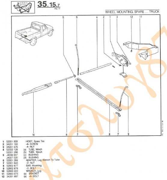

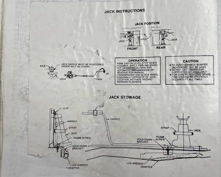

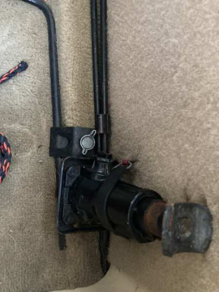

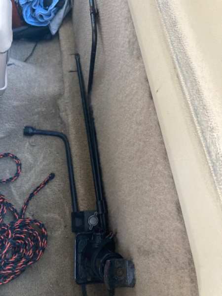

90BlackMJ Posted 3 hours ago Posted 3 hours ago Could someone please share some details on how the parts a pieces of the jack assembly is mounted behind the seat? both my trucks came with the components missing, so I don’t have anything to reference when putting my 92 back together. thanks!

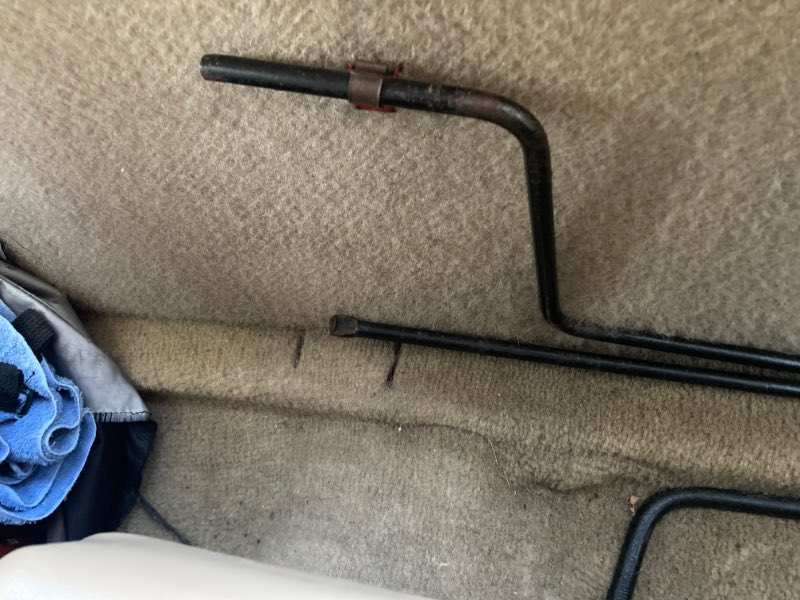

fiatslug87 Posted 3 hours ago Posted 3 hours ago If you need the clip that fits in the back panel you can get one here eBay Link

MagicJames Posted 1 hour ago Posted 1 hour ago 1 hour ago, fiatslug87 said: If you need the clip that fits in the back panel you can get one here eBay Link Can I ask you, Is that the correct tire iron, or is it that sillly fold out one? or did they change them through the years
fiatslug87 Posted 1 hour ago Posted 1 hour ago The tire iron is solid and correct for 88-92 maybe 87 also. In 86 it was the foldable one with a piece you insert into it to lower the spare.
