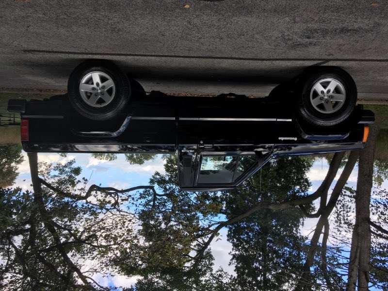

MJ 4.0 Posted yesterday at 04:14 PM Posted yesterday at 04:14 PM I have an 88' Comanche. My steering column, (right where it pivots at the tilt wheel), is loose. I can move it left to right about an inch or so. Also, when I do this with it running it cuts out my bluetooth audio I have plugged into the lighter. Also, I've noticed over the past few months, If I hit a bump on the road, the engine seems to fall on its face, but then immediately picks back up. This seems to random and doesn't happen all the time. I'm thinking I got a ground short or an ignition wiring shorting out inside the steering column. I'm not that mechanically inclined so I'll have to rely on a local mechanic to fix it. Can this loose steering column be fixed or will I have to replace the entire column? If so, will the Cherokee columns fit in the Comanches? Mine is maroon in color so may be difficult to find. Thanks for any insight. LB

jodawill Posted 6 hours ago Posted 6 hours ago You don't need to buy the steering wheel puller or the wheel lock remover. You can borrow them from an auto parts store for free. They come in the same kit. Anyway, I see your problem. Your truck is upside down.
