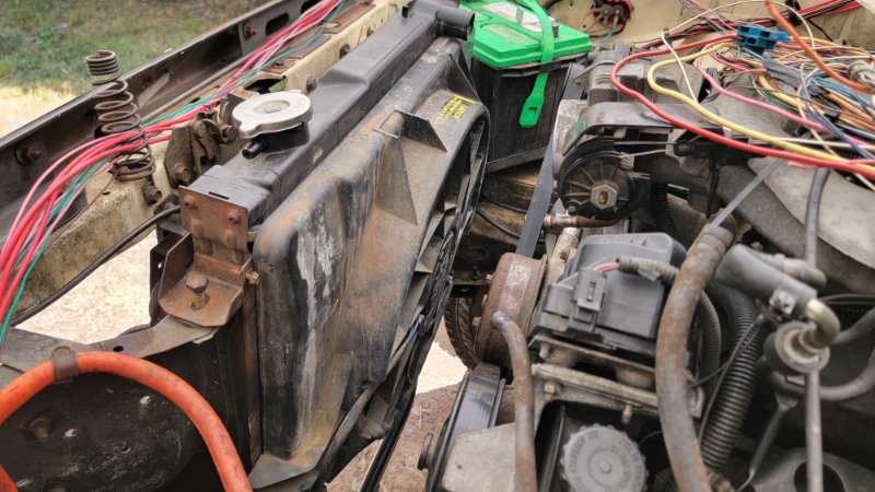

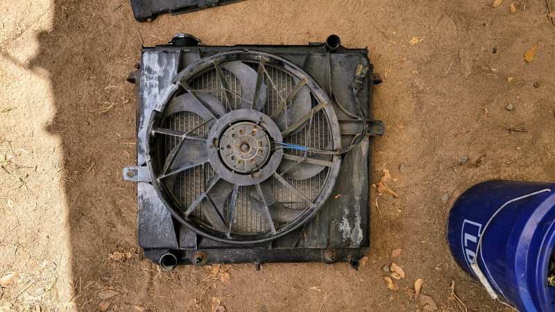

NickyV Posted June 4 Posted June 4 (edited) Is there a way to get more radiator clearance for the mechanical fan in a Renix 2.5L (1987)? I’m asking because I am working on putting A/C in and I want to add an electric fan while keeping the mechanical fan. I have also considered creating a custom bracket for my radiator to adjust the spacing. I will be running standard size radiator and condenser… matter of fact, the condenser might actually be a bit thinner than OEM. I was hoping to use a salvaged e-fan pulled out of a 4.0. But I picked it up from a local Pick-N-Pull on impulse, without measuring or calculating. So far, I have only eyeballed the space under the hood by holding up the various parts, and I can tell it will be tight. I think I can use the 4.0’s e-fan as either a push or pull (just need to flip the polarity, right?) But I am worried the fan might be too tall/wide to fit as a push, and that if I use it as a pull, it will be ridiculous close to the mechanical fan. One idea I had and am trying to research is if there is a water pump housing that has a slightly lower profile? That could potentially buy me a fraction of an inch? Based on pictures, it appears that the FlowKooler housings might have a slightly slimmer profile so that the mechanical fan wouldn’t stick out quite so much. And maybe I could combine that with a slightly lower profile fan clutch? [Correction: FlowKooler housings actually look a bit wider... but there are some manufacturers with slimmer profiles.] Anybody have any insight into this? Edited June 4 by NickyV Correction
eaglescout526 Posted June 4 Posted June 4 The mechanical fan does pretty good with keeping both radiator and AC cool. I contemplated the same for the summers but there’s just no way to have a pusher electric and a mechanical puller and the only other way would be 4.0 radiator but that’s too much cooling for the 2.5L.
NickyV Posted June 4 Author Posted June 4 Thanks, @eaglescout526 I hear you loud and clear. But the thing is, I already went to the trouble to build my wiring harness so that it can activate an e-fan. There are e-fans out there that are quite small. I'm talking about 8-9 inch fans designed for transmission or oil coolers. I know they wouldn't provide nearly enough cooling on their own. But in addition to the mechanical fan, it seems like they could help, especially in stop and go traffic. Do you think that's just not worth the trouble, or do you foresee other issues with going this route?
eaglescout526 Posted June 4 Posted June 4 Makes sense. I went down this rabbit hole and I couldn’t find one that fits. Now if you want you cut out the middle support of the front radiator support you could squeeze in a fan. But I just couldn’t find a fan skinny enough to do what I want. And jamming a mechanical and an electrical together would be quite the sight and a challenge. Maybe what I would do is swap to an e fan and see how you like it. Supposedly 90’s Taurus fits and has two speeds and moves air pretty damn good. I could be wrong on this. I remember someone somewhere did this. Anyways with that you’ll free up HP be doing away with the mechanical. But mechanical is also reliable. For me I was only going to do such to help with the cooling capacity of the 134 that r already doesn’t get with the R12 style condenser. But given the tight spaces, I couldn’t bear to cut or jam it in. The 2.5 runs cool enough but if it ends up overheating, other issues probably are present.

coheed Posted June 4 Posted June 4 If you're interested in going only electric, the PT Cruiser fans fit the 2.5/2.8 radiators well with some trimming. Advertised as pulling up to 2400cfm on the high speed as well. This Bosch one I pulled from a junkyard cools my 3.4 swap very well, even when the 3.4 PCM was turning the fan on at 228°.
