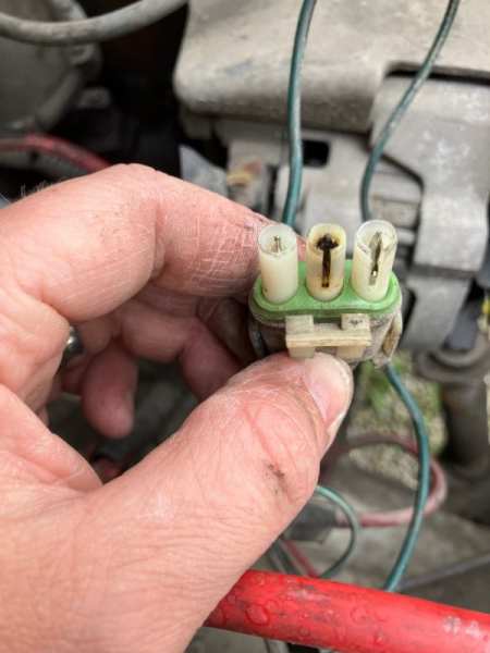

Porquer Posted April 19 Author Posted April 19 A few finds so far. the ground path for the IAT sensor has about 2.1 ohms of resistance. I suspect but have not confirmed that a lot of that resistance may be from the C101. I started unplugging, cleaning, and applying dielectric grease to every connector I can find under the hood. In doing so, I found that the ground pin for the ICM looks burnt. Are individual pins available for purchase? I tested the throttle closed switch at the diagnostic port with a volt meter. 0 volts at closed throttle, 5 volts when the throttle is open.
eaglescout526 Posted April 19 Posted April 19 You can get new terminals for that connector. They’re just weather pack terminals. Common GM connector of the era. I have witnessed the C101 do some damn weird things. It would always screw with my O2 sensor.
