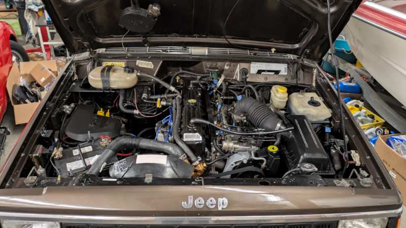

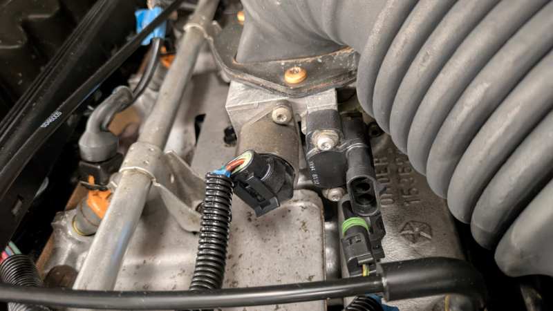

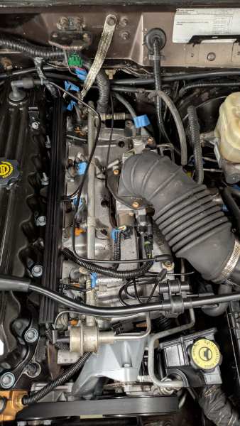

Gojira94 Posted Wednesday at 06:52 PM Share Posted Wednesday at 06:52 PM Looking at your pics - it appears you've got most of what you need there. That looks like the Renix fuel rail and throttle body, both just kind of sitting there. Eagle_SX4 is spot on, you'll need to adapt the Renix TB and linkages to the HO intake and make a way to secure the fuel rail. The Renix fuel pressure regulator will have you at the right pressure. Those injectors look like 33007127, from a 91-93 HO, not the 53030778 grey tops that would have come on a 96 engine. Also looks like you already have a temp sender or fan switch in the thermostat housing, which is it? EDIT - forgot to mention that you'll need a Renix distributor, the HO one won't work due to the CPS to sync sensor signal incompatibility. That begs the question of what transmission is behind this engine you've swapped as well. An AX15 will need a Renix flywheel, AW4 will need a Renix flexplate. Link to comment Share on other sites More sharing options...
