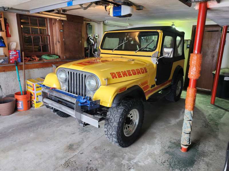

robfg67 Posted March 7 Posted March 7 Any ideas on what to check for? As stated, it only smells when tank is filled. There are no leaks/drips. No smell at all when tank is below full.
eaglescout526 Posted March 7 Posted March 7 Does the area around the sending unit look wet? My XJ kinda does the same.
llhat Posted March 8 Posted March 8 could be as eaglescout suggest, takes only a gallon or few to get below sender access hole... recently went through this a few months ago on a NEW sender the O ring had deteriorated within months of new install... changed o-ring vendor and 'so far' OK other area are the two vapor line access on TOP of the tank... there's a valve up there connected to two vacuum lines leading to charcoal canister under hood. the lines could be rotten or have dislodged. the valves are retained with a rubber grommet also... you say no drips, that is also good... and bad for diagnosis check fuel fill also on fender side of tank.
robfg67 Posted April 19 Author Posted April 19 Sorry for the delay on this. I've had my hands full with another Jeep that I picked up recently. I couldn't find any issues with the lines at the top of tank. My plan is to slightly overfill it and look again.
